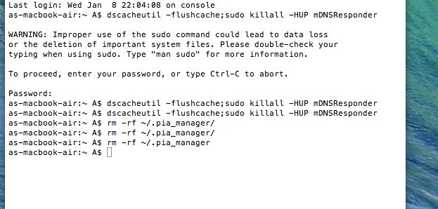

hey thanks for the reply and everyone else too.
This is what I have done the above and this is what terminal shows, as attached image. re-installed the client first before I did the above, because I had moved it to trash can before.
See if this looks normal, if you don't mind:
