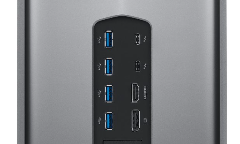

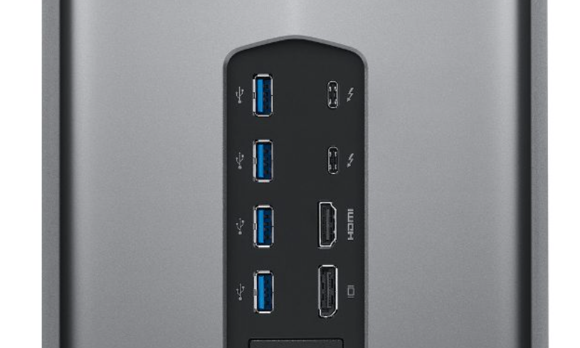

I am very interested in this question as well. One thing I am wondering about this is the difference between available eGPU solutions. (Sonnet, Akitio, BM,..) The new Blackmagic eGPU Pro version (Vega56) has one additional connector on it's back, - a new Display port 1.4.
Does this offer new options, what is changing with a Display port compared to the older 580 version?

https://www.blackmagicdesign.com/products/blackmagicegpu/
That's what interests me is a connection from the Display Port 1.4 to a Non-Thunderbolt computer that is however equipped with a Display port 1.4. Would this be possible? Otherwise, I am not clear on the question what the new port is for, compared to the 580 model that does not have this port.
Regardless, I think its a very interesting product. I would love to hear more about this from people that got one of those.
