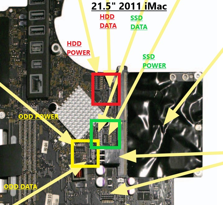

On both 2011 iMacs, the SATA speed of the hard drive is 6Gbps and the optical drive speed is 3Gbps so there may be a slower speed on an SSD installed in the optical drive position.
Why dont you just use the extra 6Gbps SATA port.
A few $ for some cables (power splitter /SATA data) and double sided tape.
It's what I do and once the screen is on it looks pretty 😉
