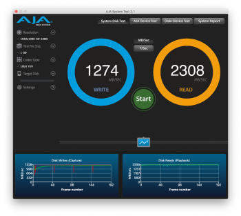

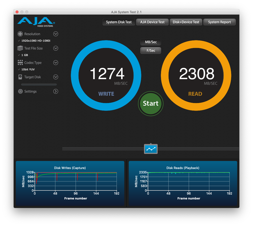

  7. I used AJA to measure the i/o speeds to/from the Envoy and was very pleased. See attachment.

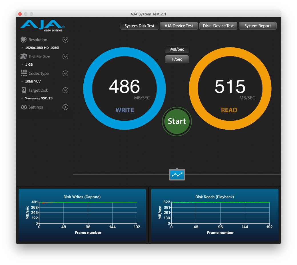

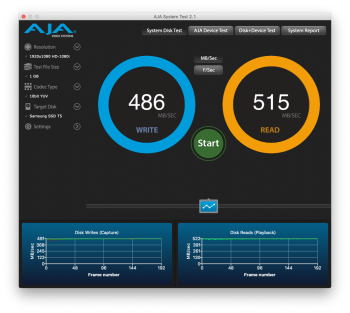

I like the OWC Envoy Pro EX as it runs much faster (see i/o test results attached) than my Samsung T5 500GB unit and is more useful being 1TB in size. The Samsung T5 can be used directly in any of the MP7,1's TB3 ports which is nice and a decent alternative to having extra cables that the Dock+Envoy combo requires.
