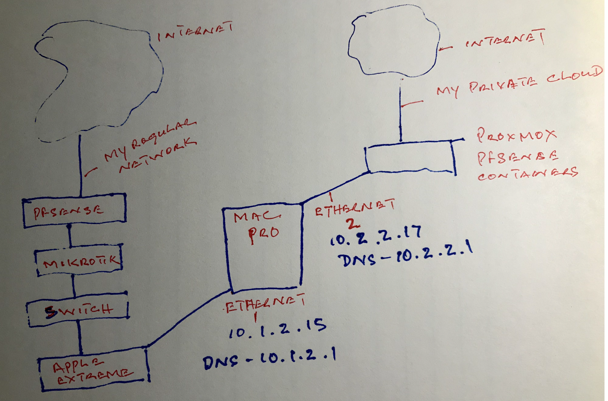

Folks, this primitive drawing diagram is what I am aiming for with Ether1 and Ether2 each have their own default gateway and DNS. I will need to wait for a new modem to arrived, hopefully next week, because I tried yesterday giving Ether2 a manual IP with DCHP which stated connected but didn't get default gateway nor DNS. That's because the private cloud interface was down as there was no Internet. Note that both networks are at the same location.
That's a lot devices on the left side.
This can be done but I have not done it myself, and it requires modifying config files using text editors.
What needs to happen you will have to tell each application what interface it will need to use. At work (windows) we had this exact issue. Device is connected to separate networks and the application was using both and when it picked the incorrect one the task would fail. One the .ini was configured to only let the application used that one interface it worked like a charm.
I'm sure someone with more unix/linux experience can tell you how to accomplish this.
OK firstly, just saying but this is not really a Mac Pro issue. The setup you are aiming for could be achieved with any computer running macOS and any two network connections--be they ethernet, WiFi, bluetooth, VPNs, etc. So you might get a better response by posting your query here, which is the forum meant for networking questions.
But here is my advice anyway. I assume that you are communicating with everything on the right-side of your diagram via IP addresses on that 10.2.2.x LAN (i.e. all of those containers also have 10.2.2.x IPs). If this is the case then you should not set a default gateway on your Mac Pro for Ethernet 2 (however, those containers should be set up with a default gateway since they connect to the internet). Without a default gateway, macOS will treat that as a local only interface, which I believe is what you are wanting. You can still use a DNS server on that interface if you want to, but you must ensure that that it is translating to the internal IPs, not external IPs. You haven't detailed how you are accessing your private cloud--do you have a publicly routable domain name you are trying to use? If you need to use the same domain name internally and externally then you can set up what's called Split DNS. Alternately, in lieu of an internal DNS server you can just set up the hosts file on your Mac Pro to manually resolve whatever hostnames to the internal IPs.
Anyway, you should then set Ethernet 2 as the higher priority network. Any requests that resolve to IPs on 10.1.2.x or any other local or non-local subnet should be automatically sent to Ethernet 1 and out to its default gateway.
Setting this up "right" is non-trivial and involves a lot of planning and configuration--especially when DNS is involved.
I really do think you'd get a better response if you ask in the other forum. This forum is more meant for issues specific to the Mac Pro (which this question is not).

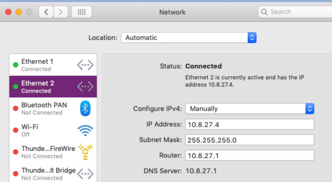

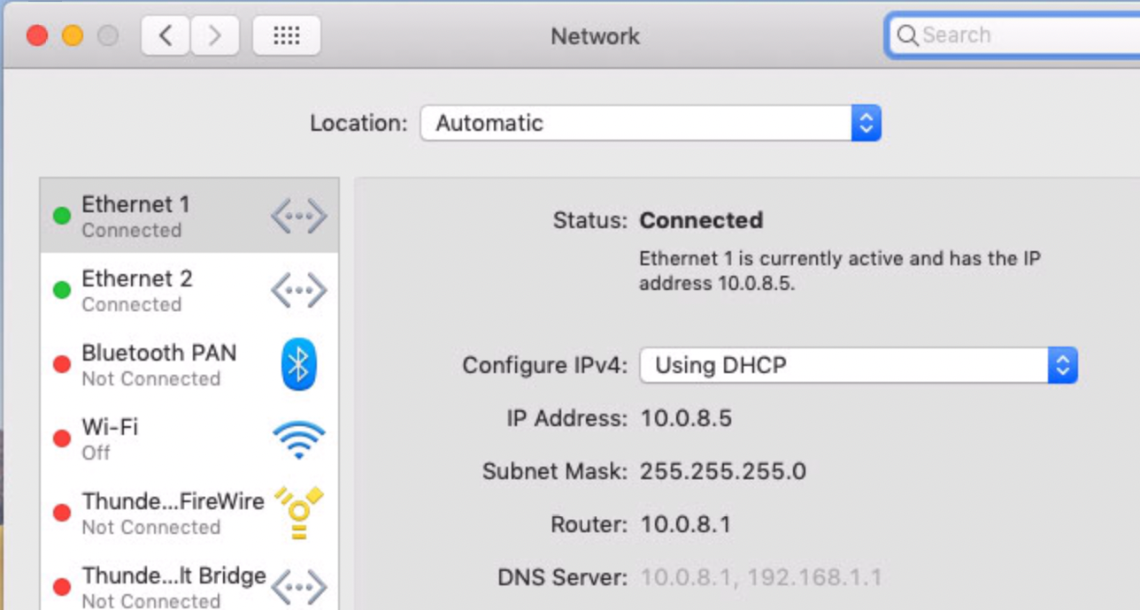

Thanks for asking...that's it...I am using pfSense and Mikrotik's built-in DNS server for Ethernet 1 and pfSense (different and separate from 1) for Ethernet 2 via Proxmox and pfSense VM...they both work simultaneously.
I'm am very, very interested in how that works.
If you attempt name resolution for xyz.com, how does your Mac choose which DNS server to use? The DNS query, since it hasn't yet resolved the IP address, doesn't know which interface will be used to reach that address. How does it choose the appropriate DNS server? Does it try both? Is there something on the Mac which tries all DNS servers, across all interfaces simultaneously and then chooses the first successful answer?
Does it try both?
No...it uses the one to which network it is attaches to...for example, if I open Firefox, and go to apple.com, it will use Ethernet 1 because that network has the highest priority. If I open another tab with Proxmox's address, it knows that's the other network on Ethernet 2. If I open another tab for Google, it will use Ethernet 1. Ethernet 2 DNS won't happen until I launch pfSense VM on Procmox and once up, if I make a DNS request, while in that network, that's when it get resolved. So, If I am on pfSense webGUI and click on a feed link, that will opens another tab on Firefox but use Ethernet 2 DNS to resolve the link's IP.
Thanks
I think I'm going to stay confused. Following a link in Firefox is roughly equivalent to entering that link by yourself into the URL bar of a new tab. "if I make a DNS request, while in that network" - that's the part I don't understand. I don't know what it means to be "in that network". Maybe it's something about some pfSense network architecture that is present on your Mac. I'm completely unfamiliar with that software.
No worries. I'm happy your situation is resolved.
Ethernet 1 network is 10.0.8.0/24 with DNS-10.0.8.1 and Ethernet 2 network is 10.8.27.0/24 with DNS-10.8.27.1
So, basic networking, if one is on network 10.8.27.0/24, there is no way DNS 10.0.8.1 would respond to a DNS request from 10.8.27.0/24 network, but an external DNS like Google (8.8.8.8) would if and only if configured to do so.
In my case, there are no EXTERNAL DNS...only internal DNS and only to each network's DNS server.
