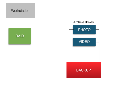

Thanks everyone for the feedback. I'll try to explain my situation a little more so maybe you could give me some more advice.
I am a photographer and filmmaker. I have about 2TB worth of data currently and will be creating more soon. My goals are:
1. To have redundancy of all my files.
2. Have a working drive which is fast enough to edit 2K footage off of and work with 1000s of RAW files at a time.
3. Do this for the most cost effective way but also (most importantly) make sure that I do not create a system that is outdated. (So no FW800) In a year or so I'll have a new workstation and I don't want to have to overhaul my data asset management again.
My current idea: was to have a working RAID TB drive which I would keep all my current projects on. Once I have finished a project, I would then transfer it to a HDD for archival purposes. That HDD would then be mirrored to a separate HDD for backup purposes.

Any thoughts? Not a huge fan of cloud backup even though it's cheap. My bandwidth has a hard time handling that much upload - it takes forever.
Several here use a similar work flow, a high performance TB RAID as working storage. Move projects off to less expensive USB drives for archive. Have a backup of everything. Your diagram is a flow, not a electrical connection.
You should include backup method for that working RAID unless you can afford to loose your working storage and somehow rebuild it later. RAID, although offering high performance and fault tolerant storage, is not the same as a backup. I use CCC to backup my working storage to mirrored storage (USB3), but I have less than 4TB of working files. If you need more working storage, it gets more complicated. Some pro apps may do this for you (backup the working files).

Thanks. So if I need to back up my working drive, is there much benefit in having a working drive be a RAID? Forgive my ignorance.. Always learning.

On the issue of RAID and backups, recall that RAID5 (for instance) is not a backup solution, it is a high availability solution. Most people would go cheap on the backup solution (big slow 4TB drives, for instance).
If you're on a budget, a common compromise is to run RAID0 for maximum performance on you big media files, but keep offline copies on backup disks. If you need fairly high performance, there is a BIG price step up between a simple RAID0 (two striped drives) and a RAID solution that will match the performance but add fault tolerance. Generally you need to either double the number of drives and run RAID1 (mirrored), so 4 drives instead of two, or get a fast hardware raid controller and buy (at least) three drives to run RAID5.

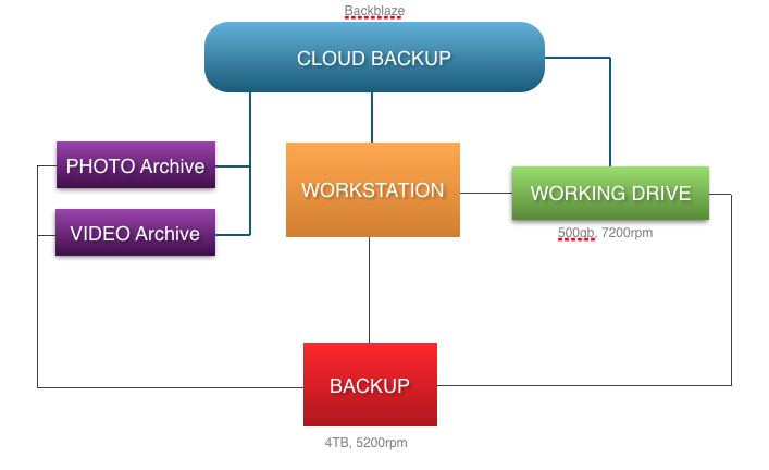

Thanks. Most likely I'll go with option 2 and just get a bunch of USB3 drives for backups.
Just to update this thread for anyone who may read this in the future: I ended up with the following solution due to my constrained budget:
- A few 1TB and 2TB drives for archive
- 4TB drive for backup
- 500gb bus-powered drive (I already had this) for working drive
- Backblaze
It's certainly not the slickest setup ever but it works and I have redundancy of my data. I had to sacrifice speed (for now) until I get a machine with USB3. Thunderbolt was just too pricey. All the drives I purchased from OWC all have USB3 so they'll be hopefully future proof for now.
Cheers
