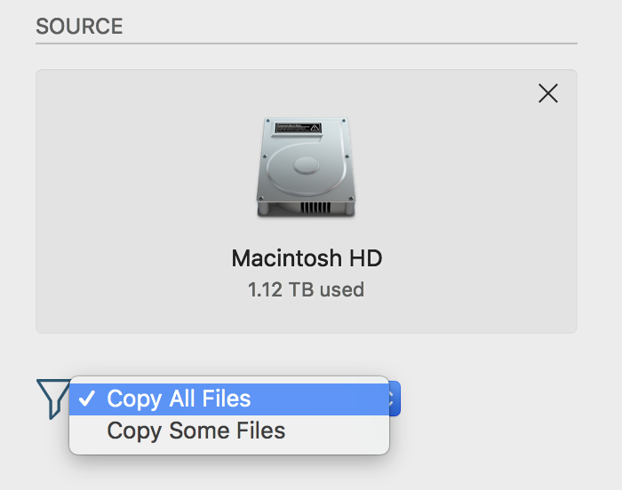

But, I believe that you can also back up non-bootable folders, although I have never done this.

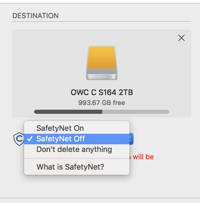

On the source side you have the option of choosing a full disk copy or just some files (folders). Not an option on the destination:
