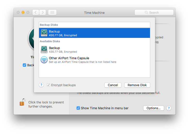

Yeah... you clicked the wrong option somewhere along the line there. Time Machine definitely does not require the external drive to be encrypted. There is an option to do that and it sounds like you checked that option.
You can see the option checkbox here on my Mac.

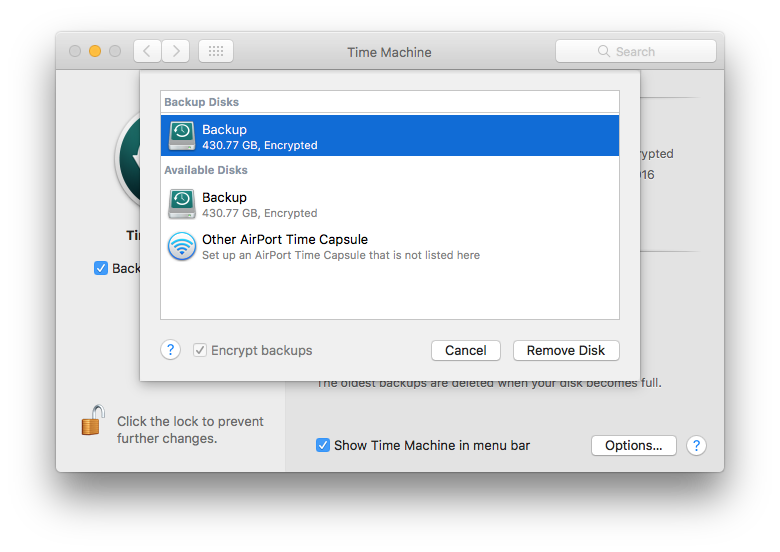

Yes, and when I selected a backup disc to use for the back up, it would start the countdown and when it reached 1 seconds it would have a window pop up saying that the "disc was not encrypted" (somewhere along those words not exactly) and would not continue.
