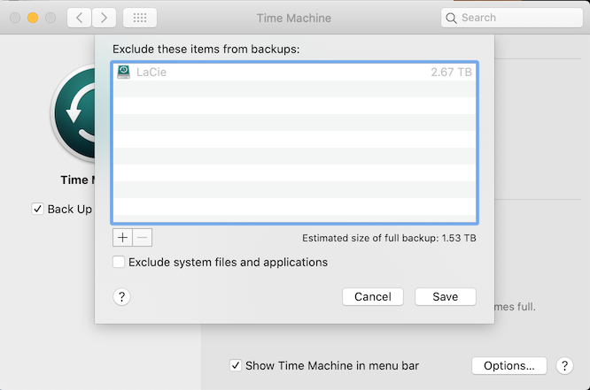

I am just checking you know that by default Time Machine excludes all external disks from backup unless you go into Time Machine preferences, click the options button, select the external drive and click the - button to remove it from the exclude list.
I have three external drives attached to my iMac - Only the time machine drive is excluded, I removed the exclusion for the other two drives.

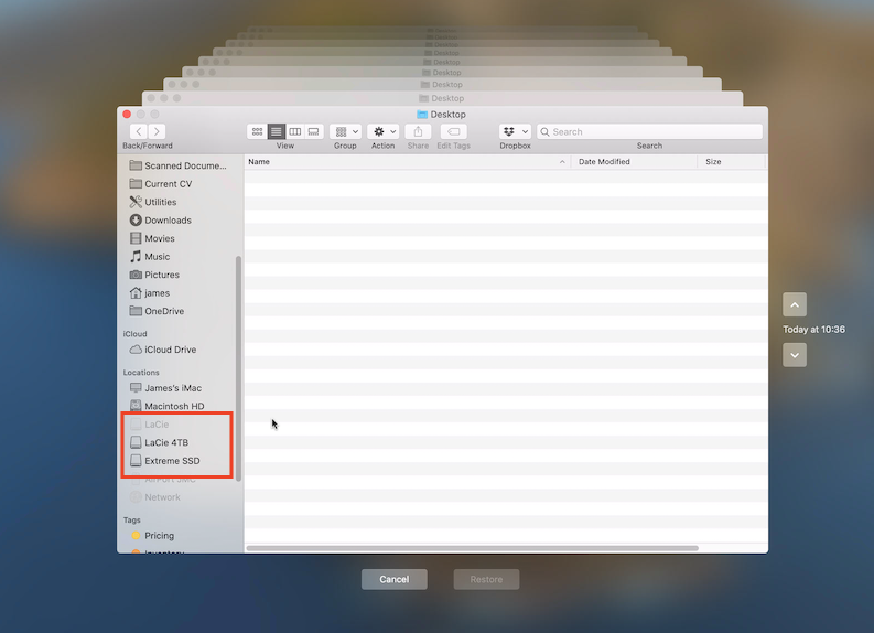

In the screenshot below you can see 3 external drives, the LaCie does not have a time machine backup, as it is excluded, but the two externals that are not greyed out Lacie 4TB and the SSD are backed up with Time Machine.
If you go back in Time Machine to your last backup, if you see your external drive is greyed out then it was not backed up.
