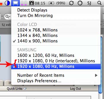

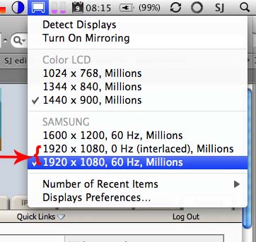

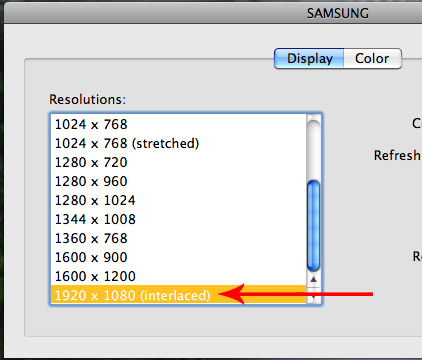

I'll show you.
The first screen capture below is the display preferences. Notice there is only the option for 1920x1080(interlaced) [1080i] and there is no option for 1920x1080? [1080p]
the 2nd capture is through the display icon on the menu bar, which you have to enable in the display preferences. Here I have two options: 1920x1080(interlaced - 0hz) and 1920x1080 (60hz)
selecting the 1920x1080 (60hz) option improved how the screen looked and the samsung is reporting it as 1080p, which is what I wanted because the text looked really bad at 1080i
Not saying you'll have the same problem, but just in case you do, You'll know the solution.
btw, I have a 37" samsung

sweet. thanks a lot for that last reply sal. i'm going to try that as soon as i get the chance.
