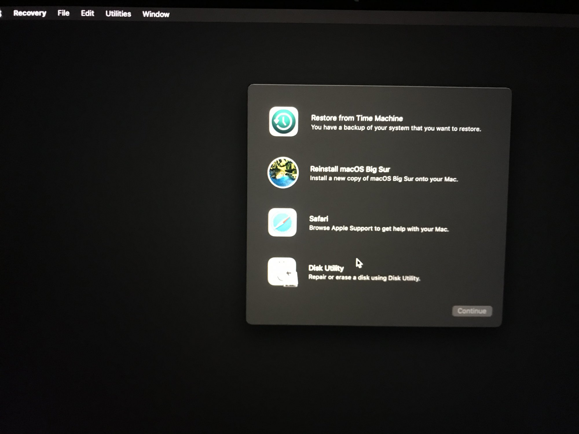

Thanks guys and apologies for the delay replying. So, did try to log in via internet recovery, used my old work account when prompted and got this screen. So, I guess that means that it would work, right? Also, there wouldn't be any log that the computer was used with an external drive or anything, right?
feel really awkward about this but the quarantine hotel thingy really messed up my plans...
I believe there should be a “Startup Disk” option in that menu. Since it’s not there I suspect you don’t have permission to start from other disks. Still, you won’t know for sure until you try it. As for logs? Unlikely but possible I suppose.
