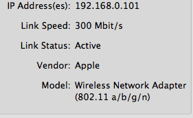

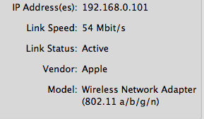

i dont get it, why cant i see why wireless N network?
mid 2007 MBP
do i have to turn anything specific on or something?
You should be able to.. go to apps > utilities > network util and check that your airport card is listed as 802.11 (abgn)
If N is not listed then you need the $2 update, but your computer should already be enabled.
Next, can you give us more info about the N networks you are trying to see? Is it one network you can't see or is it any? Is SSID turned on for the network? Is the router firmware up to date?
hmm, well, im closer to it now, and i can see it, i guess in my room where i usually am im too far away, its got like 3 brick walls to go through and about 40' of distance but here in the living room i can see it and i got 3-4 bars but im just on the other side of the wall of it, my wireless G AP is in the living room and there are only 2 walls and about 15' of space between them
so i guess that solves my problem
