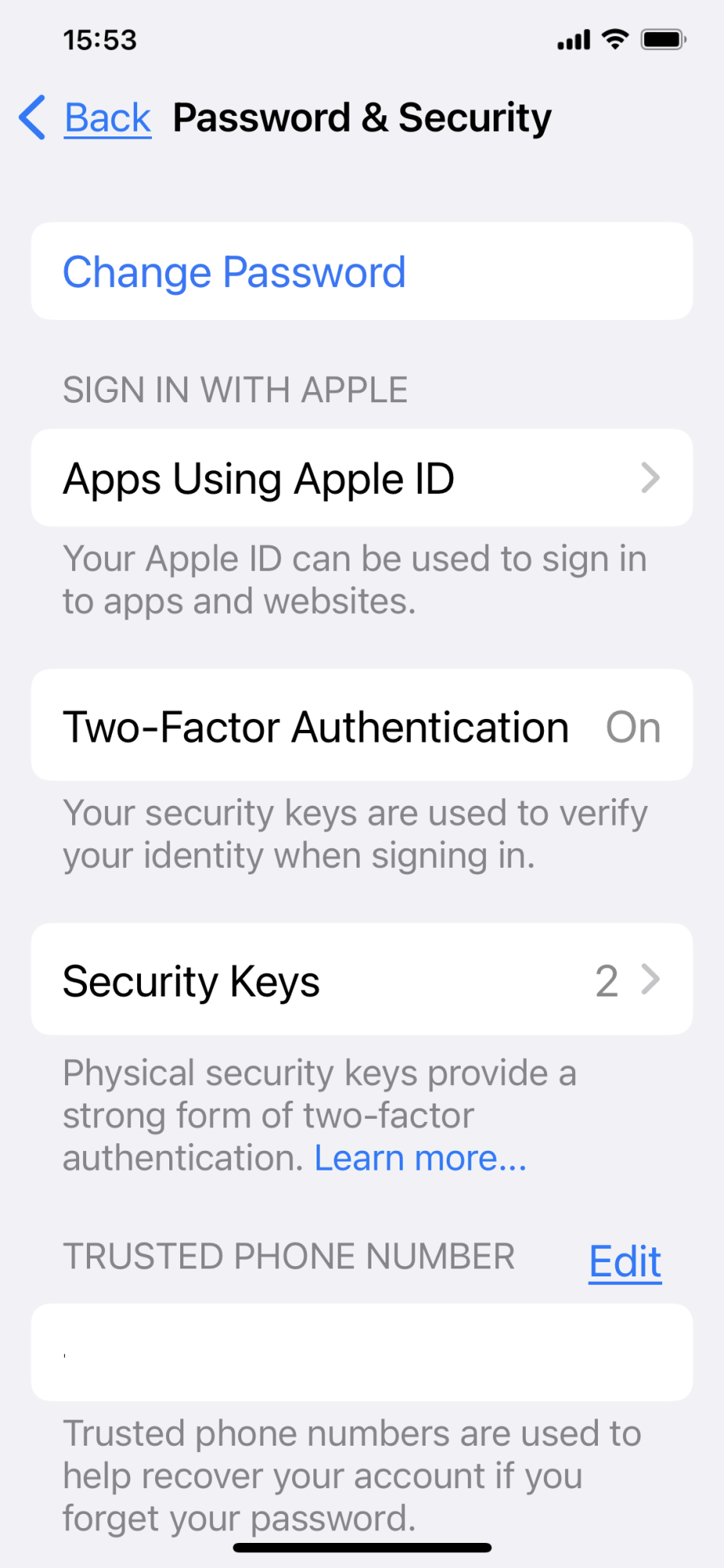

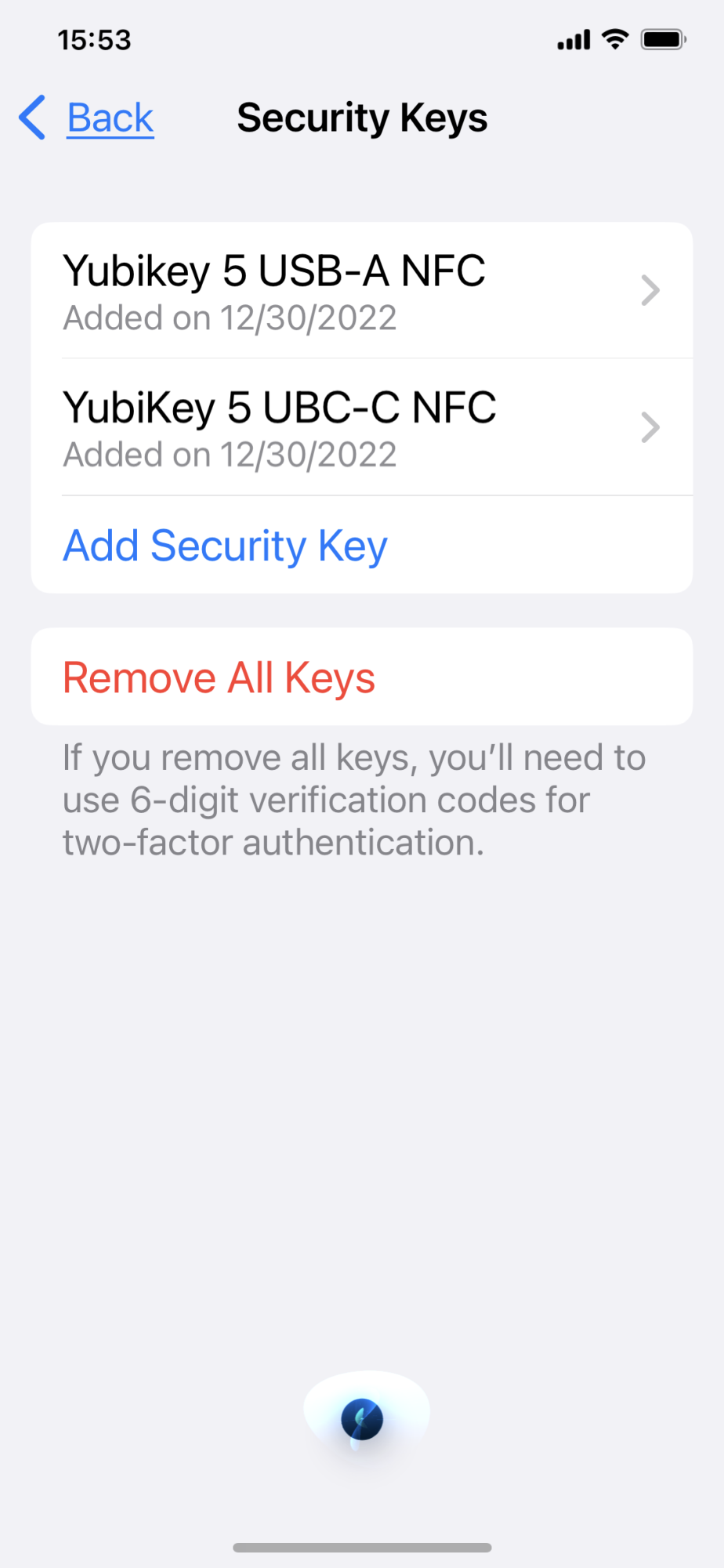

I've registered two Yubikeys on my iPhone 11 Pro Max with iOS 16.3 beta, a Yubikey 5 USB-A NFC and a Yubikey 5 USB-C NFC. However, on login I'm asked, as usual, to enter my 6-digit passcode rather than to use one of the Yubikeys. Both keys are working properly for login to my Mac Studio, asking for my Yubikey PIN. My phone is not a new device, so it is not subject to a 2-week wait period that I've read about.
Thoughts on trouble-shooting this appreciated. Screen captures below are from iPhone > Settings > Password & Security.

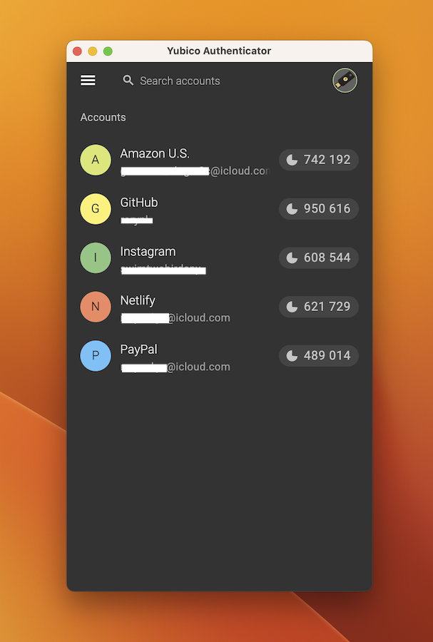

Further to the above post, here's a screen capture of the Yubico Authenticator app on my Mac display. When I want to add a site, the app will copy a QR image directly from my display, or I can copy and paste the code accompanying the QR image.
I do prefer using this app to using Google Authenticator on my iPhone or iPad. On a YubiKey, this protocol is called OATH. It is not FIDO2, which replaces passwords and doesn't require these codes.
As discussed in post #5, there is also a YubiKey Manager app. I used that app to set up the PIN for login to my Macs, using the protocol PIV. From my point of view, using a strong password on a Mac is a nuisance. A PIN addresses that. If one wants to do this with an Apple Silicon Mac, one should read the discussion about PIV and Silicon Macs on the Yubico website. That discussion is one of the reasons why I set up my Macs to accept both a PIN and a strong password rather than just a PIN. I'm not concerned that a thief will break my password, my internal drives are encrypted with File Vault, and my Macs are registered with Find My Mac.
