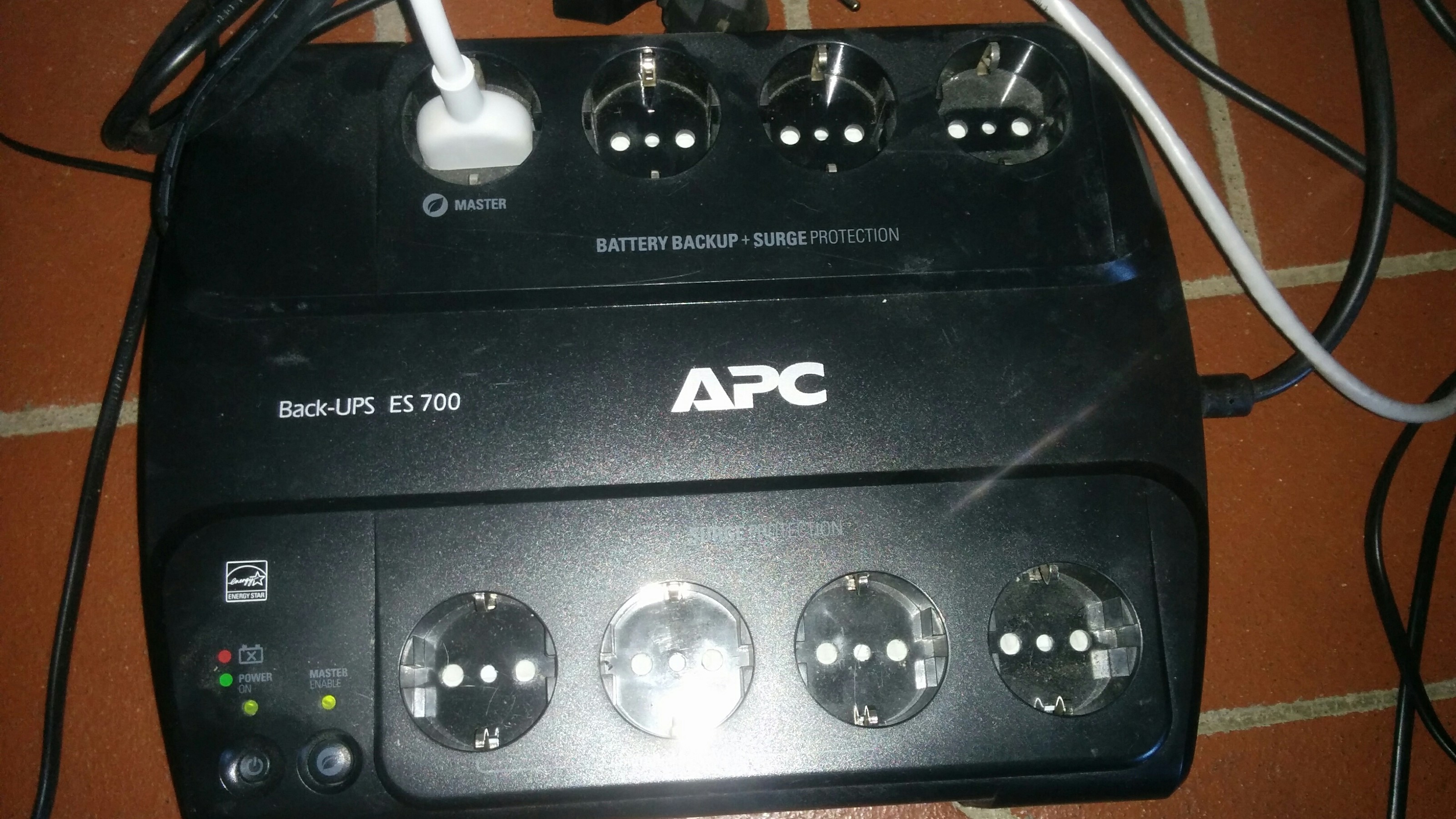

I'm not familiar with electrical stuff. Could you check if my UPS fits the iMac or not? It's an APC ES 700 (700VA, 320V) and a late 2015 27" iMac. I tried to disconnect all the plugs but the iMac one and do all the procedure again, the issue remains.

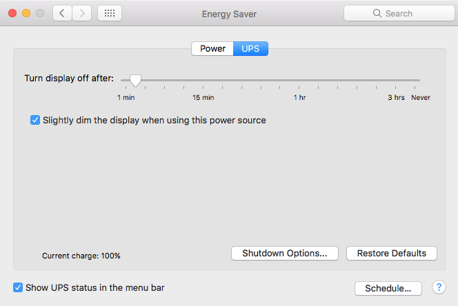

Try Systems>Energy Saver>Power-UPS... look into your UPS settings..If UPS is NOT connected to the iMac the UPS button will not show next to the Power button..
May be these settings need to be looked at..

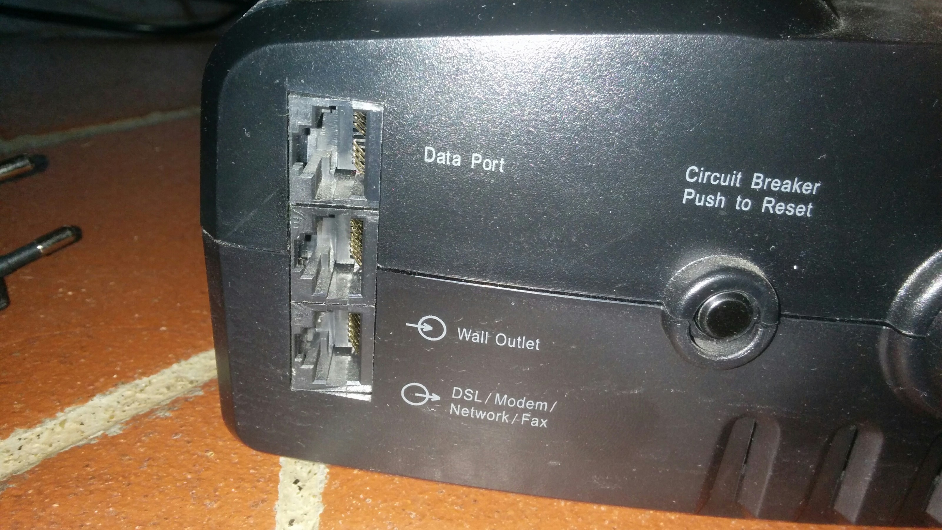

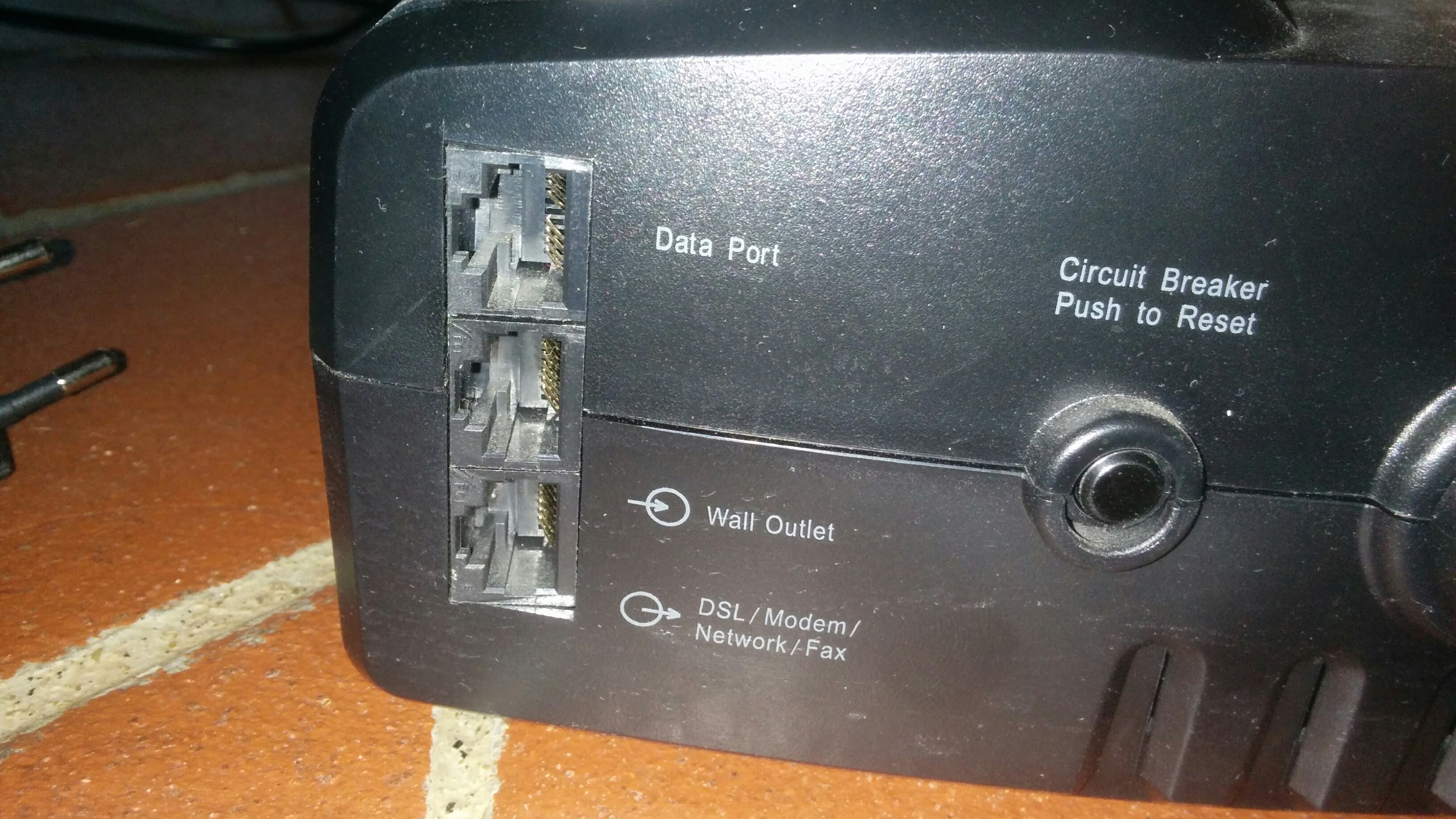

No 'Power-UPS' option in my settings. The iMac is connected to the UPS exclusively through its power cable. These are the other connections – there's a reset button too.
The UPS would have included a cable that plugs into the "Data Port" on the UPS and has a USB connector on the other end. That is what gives your computer the signals that the UPS is on battery or on AC power.
Right - my UPS included the USB and OSx recognized it right away
View attachment 714055 View attachment 714056
Like mentioned, there should be an RJ45 to USB cable connected to that data port to one of the USBs of the iMac. This lets the iMac know the battery state. That way you can get all the features from using a UPS.
RJ45 to USB is probably a standard so generic cords should work if you don't have the original. However to be on the safe side APC part # is AP9827.
Not sure if this will fix your problem or not though but its an important feature to use with a UPS.
I took me a while because I had to buy the data cable – I don't know where I tossed the original one.
I bought this cable: APC 2 MT USB RJ50 Back-Ups CS500 Data Port AP9827 940-0127
It should be like the original one. I connected it into 'data port' and directly into my Mac USB. Unfortunately it didn't solve the problem. When an outage occurs an info message pops up. The 'UPS' tab is not present in 'energy saver'.
I also tried to push the 'circuit breaker' button after an outage. I did it after turning off the Mac and unplugging everything connected (except the data cable) for safety. When I reconnected everything the Mac turned on regularly. Normally, to make it turn on, I have to connect it to a simple socket outside the USP, turn it on and off, and then reconnect it into the USP. I imagine it is safe to press this button also when everything's connected, isn't it? I may use it as a temporary solution when an outage occurs. I still have to reach the USP under the table, but better then the entire procedure I mentioned above. 😵
