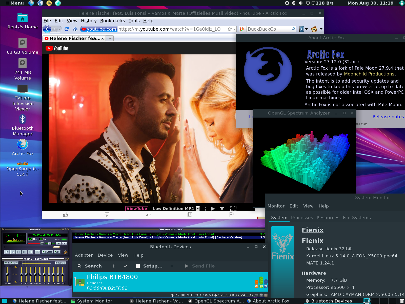

Great news! 🙂 Arctic Fox 27.12.0 is available. Downloads: https://github.com/wicknix/Arctic-Fox/releases
Reactions: eastone
Then i would say, probably not. While AF doesn't have the blue tint issue, it is based on an older firefox/palemoon. It more than likely lacks the updated code/codecs/javascript needed to play certain types of streams.
