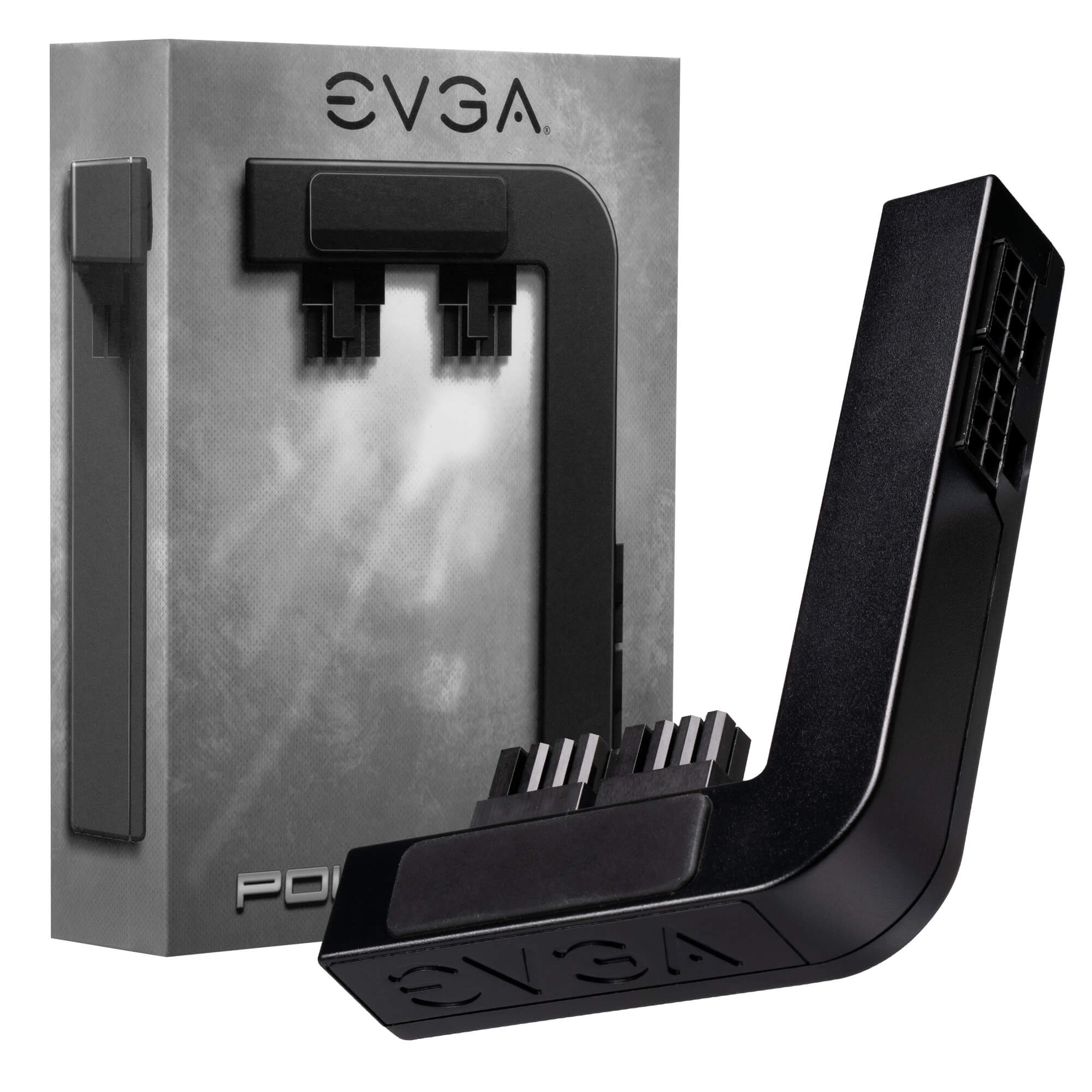

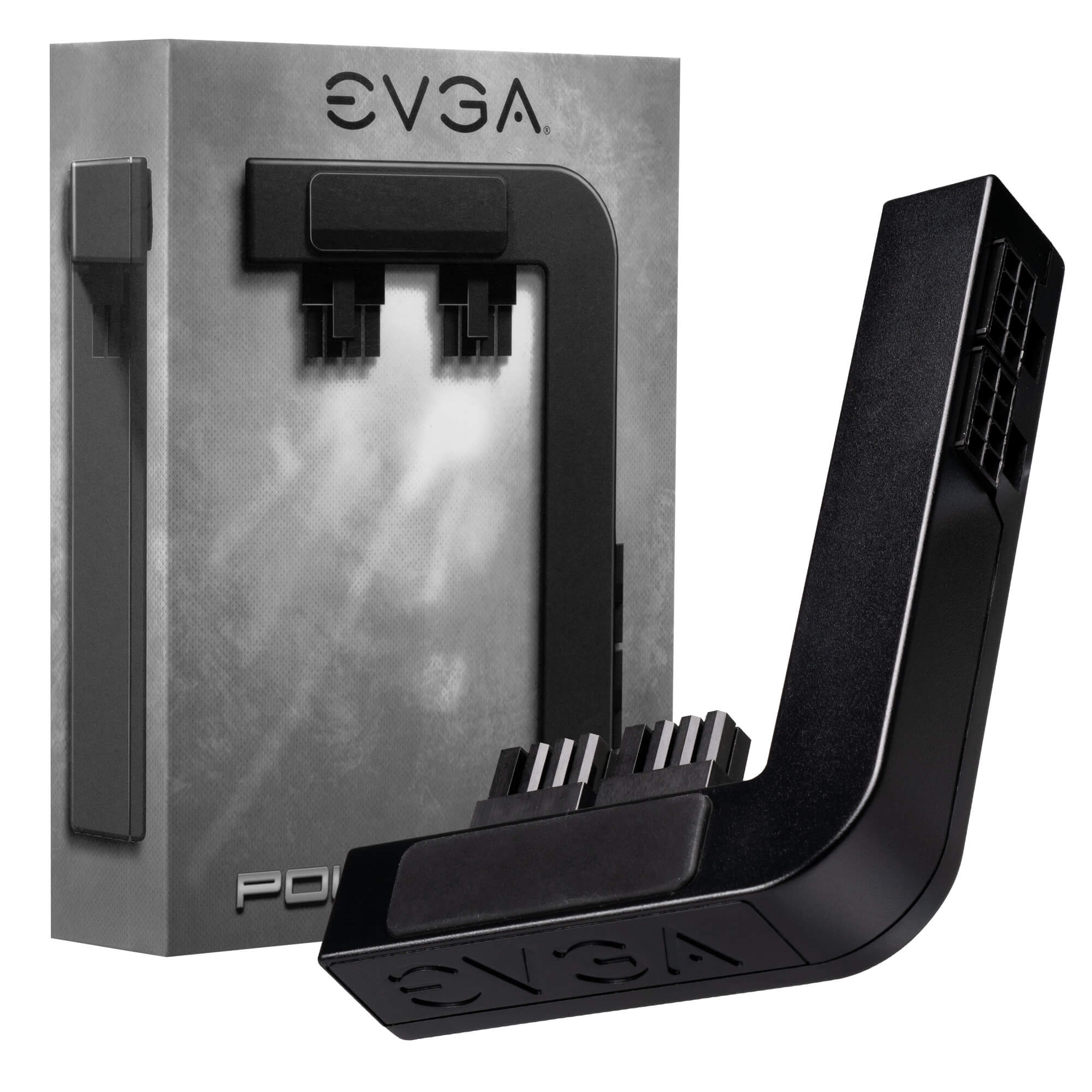

#2 Another fix would be to use the EVGA PowerLink in combination with Pixlas. Its harder to find these days, but most of the time it doesn't cost very much, around 20 bucks. This bracket equalize the power draw between those 8 cables and makes the power draw less dynamic for the Mac Pro PowerSupply.
