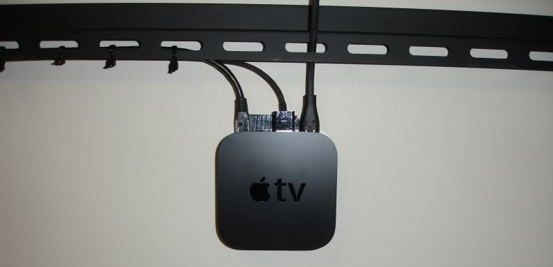

I got a new Apple TV3 for the kitchen. I had to reinstall, so I took a few pictures to show how easy this is to do. It makes for a neat installation.

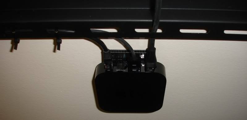

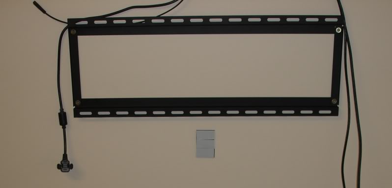

I stuck 3M DUAL LOCK HEAVY DUTY VELCRO STICKY PADS to the wall. I chose a spot at the bottom of the TV location where the TV has a hollow cut out to fit the stand.
I took a note of how far below the bracket the bottom of the TV would be. I placed a spirit level 20mm above this, got it level, then set the Apple TV3 on the level and pressed it against the sticky pads.

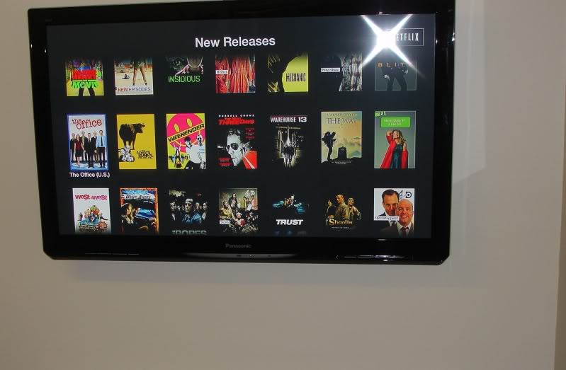

I left 2 feet of masking tape hanging off the Apple TV3 and 2 feet of masking tape hanging from the hollow at the back of the TV, and lined the tape up and set the TV on the bracket. The TV is heavy and big and its easier to look down the front at the two strips of tape than over the back.
After using Velcro to attach it directly to the wall I find that the controller works as well as if the Apple TV was horizontal.
