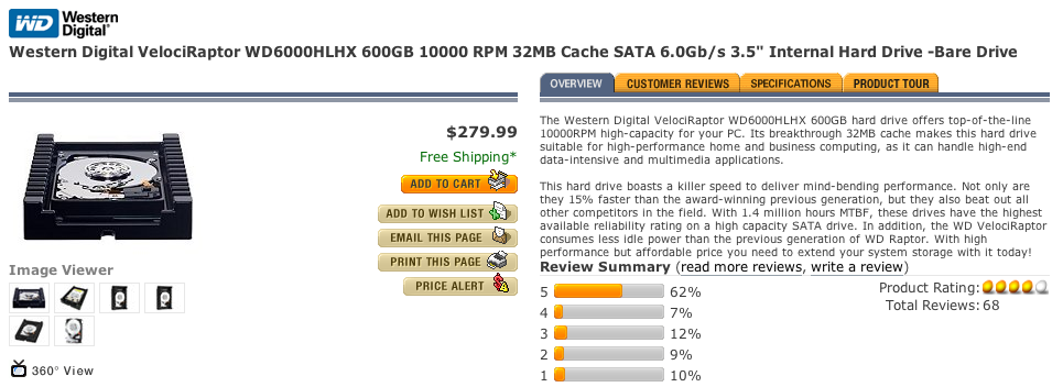

I installed this drive and the first thing I noticed is it is actually quieter and cooler than the 1TB 7200 seagate.
Quieter and it actually runs cooler as well by about 8-10 degrees. Right now it is at 89.6(F)
This is cooler quieter and it is much much faster, especially where it counts which is random accessing of data and multitasking. Drive access sound is much lower and at a more subdued frequency.
Amazing how freaking quiet these Mac Pro systems dead freaking silent.
I suspect the small size and the Icepak with its dampening gasket between the little drive and the outer heatsink is what does a big trick.

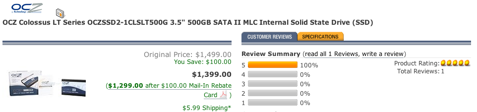

Not interested in spending 1500+ to betatest new hardware tech.

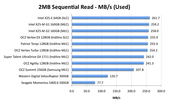

As for desktop use, if by readwrites, you mean random reads/writes, the SSDs significantly faster... here are the most recent charts for an SSD compared to a VR...
You will note that the Intel SSD is faster than the VR by a factor of about 25x on writes, and about 100x on reads. Yes, 25x on writes and 100x on reads! 😱
On Sequential writes which are arguably less common or coming from a more bottle-necked source in the first place, the VR is almost twice as fast as the Intel but beat handedly by many other SSD drives...
On Sequential reads, the SSDs once again own the mechanical drives...
The full article is definitely worth a read... http://images.anandtech.com/reviews/storage/Intel/34nmSSD/Review/used-4kb-read-mbs.png

You say it's a "waste of money"... well what if you like 1) space 2) money, as buying a SSD will leave you with little of both. Just because you can make do with 48GB doesn't mean everyone can.
