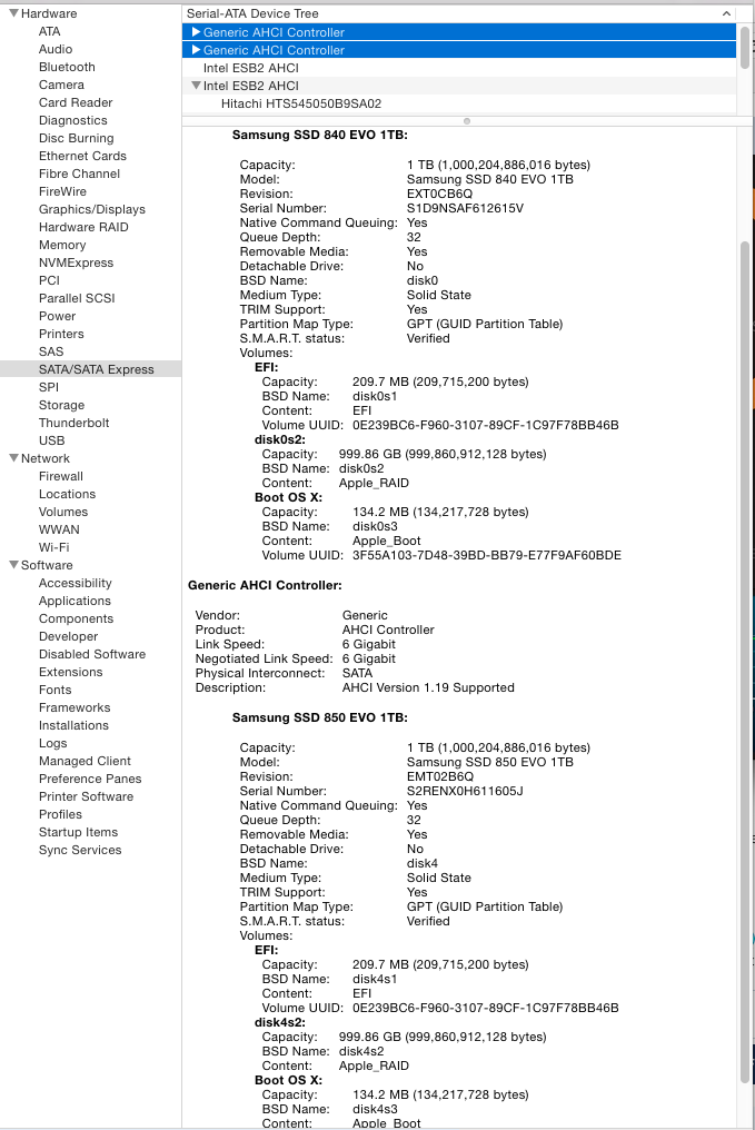

So, you're saying run this "sudo trimforce enable" after the RAID 0 is setup and I'm fully Time Machine restored? Or do I run the command before creating the RAID 0 (like in disk utility in restore mode)?
EDIT: is there also anyway to see if TRIM is infact enabled? I feel the first 850 I have been using may have TRIM enabled, where as the new one I just added, doesn't.
EDIT (again): ok I found this article that tells people how to do the command and how to see if TRIM is enabled. I just looked, and both my 850's say, "TRIM Support: No". I'm assuming because I wiped them both. Is that true, that if you wipe (erase) the drive through disk utility, that TRIM will be defaulted to off?
I'm going to redo the RAID 0, and then run the "sudo trimforce enable" command, and I'll get back to you guys to see if performance enhances!

Looking forward to your feedback after creating AppleRAID0 and using the "sudo trimforce enable" command in Terminal. To check the trim enabled in your About This Mac (see my first screen-cap in post#5).

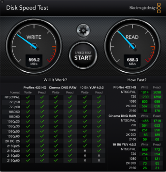

screen-shot-2016-10-20-at-4-00-51-pm-png.666907

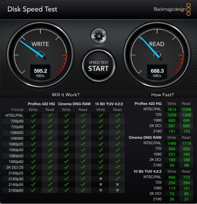

Wooo! Works like charm now 🙂
Thank you guys for your help, I really appreciate it!

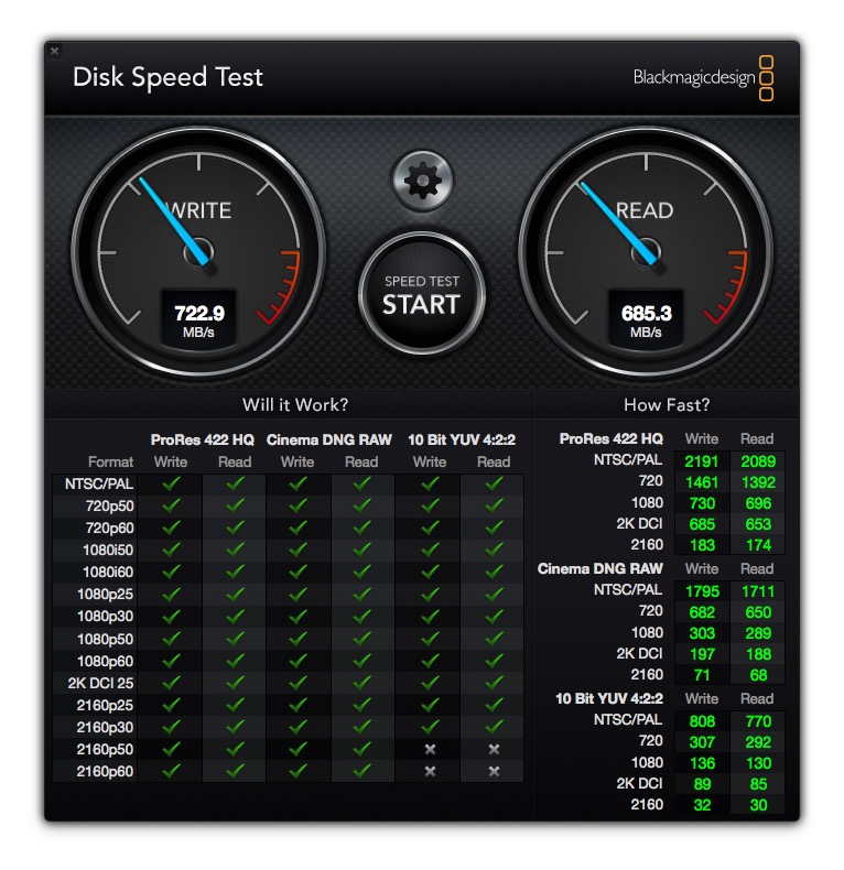

Yes, my 840 EVO 1TB Apple SOFTraid0 (2x 500GB) scratch disk and my two OS (OS X & Windows 10) SSD's are all being trimmed. I'm still getting very satisfying read/write performance on the DUO x2. My two OS drives and RAID0 scratch are still going strong since my purchase in 10/2013.
Keep us posted about the outcome of the trim and your 'new' performance!
Cheers
M4v3r1ck, is there anything special you done (software/hardware) that gave you 708MB/s? Our Reads are about the same, but you have 108MB/s writes more than I have, and I'm using 2 1TB Evo 850's, while you're using 2 500GB 840's. Is there really that much of difference between the drives we have or could it be that your block size is at 256k, while mine is at 64k?

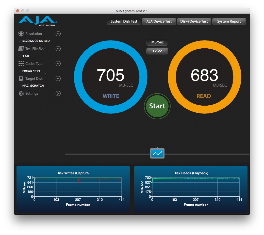

Your welcome! Glad to be of help. As for the blocksize I used the 'recommended' largest of 256K for large video files.

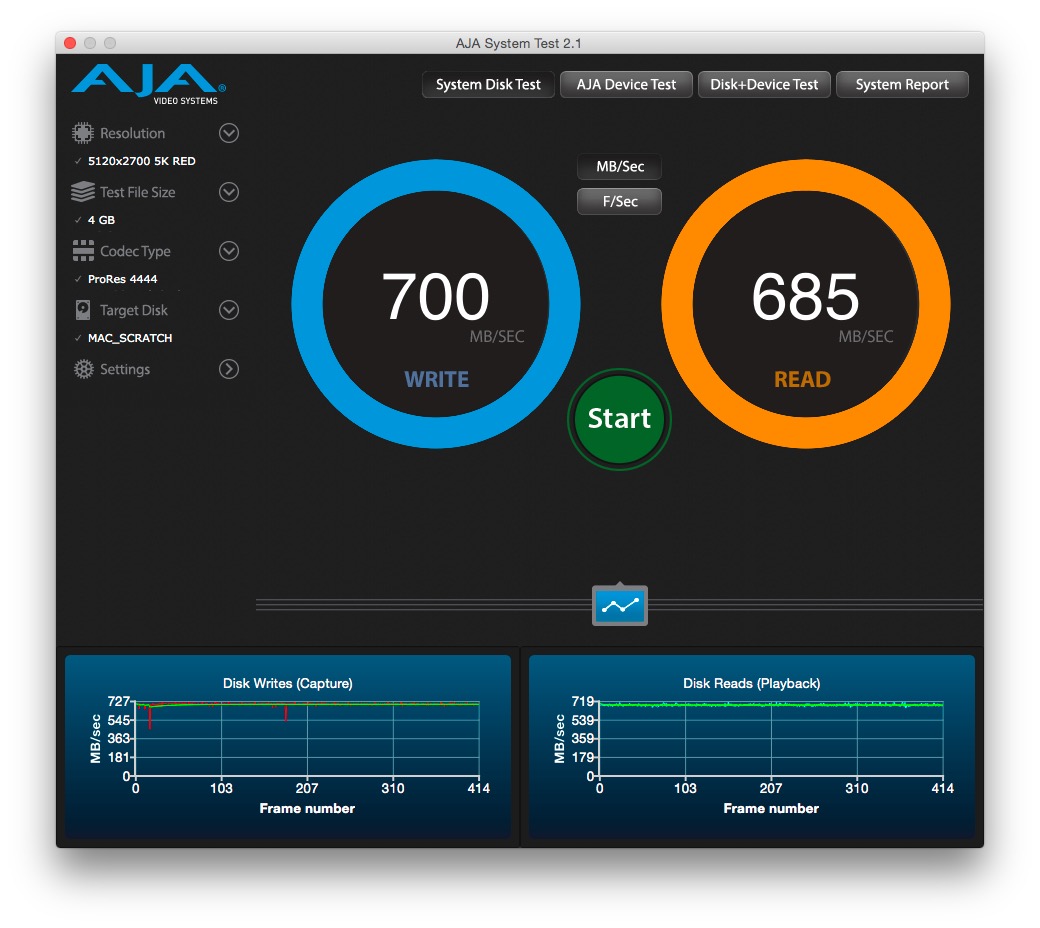

As I need to update my 840 EVO 500 GB (in RAID0) SSD firmware tomorrow, I'll delete the RAID0 and shall perform some tests with all the different blocksizes that can be used. Will report back here, this time with the AJA Disk Bench Tool. Practicing / having fun at the same time.
After that I'll restore my backup to the RAID0.
Cheers

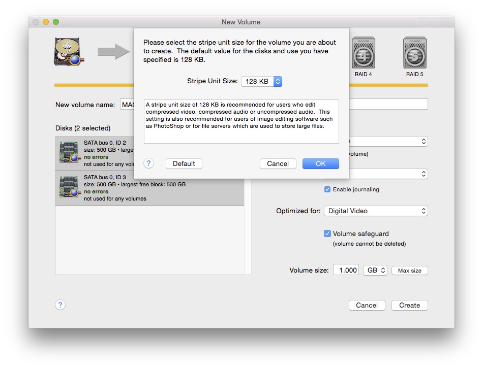

For comparison I created a AppleRAID0 with block size 64KB:
While SoftRAID (v5.5) recommends 128 KB for editing large video files on RAID0 scratch disks:
Well, let's not focus on the benches I showed. More important is that your write speeds @64KB AppleRAID0 are not according the specs and for sure not ~equal your read speeds. You did use BM with a 4GB stress?

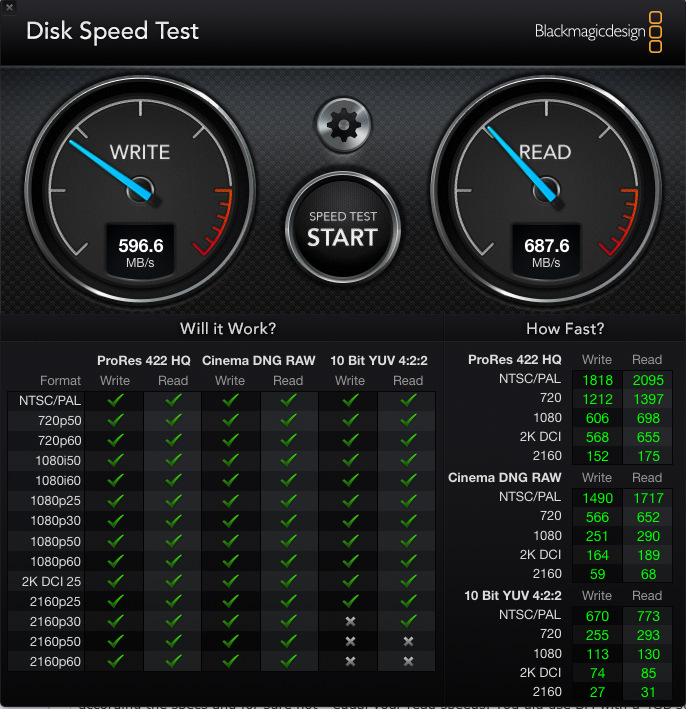

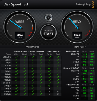

screen-shot-2016-10-21-at-12-44-42-pm-png.667046
I used BM 5GB and 4GB stress test, and get the same results (596mb/s write and 687 mb/s read)😕, and this is with 64k Block size. Are you saying there is something wrong with my drives (RAID 0) since the read/write speeds are not close to similar?
screen-shot-2016-10-21-at-12-48-23-pm-png.667048
Omg, I just realized that one of my SSD's are an 840 and the other is 850 😱 Could this be why I am getting lesser speeds than your RAID 0 configuration, because the two SSD's are different?
