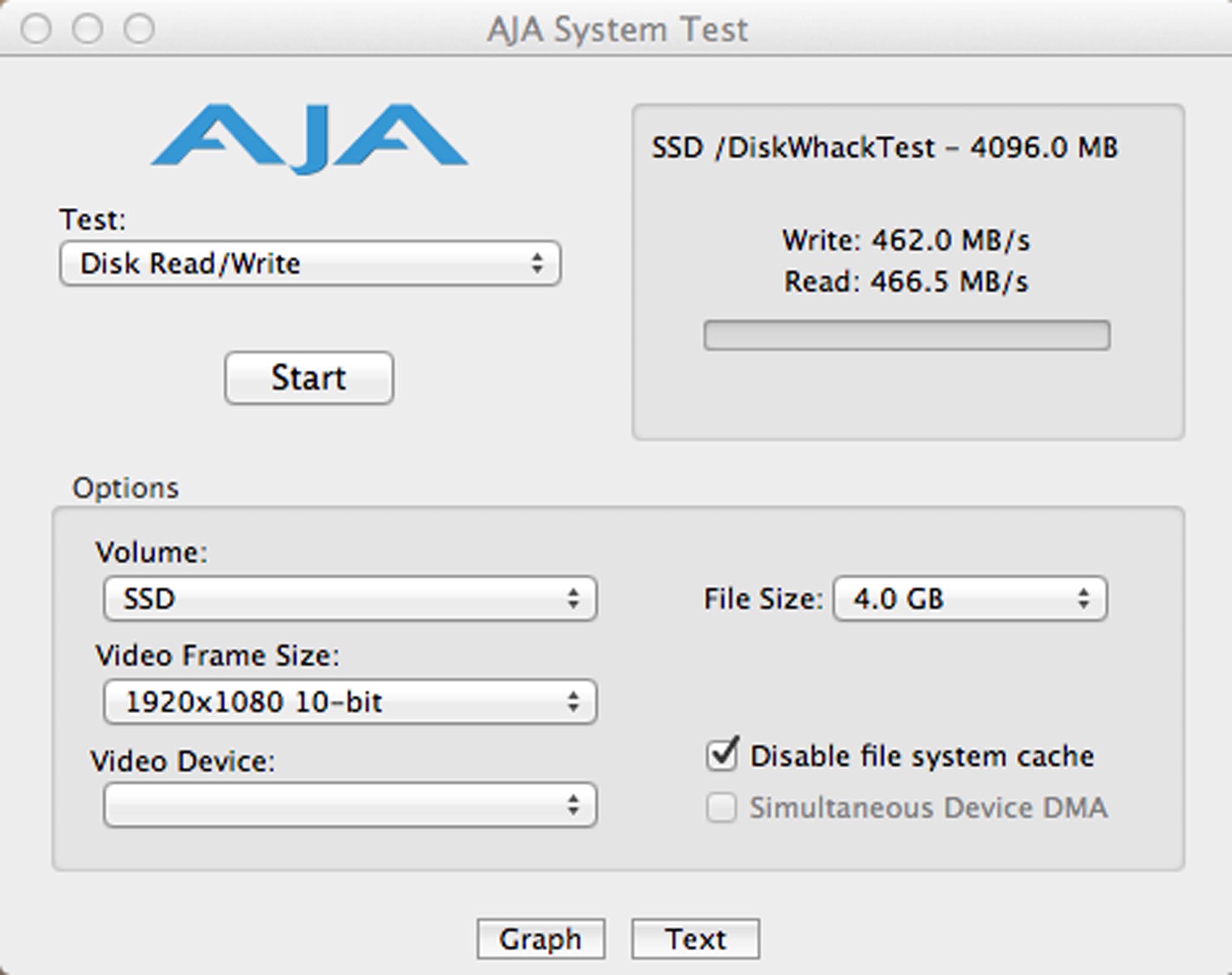

I installed the Velocity x2 yesterday and I have to say I'm not that impressed with what I'm seeing. There is a definite increase in the read time, but the write time is almost the same as the internal sata as you can see from the image. The ADATA SX900 maximum sequential read and write speeds are 550/530 MB per second.
I was expecting closer to 500 MB per second on both read and write speeds.
I'm waiting to hear back from Apricorn about this.

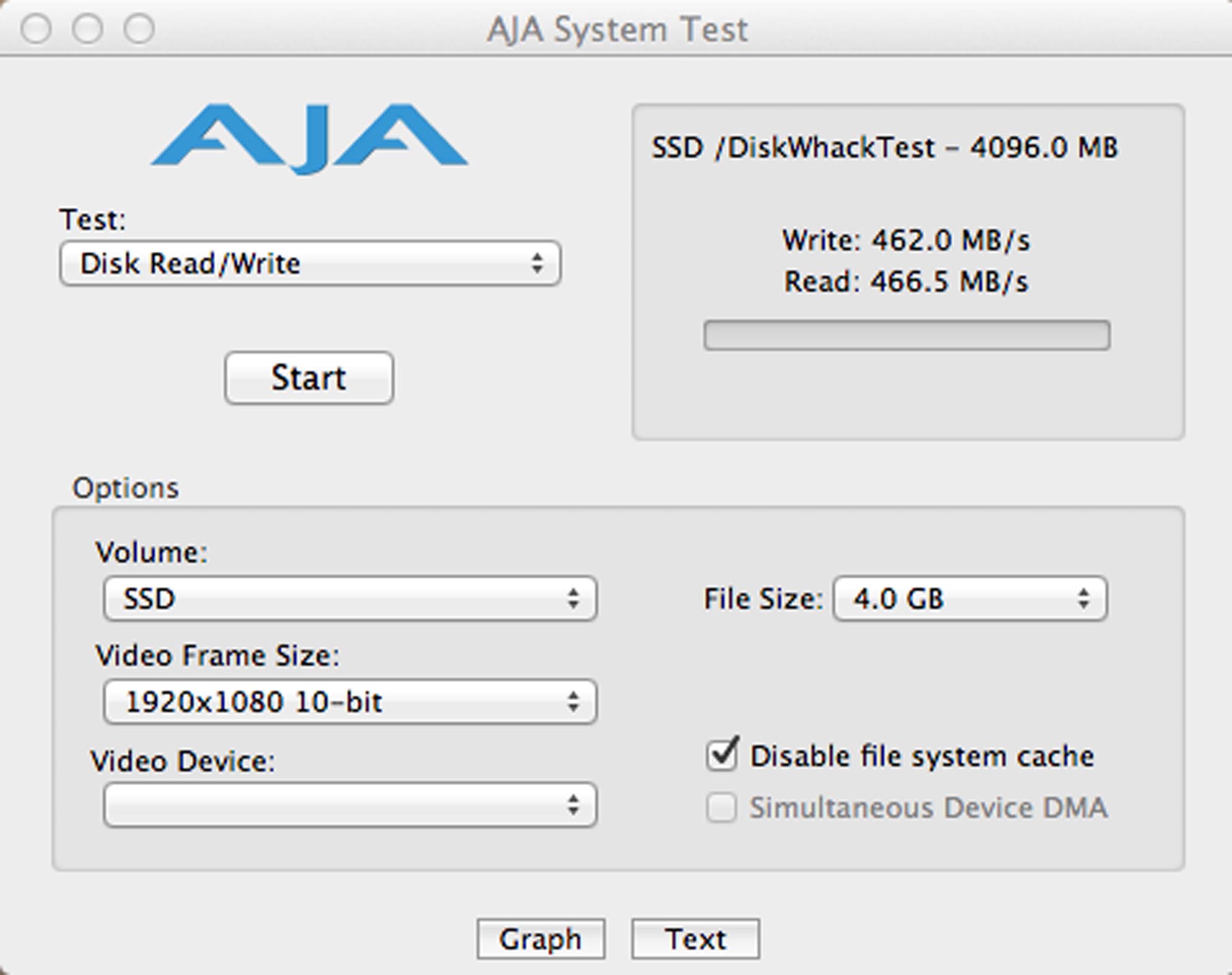

can you do a speed test using the aja system test?

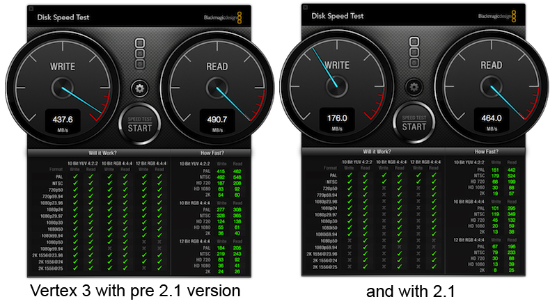

Here is the reply I received from Apricorn.
Hello letscopro,
I apologize for the delay, I was awaiting a response from a coworker. The Blackmagic disk speed test is using compressed data, not uncompressed data. Because of this you will see drastically reduced speeds. If you us an older version of the speed test software you will see much higher speeds since it is using uncompressed data.

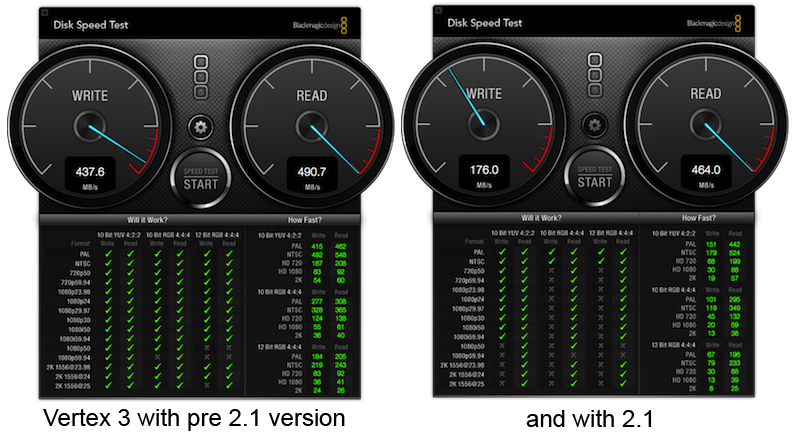

What's New in Disk Speed Test Version 2.1
Some SSD's use hidden compression when writing data to make their benchmarked speeds appear faster. Disk Speed Test will now measure the true speed of these SSD's so you know if they are suitable for high quality uncompressed video capture.
Last paragraph in the help says...
"Important note about Solid State Disk (SSD) speeds
Some models of SSD cannot save video data at the speed indicated by the manufacturer because the disk uses hidden data compression to reach these higher write speeds. This data compression technique can only save data at the manufacturer’s claimed speed when storing simple files or simple data, such as blank data. Video data includes video noise, and more random pixel data which does not compress much, so the true speed of the disk is seen.
Some SSD’s can have up to 50% lower write speed than the manufacturer’s claimed speed, so even though the disk specifications claim an SSD is fast enough to handle video, in reality the disk is not fast enough for real time video data capture. Hidden data compression mostly affects capture and often these disks can still be used for real time playback.
Use Blackmagic Disk Speed Test to measure accurately if your SSD will be able to handle uncompressed video capture and playback. Blackmagic Disk Speed Test uses data to simulate the storage of video so you get results similar to what you will see when capturing video to a disk. This will let you find models of SSD that work well for video capture. In our testing, we have found larger newer models of SSD, and larger capacity SSD’s are generally faster. Blackmagic Disk Speed Test also tests the speed of disks connected to eSATA docks and other interfaces, which can affect disk performance."
Testing my Vertex 3 with pre 2.1 version
(see image)
and with 2.1
(see image)
Same SSD, 2 very different results.
Sincerely,
Brandon
Apricorn Support"
Yeah, of course... makes total sense. Glad that's sorted out. I had forgot about that and wasn't sure what controller your Adata drive uses... It must be a Sandforce drive.

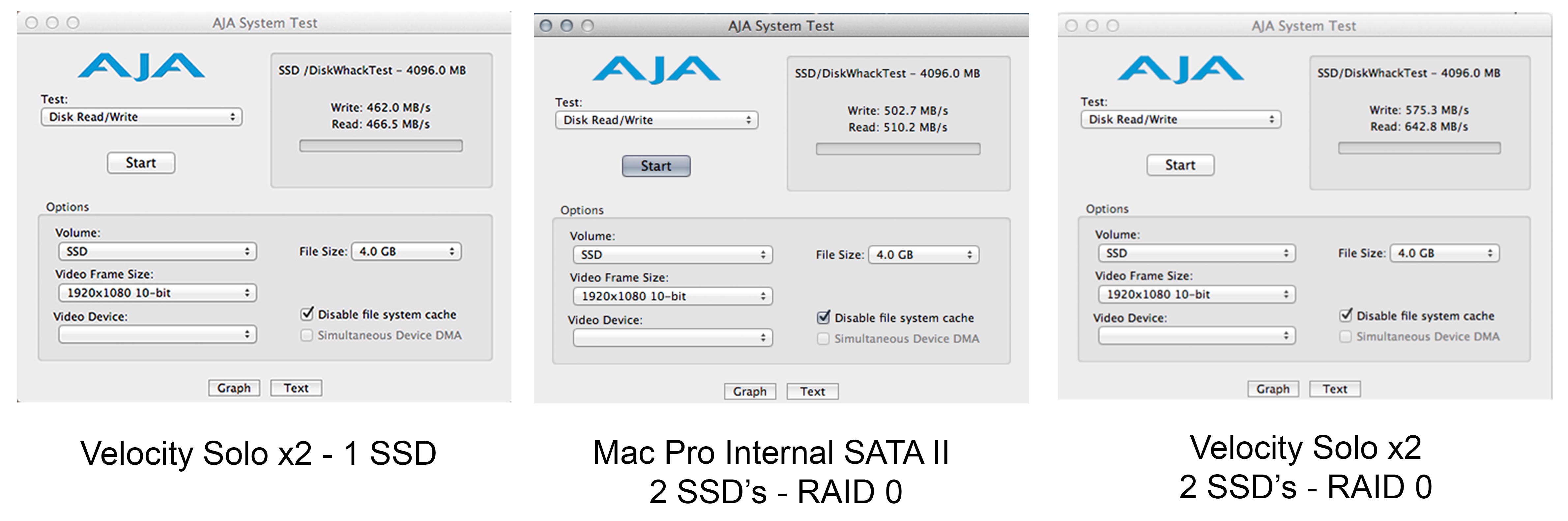

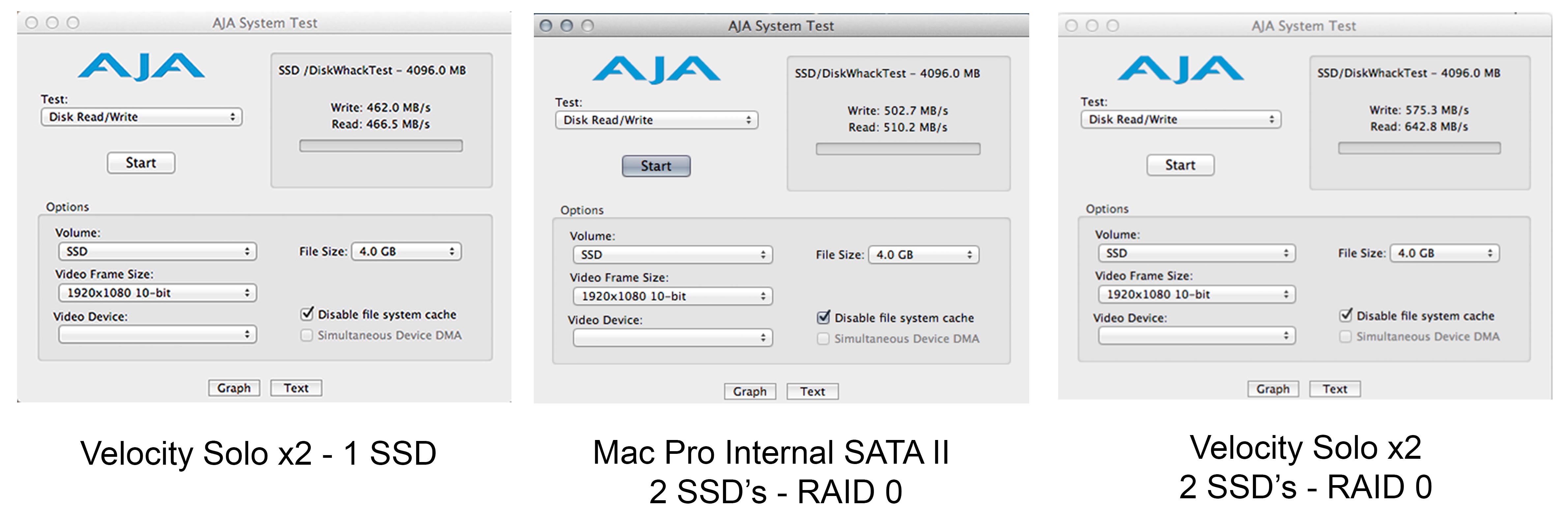

I bought a second Adata SX900 today. Here are the RAID 0 results.
Those numbers are actually a little better than I expected, but my only results are out of xbench and my 2 Crucial M4's. I *still* do not understand why I can't run the AJA test though on my RAID0 set. I've just tried it again with the latest version from their website and although it works against the other drives in my system, choosing my RAID0 SSDs on the X2 and clicking "Start" just does nothing - the write/read scores just sit at 0 🙁 Are you running 10.8 or something earlier?
Are you choosing an area on your hard drive that can be read and written to? Don't just choose the drive you want to test, but a folder inside it like your desktop folder, that has access for writing to.
You can do that with the Black Magic test, but with AJA you can only choose a volume with the read/write test and not a folder or location. You *can* choose a file itself for the "Disk Read Existing File" test with AJA and that *does* run for me when choosing a file on the RAID0 SSD array but its the read/write test on the array volume that does not.
(btw, using that disk file *read* test, AJA is telling me 612.2MB/s on the RAID0 of the M4s)
I'm running 10.8.
That's disappointing. You would expect 800MB/s. I wonder what's going on.
What slot are you running the X2 in and what year Mac Pro? While it shouldn't matter, it might be worth trying this card in one of the slots designed for a graphics card. I'm not familiar with the slot configuration in 2008 and earlier but in 2009 onwards, that would be one of the two bottom PCIe slots. I'm just wondering if there's something limiting the throughput on the Intel chipset or Apples implementation of the PCIe bus on the x4 slots.
