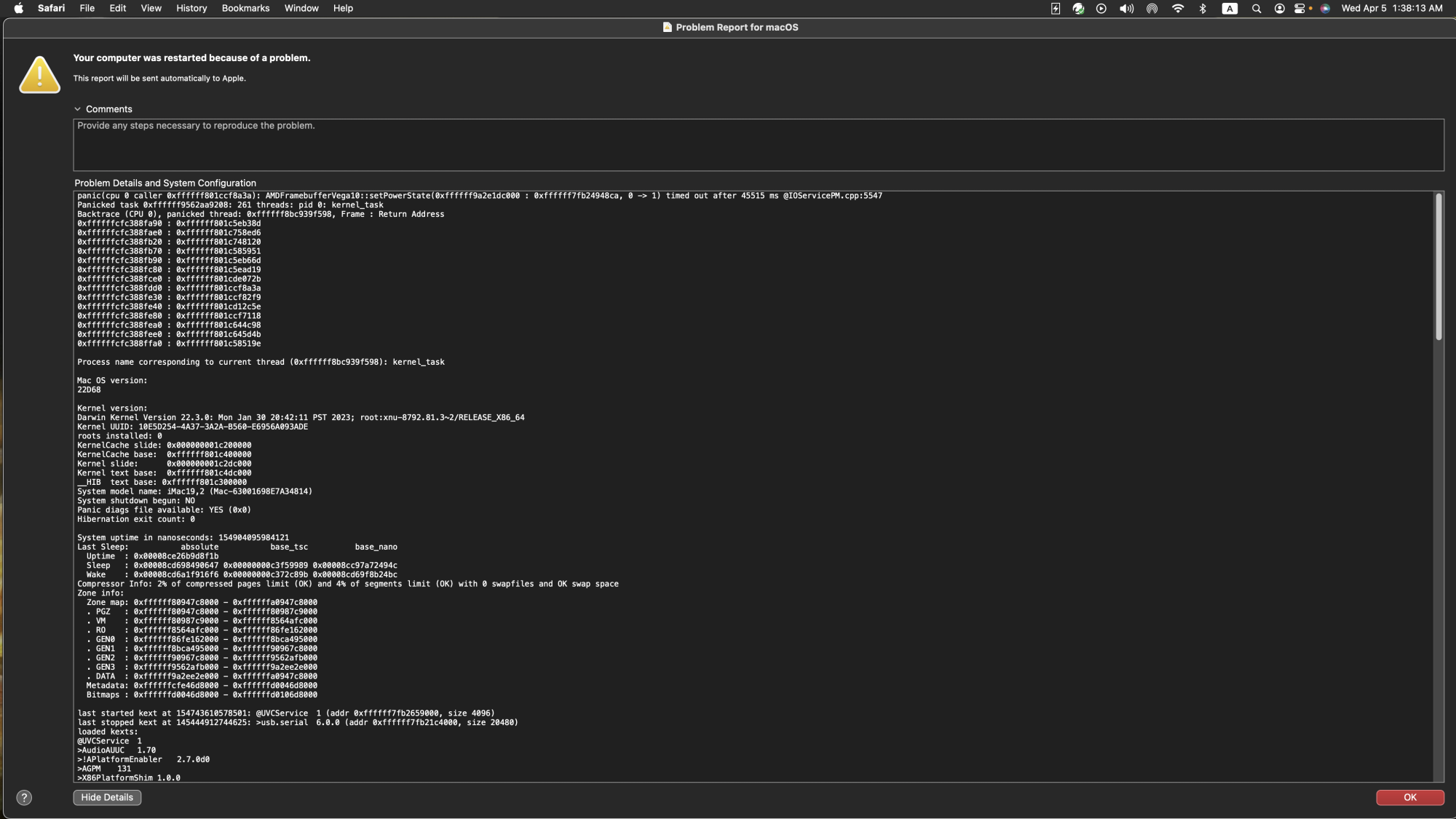

I have an Intel CPU and am unable to use any USB devices via my dongle which makes it impossible to get to my backups or thumb drives. Even SD cards are an issue. Luckily I have a card reader that can go into the USB-to-USB-C dongle or USB-C. The same reader and card combo will work only if I use the USB-C port.
Been having the same problem. I updated to Ventura a few weeks ago. I've had at least 4 Kernel panics since. 2 while I was editing and 2 while it was sleeping. Woke up to another one this morning 🙄
I spoke to somebody on the phone and they told me it might have something to do with external devices. He told me to disconnect everything that wasn't a keyboard and mouse and see if it keeps happening. I'll give it a shot, but god this is such a pain in the ass!
I also have an Intel CPU
Reactions: George Dawes
JUST WHEN I THOUGHT IT WAS OVER TOO! 🤬
I've been shutting down my Mac every night for just over 2 weeks now, which is not what I'm used to doing. I usually only turn it off when I'm traveling or when it needs to update. Anyways, it worked for a little while, so last night I decided to start leaving it on again. This time she made it through to the morning! I hoped that meant it was finally over! Then I left for about a half an hour to grab lunch and came back to find... you guessed it, it shut down while I was gone. As it turned back on I was greeted with, "Your computer was restarted because of a problem." I don't know what to do!
This is ridiculous, I expected better from Apple

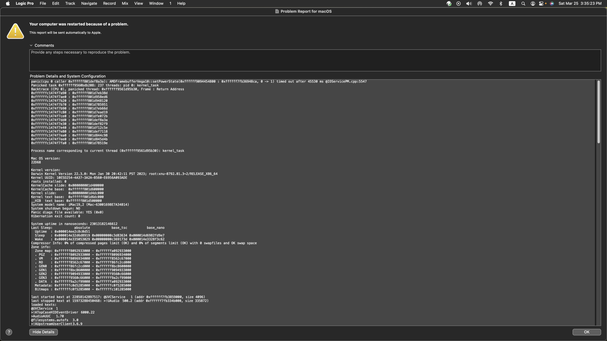

My setup is as follows;
I have a M2 MBP 13" and I use it in clamshell mode connected to my screen (Philips 329m1rv) through a USB-C cable which is capable of charging it with 65W PD and serving as a USB hub at the same time. I plug in my USB peripherals to my screen and then the rest is handled by the USB-C <--> USB-C connection between it and the MBP.
I've been having the same problem for quite some time. If leave my MBP idle for a couple of minutes, screensaver kicks in and then it restarts itself displaying a report after I login telling me that my computer has restarted unexpectedly. It also happens when I'm using my computer actively, not doing heavy stuff, like browsing or typing. First, the screen freezes, can't move the cursor around then a pink/magenta screen is displayed for a second and then it restarts.
I've updated all applications and the OS. I've tried quitting one application at a time until I experience a restart. I've tried running extended diagnostics. Nothing has worked until yesterday.
I have a Logitech MX Master 3 mouse and it comes with a unifying usb adapter which is plugged in to my screen's USB hub. Yesterday I removed it and started using my mouse with bluetooth connection. I haven't experienced a single crash/restart since then. Compared to 5-6 crashes per day, I think I've found the problem.
TLDR;
If you have a Logitech device and you're using a unifying adapter for connection, just stop using it and switch to bluetooth connection if possible.
Hope this helps someone.
