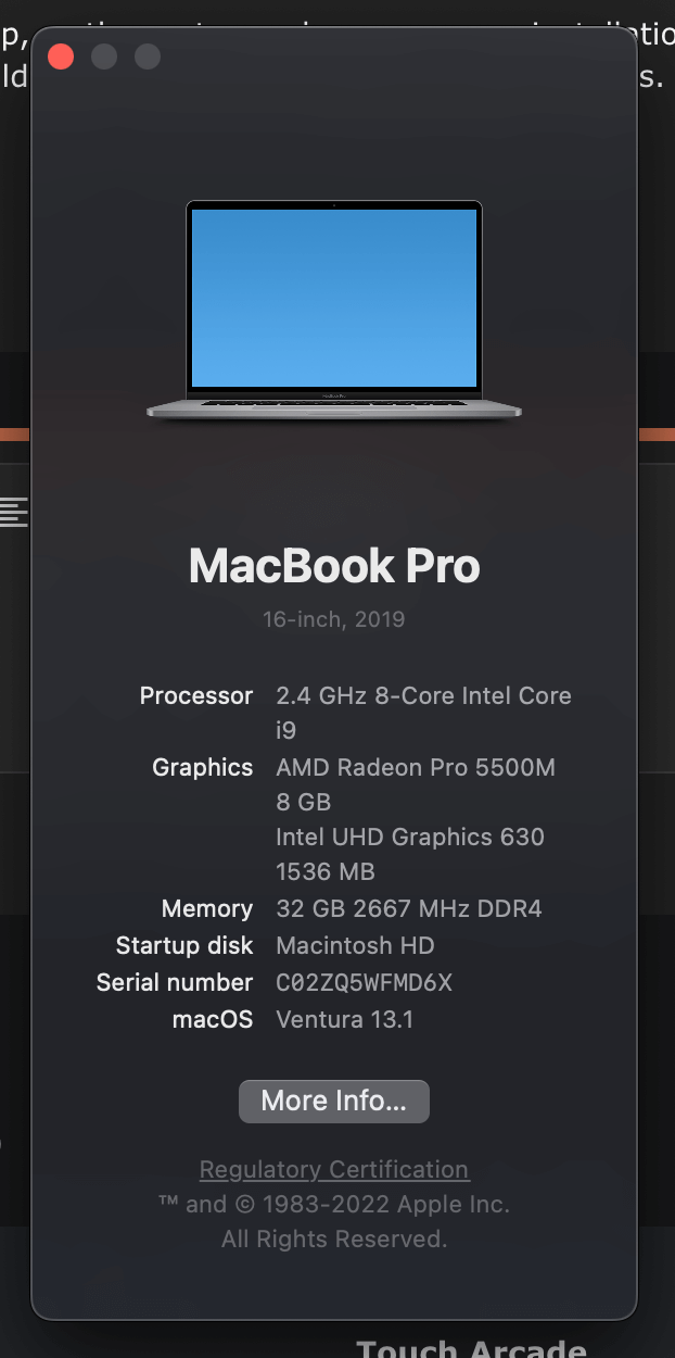

Reinstalling Ventura won't help, as the system volume on every installation is exactly the same. I'm tempted to suggest a hardware problem, but it would be nice to know what model your Mac is.
Here you go.

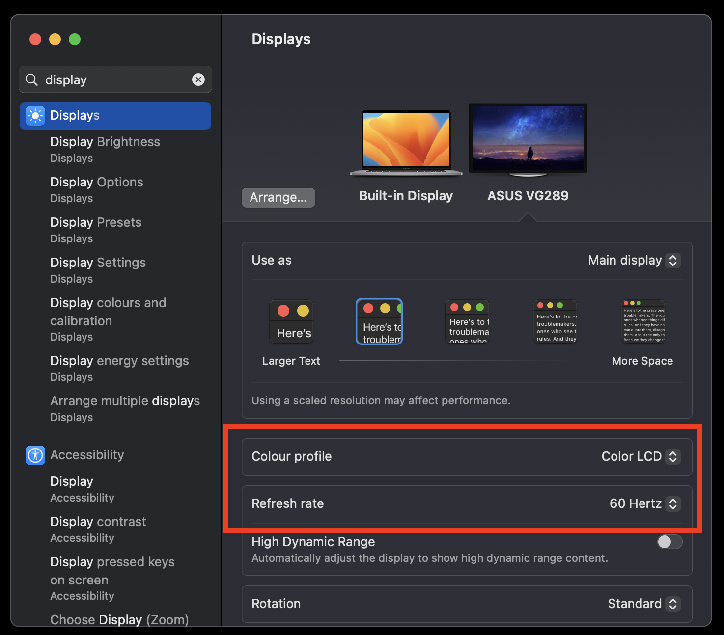

I tried making the color profile the same for my Mac and my external monitor, and I think that has eliminated the issue (for now).

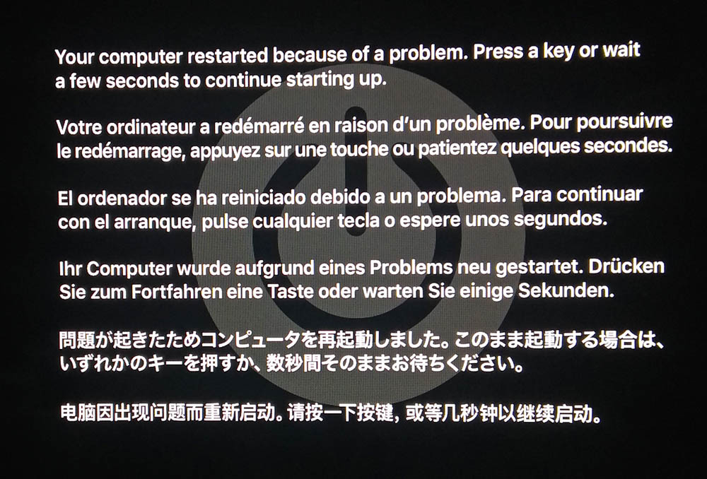

This problem (after sleep it is showing error message and rebooting) appeared to my i7 MBP "16 2019 with Ventura 13.5.1 about 2-3 days ago. Everything worked fine before that. I am not sure but maybe I've updated OS at those days and got bug after that. Does anyone else have the same problem?
Reactions: Achinta
Note that I often use an additional monitor, but this problem also occurs when I use it without a monitor
