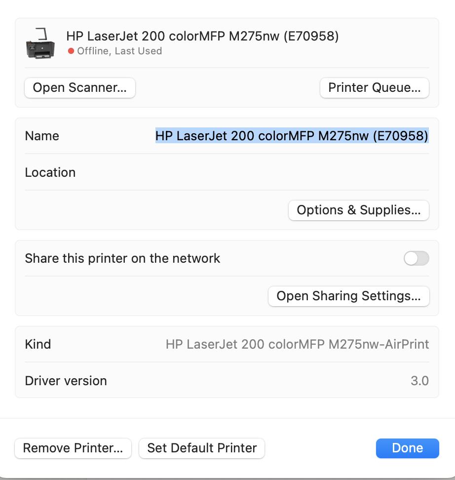

I haven't been able to print at all since updating my MBP (2021) to Ventura 13.1. Actually, I think the issues started when I was running Monterey, but I don't print super-frequently so I didn't catch the cause/effect link at the time.
Back to the problem. I was surprised there wasn't a thread in this forum for printing issues....when I searched elsewhere on the internet I find a reasonable amount of people reporting the issue. Unfortunately, I've tried EVERYTHING the other sources claim could fix the problem and none of them fix the problem.
Depending on how I install or try to install the printer I get a range of errors. With certain drivers I can install the printer but then when I try to print the print job is 'not accepted". With a different drivers the printer won't even install (shows up in the list but the mac says it cannot connect to it).
I have tried:
Uninstalling/reinstalling (see previous paragraph)
The standard power on/off
Restarting the MBP
Reset Printing System
Updated drivers AND trying previous drivers
I've ensured the printer and computer are on the same network, restarted the router, reset printer settings, etc.
I don't believe it's printer or printer brand specific; however, the printer is an HP LaserJet 200 Color MFP M275.
I'm losing my mind! I don't print often but that means when I DO print I really need to print something....so this whole "won't print" debacle is extremely inconvenient at the moment. I've spent hours and hours trying to fix it. :-(
Help?
p.s. Seriously...Apple used "System Preferences" for eternity and in Ventura they just decided to rename it System Settings? Why?????

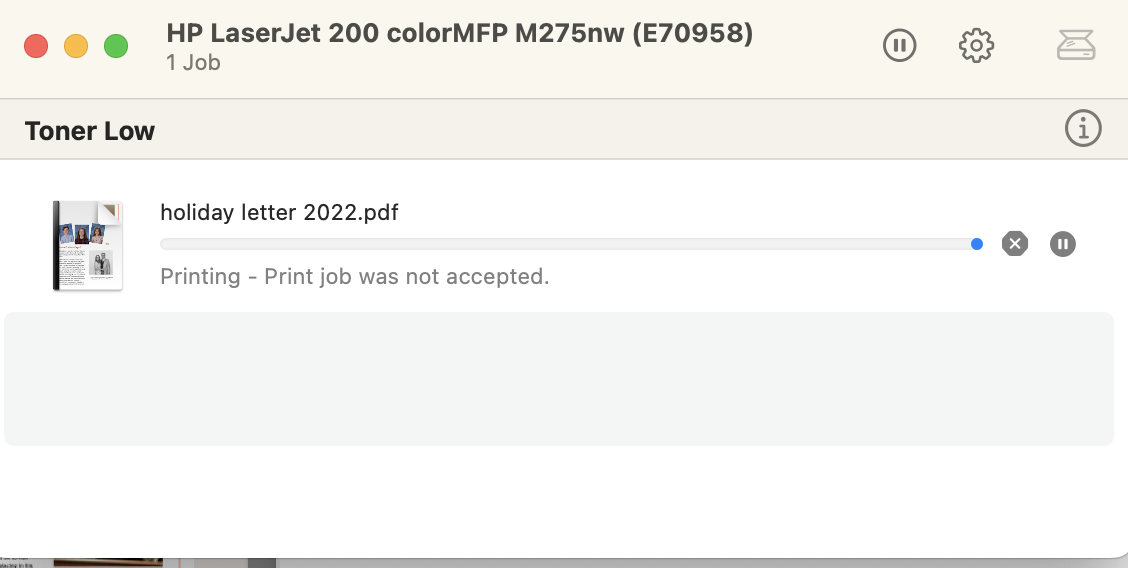

It is set up as AirPrint right now....still doesn't work. I tried both AirPrint and the HP Drivers....neither is working.

well its got no toner so it will not print
I find your comment rather rude.
If you bothered to read the rest of the thread you would see that airprint from the phone worked sometimes. So it cannot possibly be the toner. But nice try.
This printing issue is becoming more maddening by the day. I printed the file twice from my phone but then without changing ANY settings it refused to print the next time. I restarted the printer and it printed part of a page once then refused to print again.
I tried my sister's phone with similar results. Documents usually either print or they don't. Why would it successfully print the file once or twice and then refuse to print it again and/or print it only partially?
that's a odd comment when you have clearly posted a pic. of the error that is present eg. toner LOW
