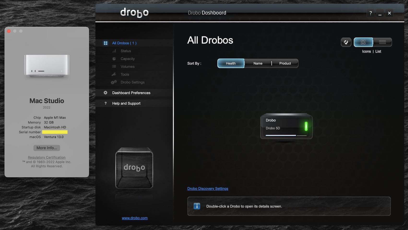

After reading comments here and on Reddit, I also updated to Ventura,
and I can also confirm the Drobo dahboard still works fine 🙂

Good to know - here all is working OK too. Lets hope, further updates of Ventura don't break it.
Reactions: Absrnd
