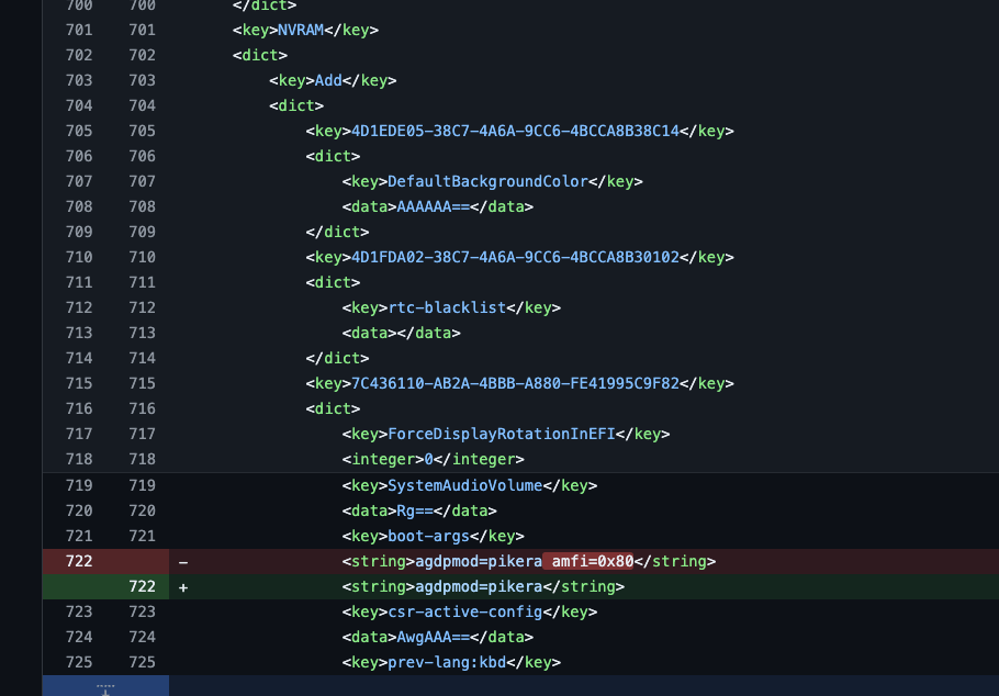

How to apply AMFIPass.kext
1. If you are using the amfi=0x80 flag, first remove it from config.plist.
2. Add AMFIPass.kext to the kernel section of config.plist.
3. If you were using the amfi=0x80 flag, remove amfi=0x80 stored in nvram through nvram reset.
* If you use AMFIPass.kext and amfi=0x80 together, AMFI will be disabled as is, so you must remove amfi=0x80.
Have you followed the precautions above?

Thanks for the reply where can i see if the flag has this value? other thing is the kext is in EFI partition in OC/kexts inside and its version 1.4. How can i remove the flag amfi=ox80. Thanks
If you checked the version of Kext, it means that you have mounted the EFI partition. Under this assumption, you need to find the presence or absence of the amfi=0x80 setting in the config.plist file.

Now its running i removed the ox80 flag in config.plist and selected gfxstatus discrete graphics!!!. Thanks
