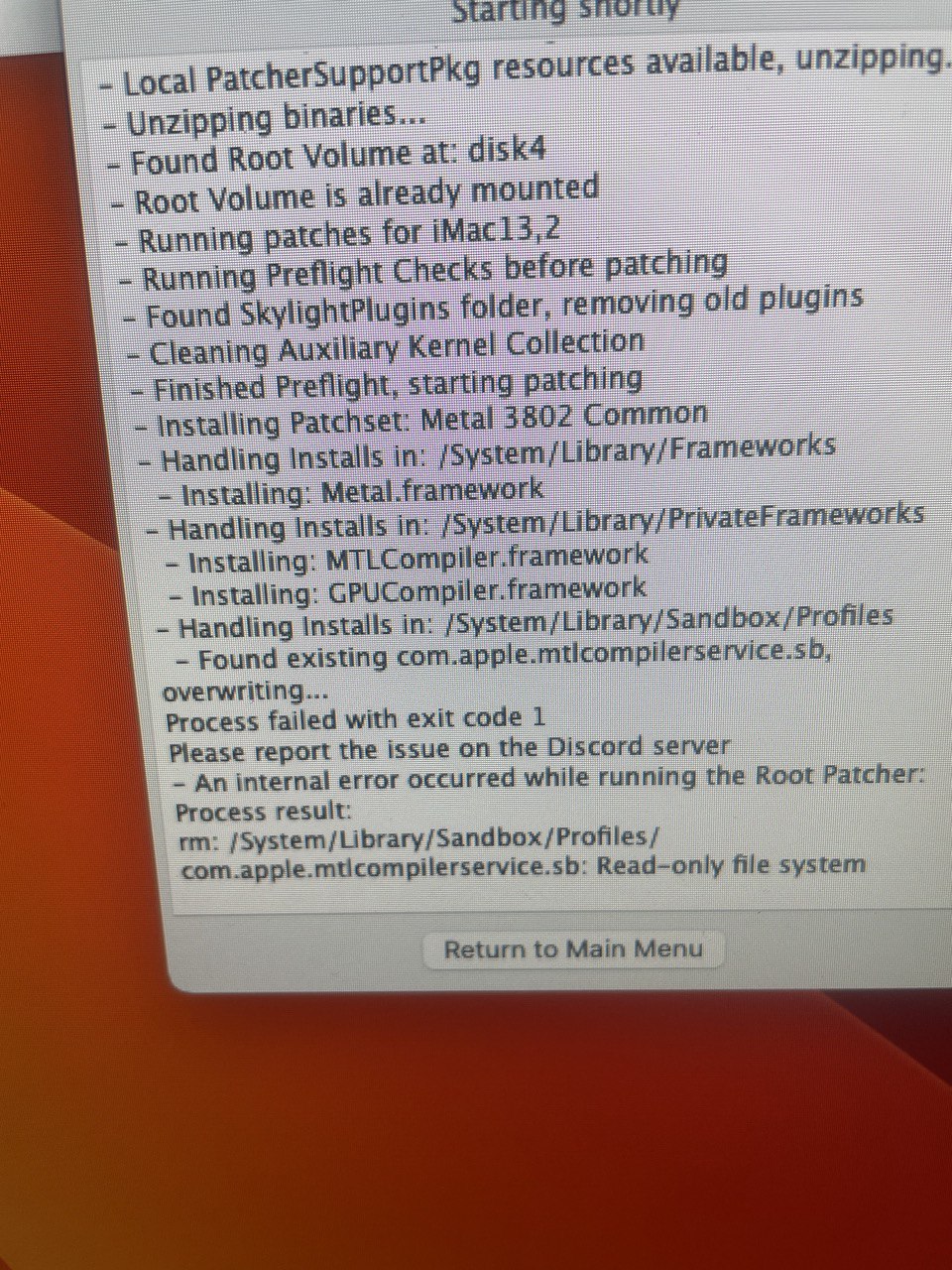

Hello and good afternoon,
I hope someone can help me here with my configuration:
iMac late 2012 (iMac 13.2) Processor type: Quad-Core Intel Core i5 Processor speed: 3.2 GHz Cores: 4 GPU NVIDIA GeForce GTX 675MX 1 GB RAM 32 GB 1600 MHz DDR3
Yesterday, I tried to install macOS Ventura on a Samsung T7 SSD 1TB on AFPS using the above OCLP as a test. After several attempts, I managed to download OCLP 0.6.1, extract it, and move it to the program folder. I then created a boot stick in AFPS, placed the installer on the stick, and installed it on the SSD. After several attempts (as the system kept rebooting and selecting the wrong disk since the SSD could not be set as the startup volume at that time), it finally worked. However, the system was running very unstable and was difficult to use, so I tried to implement the post root patches. The start was normal, but ultimately, I received the following error message:
"An internal error occurred while running the Root Patcher: Process result: rm://System/Library/Sandbox/Profiles/com.apple.mtlcompilerservice.sb: read-only file system."
I made all files visible and got to the /Profiles/ folder, which appeared to be empty. I also tried to change the permissions, but that did not work for /system/ of course. The same error occurred after a complete reinstallation.
I have attached a JPG of the entire patch and hope that someone can help me figure out what I did wrong or how to fix this error. Thank you for reading, and I look forward to your opinions.
