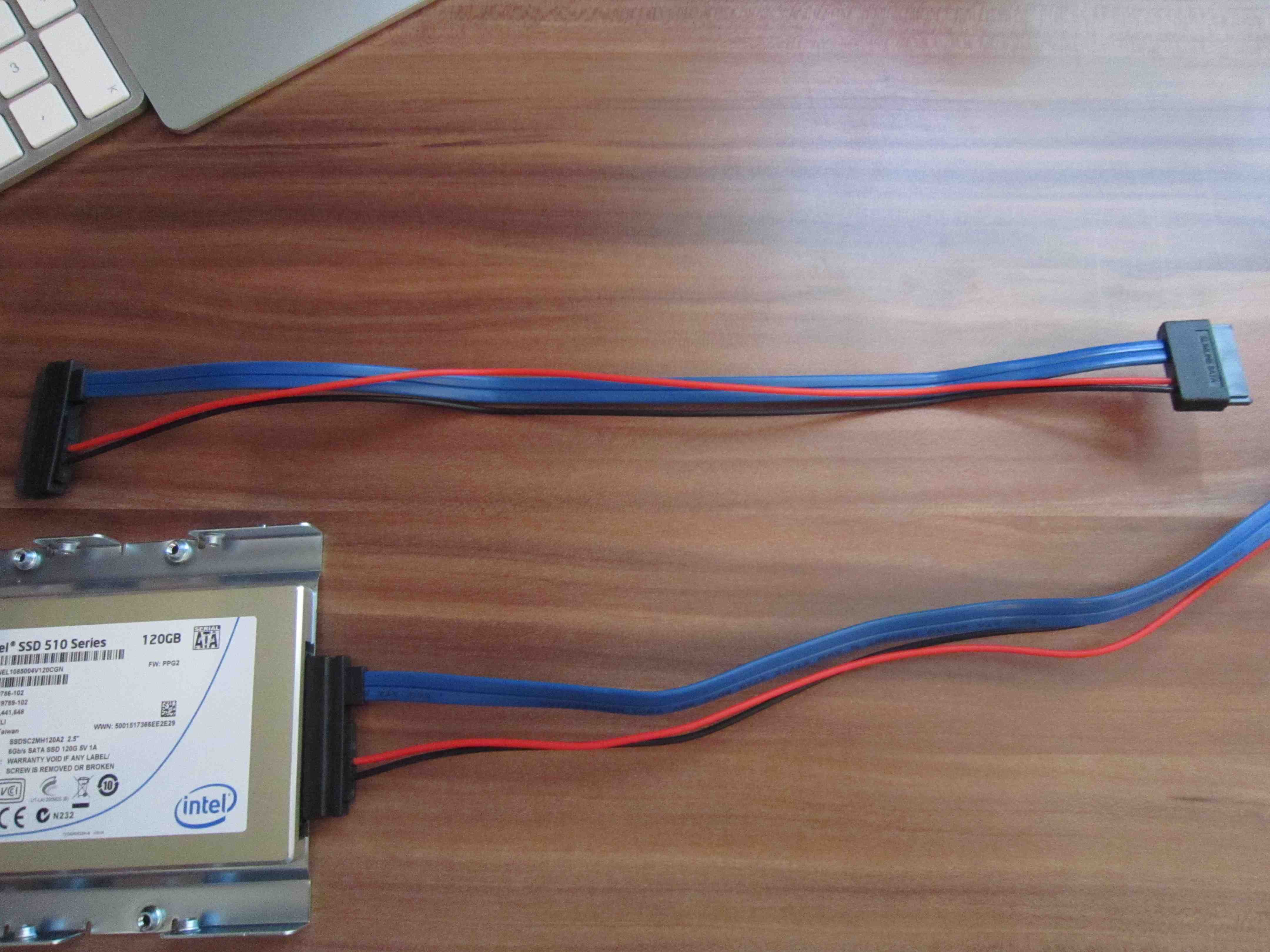

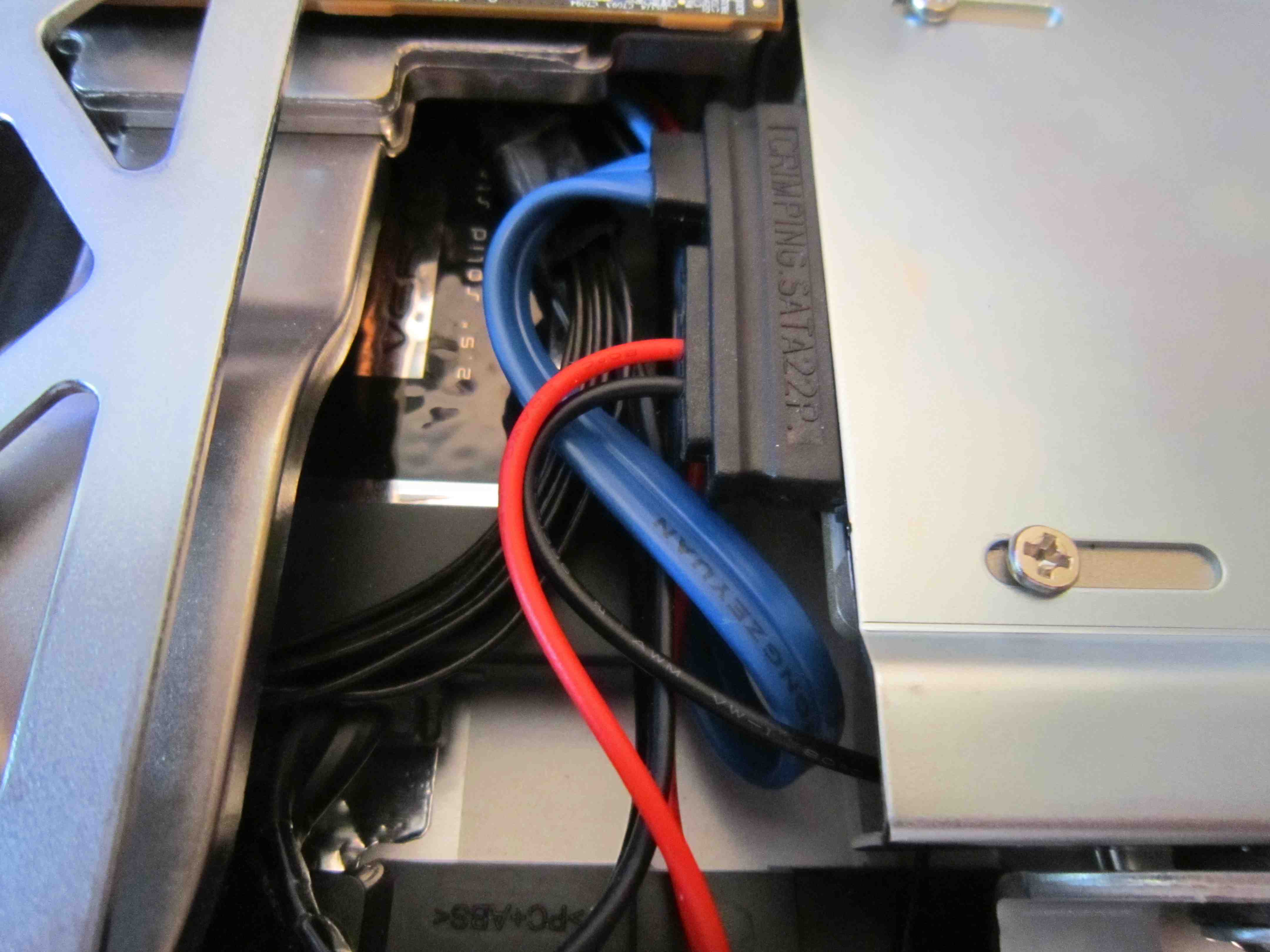

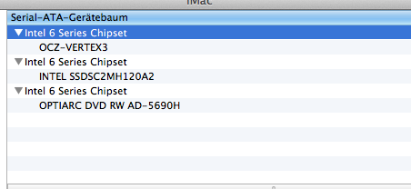

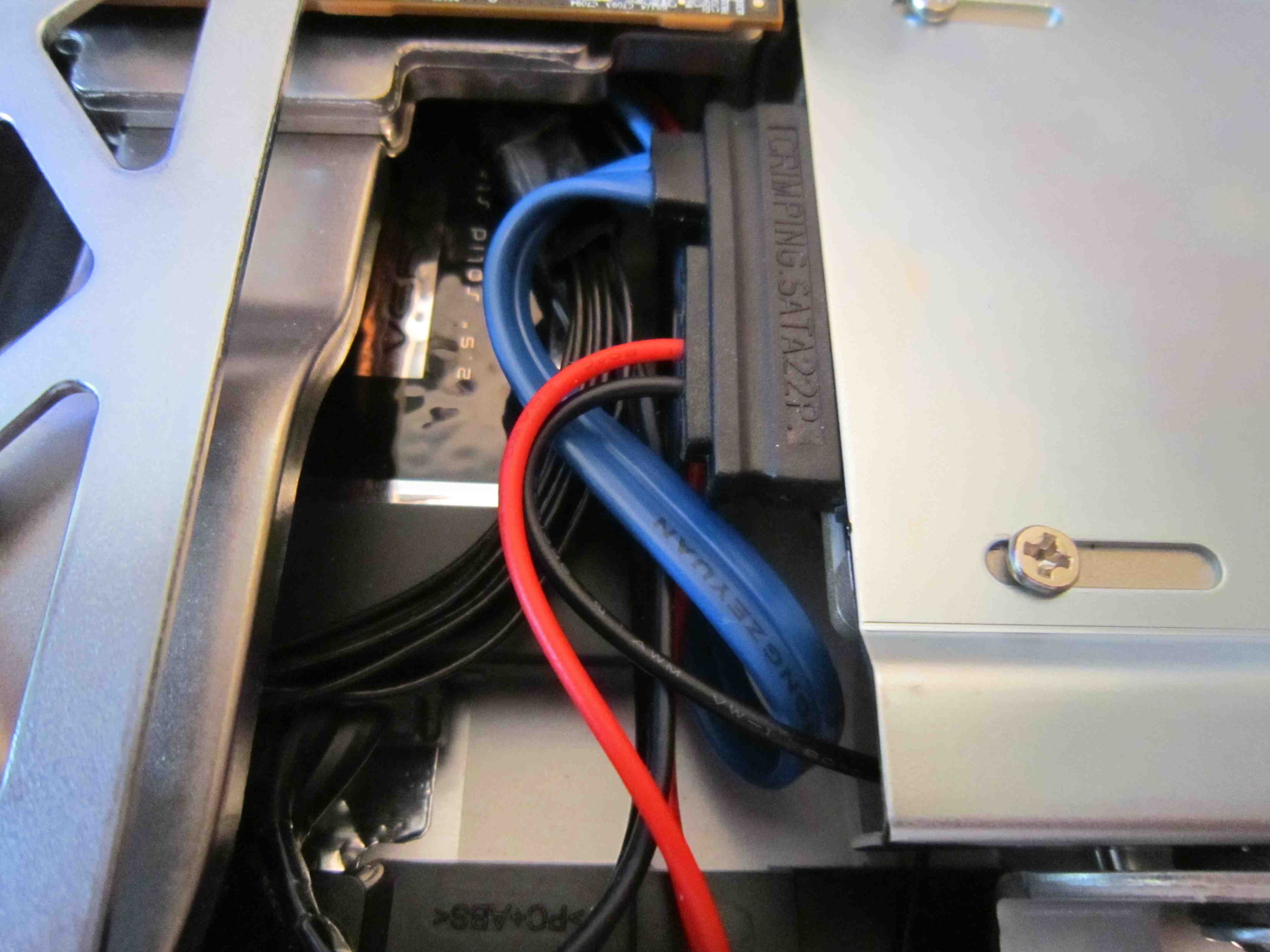

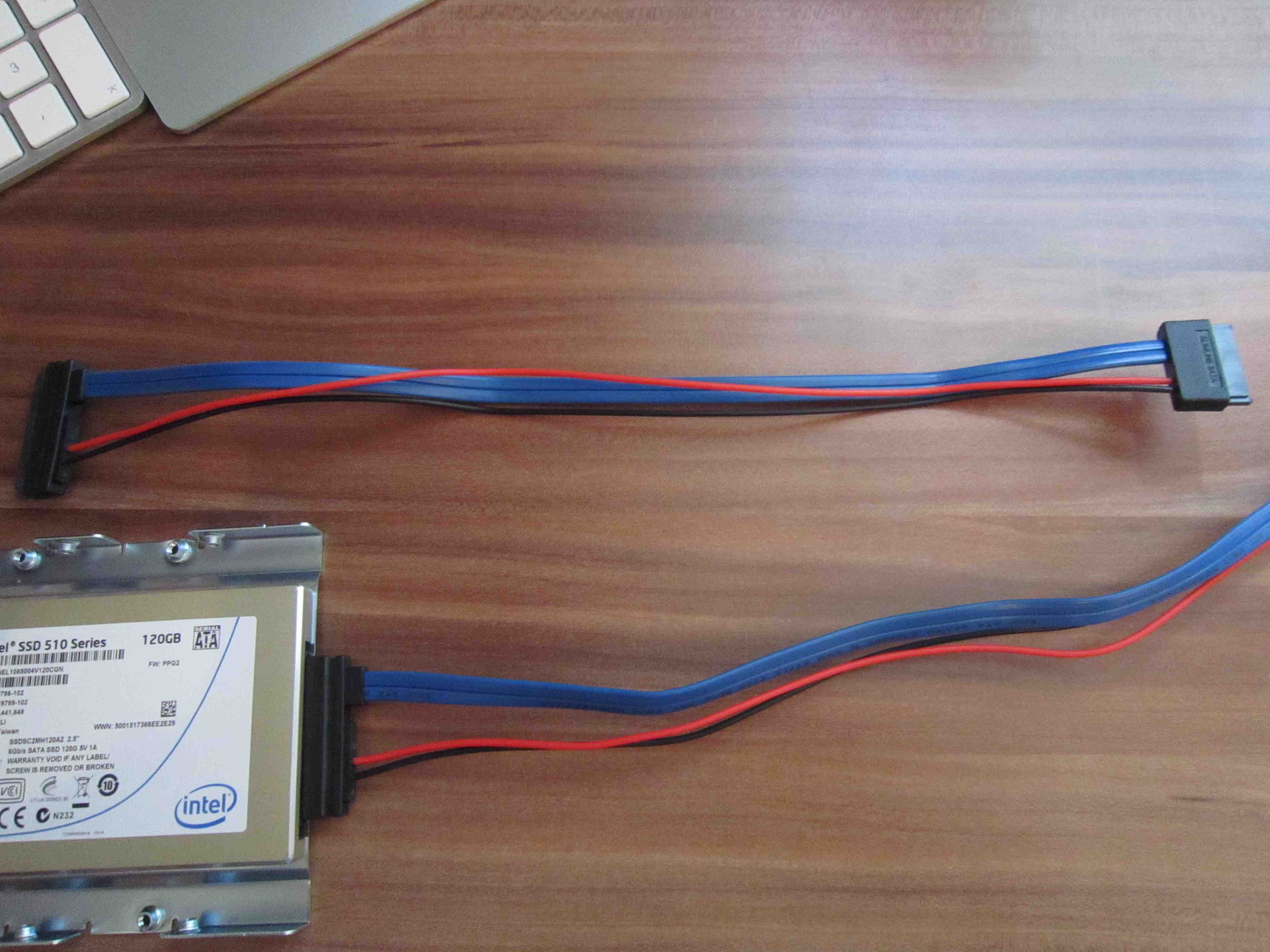

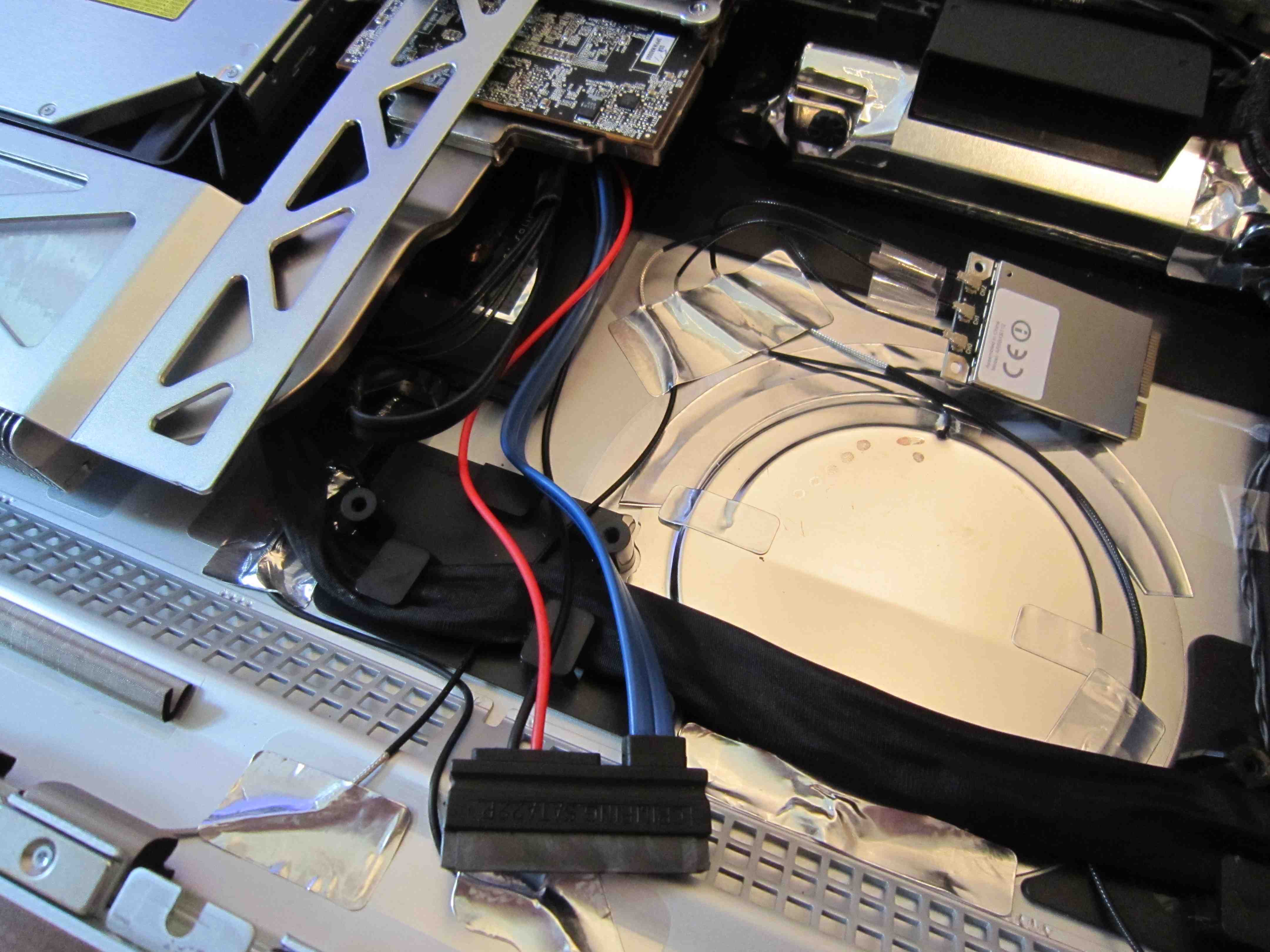

This is my configuration:
Port HDD: 240GB Vertex 3
Port SSD: Intel 510 120GB
Port ODD: CD / DVD drive
And NO fan problems.
