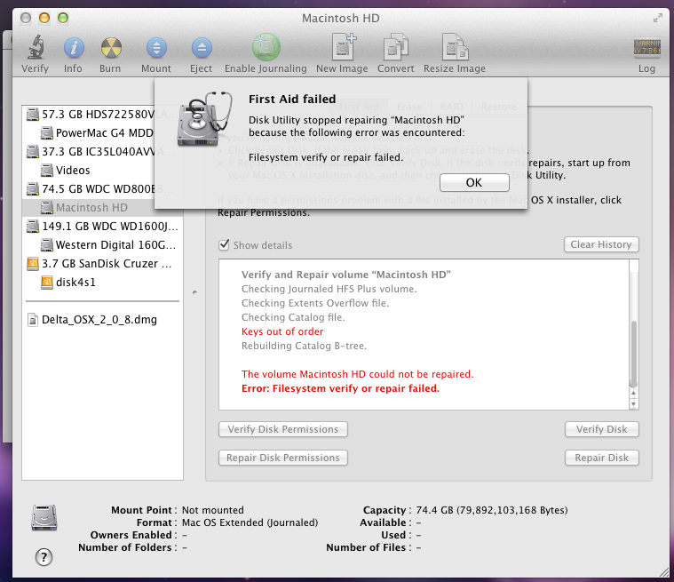

So as i posted in another thread my eMac stopped booting off its HDD. Well it still spins up so I put it in my MDD and i get this error both trying to repair or verify.....
What's this mean? It has nothing to do with the fact the HDD is hooked to my ATA33 bus does it?

As long as the drive isn't failing or bad, it should still work in the eMac once reformatted.

It's really weird The MDD sees the HDD even shows it in the boot menu, won't repair or verify it but sees it yet when I booted the Leopard DVD in the eMac the Disk Utility didn't even see the HDD at all. I hope this doesn't mean something on the eMac is to blame.....

I had this same error in Panther once.
There are two "trees" in the disk catalog. The A tree and the B tree. The B tree is a backup to the A tree. The "keys out of order" means that the tree has become corrupted. In this case it seems like the B tree, exactly the problem I had.
If you continue without repairing or reformatting the disk you will notice certain peculiar things starting to happen. I.e., you can't open certain apps, some apps close when you issue certain commands, etc.
Intell's advice to reformat is good. However, there is one other option if you have Diskwarrior 4 or above. DW4+ is capable of fixing this error. Versions below 4.0 though are not.
Ultimately I had to reformat and reinstall because we only had DW 3.x (something).

I don't have any disk repair utilities of any kind. I followed Intell's advice. Not only am I reformatting it, I also selected the "Zero" option and it is doing this task as i speak (which will probably take a long time on a ATA33 bus)

I had this corruption before. I could mount in Target mode and access all files but DU could not mount the volume reliably. Even DiskWarrior and TechToolPro gave up at the "Keys Out Of Order" error. Nothing for it but to wipe and start again.

Well the PowerMac did a successful Zero write and format. Drive appears to work fine. However I don't plan on putting it back in the eMac atleast now ATM i just don't have the ambition to tear apart my eMac on my day off. Seems the drive is fixed though.
