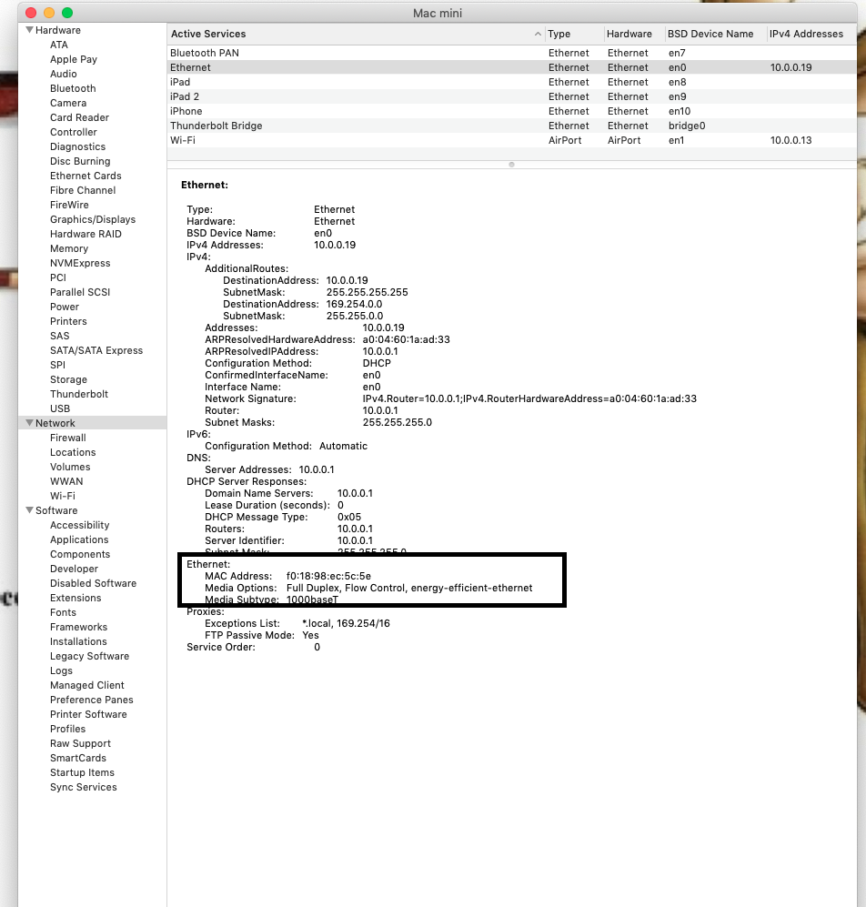

On the computer, click on "About this Mac" and then click/open "system report. In the system report, click on Network, then click on ethernet. It will show the speed down below. See picture.

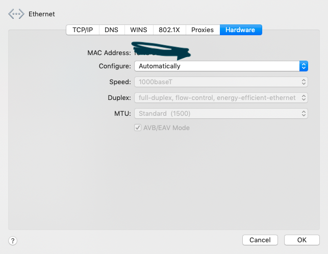

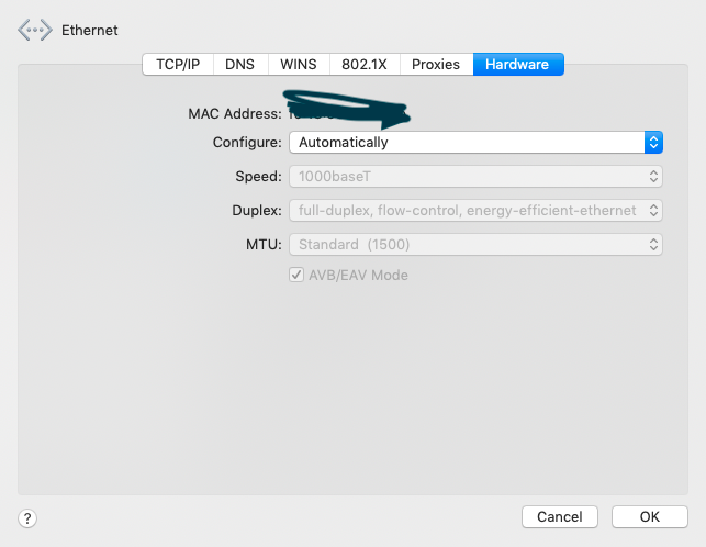

Look at the picture I posted earlier, especially inside the black box. My Mini has 1Gb ethernet which is listed as 1000baseT.
If the settings have been left as default (as from factory) then it should be set as automatic in the Settings/Network/Advanced/Hardware. See the link that jerkin posted you need help getting to the settings. Set at automatic should have it at the max speed of your interface, 1000baseT (1GB) for my Mini. If it is set to manual then you can change the settings to your liking. speed can be set at 10baseT, 100baseT, 1000baseT, or 10000baseT. 10000baseT will only show up if you have a 10GB ethernet port.
This is the correct answer. You have to change it to 10g on the network interface you’re using. It defaults to 1g if you’re on a 1g switch.
