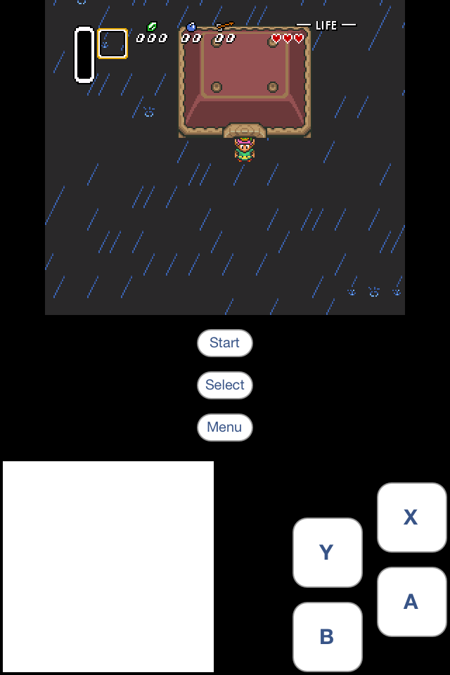

After the removal of iMAME from the App Store, I started searching for more emulators for iOS. I found SNES--HD- on github, but unfortunately it required a jailbroken iPad to run. Then, I came across a post by Spencer Nielsen with instructions on how to compile it for your own non-jailbroken iPad. (http://www.aorensoftware.com/blog/2011/05/23/play-snes-games-on-your-ipad-without-jailbreaking/)
I've taken his source code with his permission and modified it so it can run on both iPhone and iPad. Here's the link to the project on github:
https://github.com/iSkythe/SNES4iOS
If you're a developer, compile away! If not, I hope you're good friends with one 🙂
Changes from previous versions include:
•Sustain Button: a new button (looks like a circle with four arrows pointed towards the center) allows you to essentially sustain, or hold down a button without keeping your finger on the button. You tap the sustain button, it will turn orange, and then you tap the button you wish to sustain. For example, if you wanted to keep your character moving to the right, you’d tap the sustain button, then tap the right button, and then you can lift your finger off and it will keep going to the right. This is especially useful in platformers such as Mario games, as you can sustain the run button without having to hold it down!
•Both the Objective-C app code and the C snes9x emulator code are included in the same .xcworkspace file. It’s strongly recommended you use the workspace file instead of the individual project files.
•Since the snes9x code is now in an Xcode project, it can be compiled natively in Xcode via the included makefile. However, you MUST clean the pocketsnes target before EVERY build, or else it won’t build all your changes.
•Converted everything to LLVM 3.0! No longer need to use an old Xcode version to change the snes9s code!
•No longer crashes when loading a ROM (however, at this time it still crashes when quitting one).

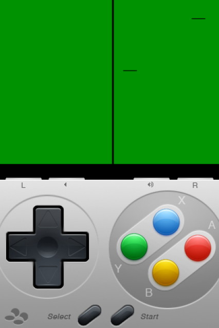

I'm not able to get anything when I launch any ROM. For instance, here is what happens when I get to the title screen in Zelda:
I've attached my Makefile that I've been using. Any chance you could compare it to your own?
Never had that problem. Neither with your original build nor with my own new front-end.
The problem I encountered while using the old 1.39 version of the SNES9X codebase was black screen in the outside map (screenshot of the same codebase as yours but with a rewritten controller UI):
But that is fixed by updating the codebase to SNES9X 1.53. It got slower, though.
I'm not using a makefile. I'm building directly from within Xcode. Didn't you post a working Xcode project yourself earlier in this thread. I was building from that before I ported 1.53 over and started anew with it.
But looking at your makefile I see its build flags are almost the same as mine in Xcode with the notable exception that you're specifying -O3 when I said earlier that the emulation code breaks if you apply any optimization at all to the code while building with Apple LLVM (clang). Change -O3 to -O0 and it should go back to working.
That was it! I had changed the Optimization level in my Xcode project and Target, but didn't change it in the makefile. The reason I'm using a makefile is because Xcode can't natively build the emulator code, so I created an Xcode project which uses the supplied makefile to build.
Now, GCC is no longer needed to build the emulator OR the project! This will make it much easier for newcomers to build 🙂 I'll upload the master branch on github shortly.
