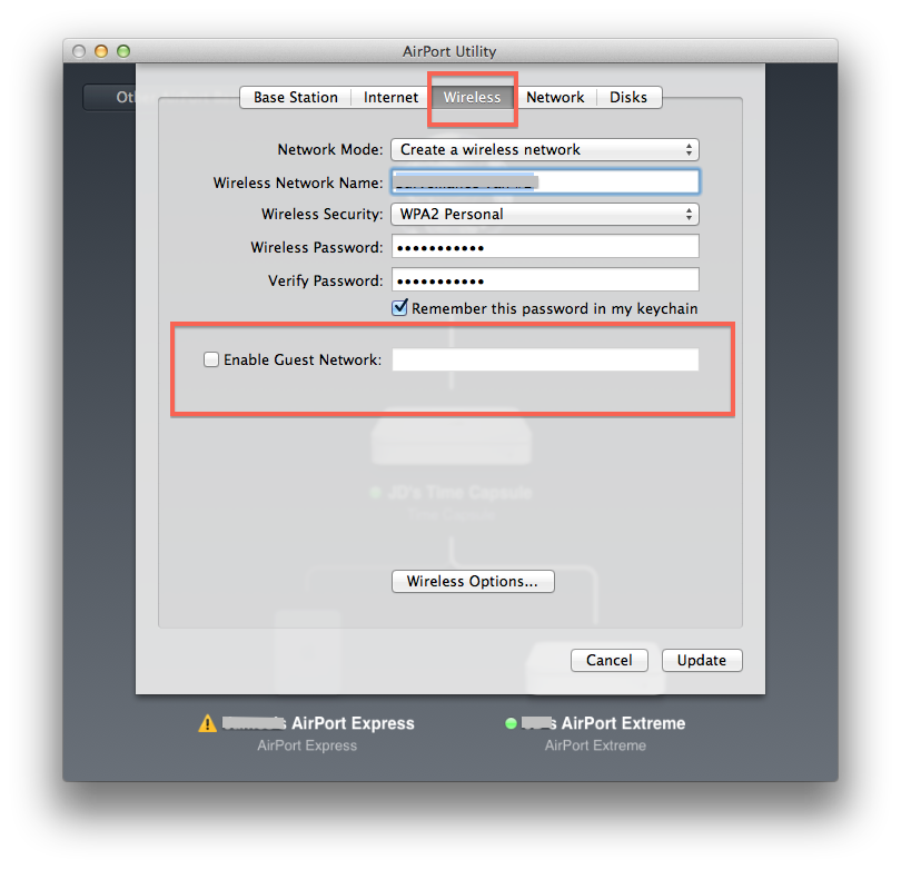

The guest network option should not be hidden at all under Airport Utility.
You should be able to find it by
Opening Airport Utility -> (do you have latest version of Airport Utility installed?) Airport Utility 6.1
Click Edit for your Airport Extreme ->
Go to wireless tab ->
Check to Enable Guest Network and name the network

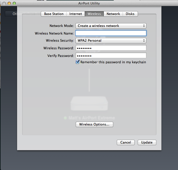

I don't see that. Here is a shot of what mine looks like:

I am running the latest version:
6.1 (610.31)
I am partially there. Under the Network tab is the Router Mode setting. This was set to "Off (Bridge Mode)". I changed this to "DHCP and NAT". Once it updated, I now have the guest network option. Although I'm not exactly sure what the differences are between these options, and the light on the router is now blinking amber color.

Yep; I actually figured it out last night. Under some Advanced area within the Admin area of the modem/router combo, I found a Routing and NAT setting. I disabled this, unplugged/replugged the modem/router. After that, I was able to do Routing and NAT on the AirPort Extreme and everything worked just fine.
