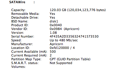

Can someone tell me if I have Firmware Version 1.08, I assume version is the same as revision?
And is 1.15 the latest? OWC'z website is a little hard to decipher. Thanks
Oh...right. Yeah I am looking under version. Where do I check to see what "revision" the firmware is?
I'm thinking that must be it, I'm just not sure.
