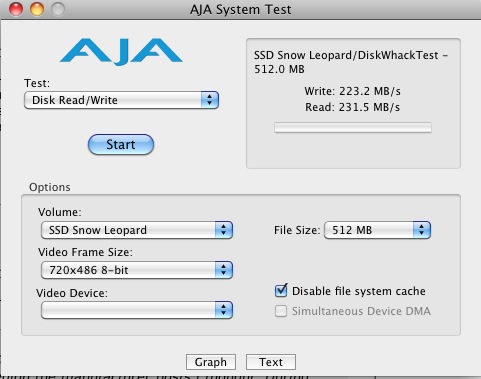

My advice is, try another speed test tool like AJA System Test and see if you get other results. On xBench I'm getting similar results as you do...

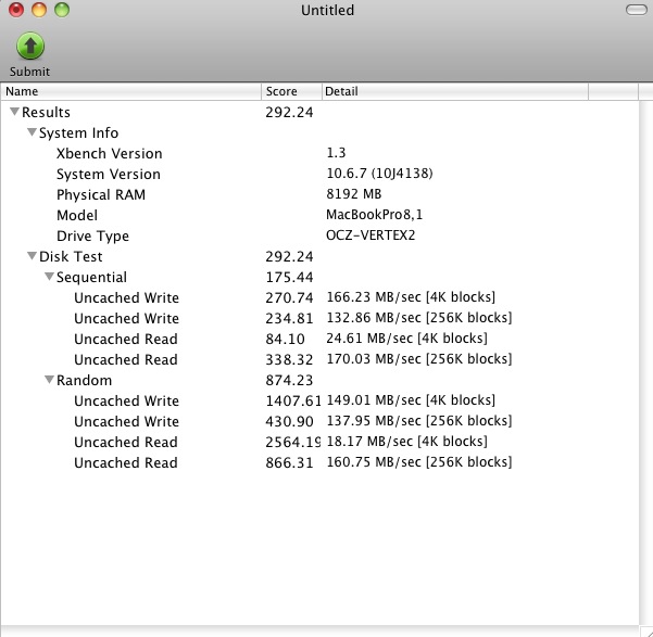

I wanted to upgrade my Vertex2 on my 2011 Macbook Pro 13" to a Vertex3 because the specs (read/write) of the SataIII Vertex3 SSD's seem so impressive, yet I get the feeling that I wouldn't see much of a difference in general real world performance?

You won’t. Is there anything you’re doing that requires that much speed? Majority of people won’t notice a difference between Vertex 1 and Vertex 3 because they don’t anything to take advantage of the speed. The app’s launch speed is determined by the latency first, not entirely by the actual sequential read/write speed.

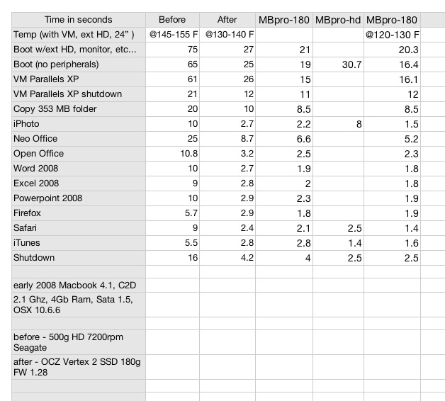

You can see some speed differences from a Sata-I bus 2008 Macbook 4.1 and regular Hard Drive (first column) , to a Vertex2 SSD in the second column.
Than in the last column you can see the speed difference going to a 2011 Macbook Pro 13" with a Sata-III bus with a Vertex2 SSD and 8 gig of ram.
These are my numbers...
I/O Transactions
Frame MB/sec
Read Write
00.0 447.3 488.0
01.0 528.2 494.6
02.0 529.7 321.0
03.0 529.2 479.9
04.0 529.8 490.9
05.0 529.0 482.0
06.0 529.1 486.4
07.0 530.9 499.7
08.0 530.8 485.7
09.0 528.3 496.3
10.0 527.3 482.5
11.0 527.9 491.5
12.0 527.3 482.9
13.0 527.8 484.0
14.0 529.9 490.9
15.0 531.4 488.1
16.0 527.6 329.5
17.0 529.6 485.8
18.0 531.0 487.6
19.0 530.4 483.7
20.0 526.9 494.0
21.0 529.8 484.9
22.0 528.3 486.8
23.0 529.7 481.7
24.0 530.9 492.2
25.0 528.9 488.5
26.0 528.1 498.3
27.0 527.9 485.5
28.0 525.2 490.6
29.0 526.8 321.1
