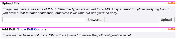

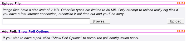

I have two "help" images inside table cells along with text. I have style="vertical-align: text-bottom; float: right;" inside each of the <img> tags, but they aren't doing the text-bottom part, as you can see here (pink lines added for clarity):
Any ideas? 😕
I've tried it every which way and it still doesn't work. I've moved the vertical-align style to the table cell, and text-bottom still doesn't work.

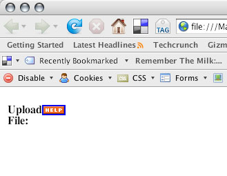

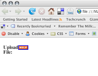

It would appear that you are only including a portion of the CSS associated with this page.. as when i copy/paste your included code into a document i get this.. { see attached image } which doesnt quiet look like the problem you were showing.

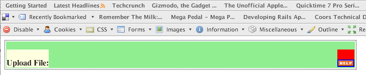

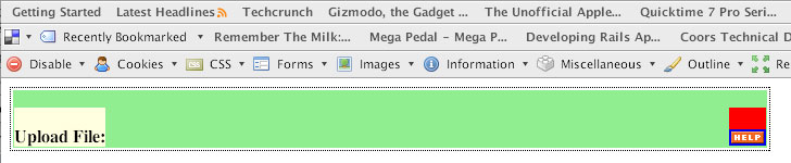

Ok. I am providing a solution based off of what limited code i you shared. Hopefully this will work out for you.
attached are a zip of the HTML and a jpg of what it looks like.
for others interested code looks like this.
