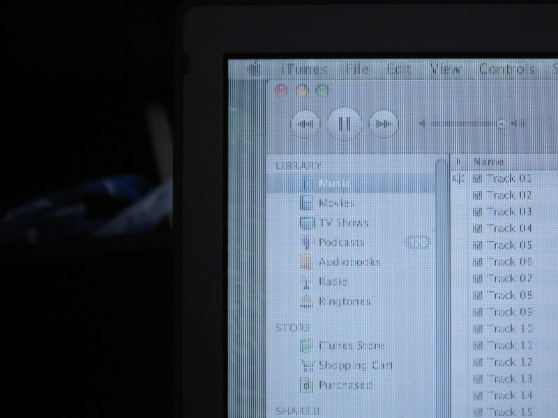

I've had it sent into Apple once for the horizontal flashing lines, but these are new... it's like a gray vertically striped film covers the whole screen, and unlike the horizontal lines, shaking/hitting the screen does not help. Here's a photo:
Any suggestions? It usually disappears within 5 minutes; it happened once last week.
It might be time to have Apple take a look at it again. It doesn't sound like the display cable either.

Almost looks like half the pixels are missing. . .

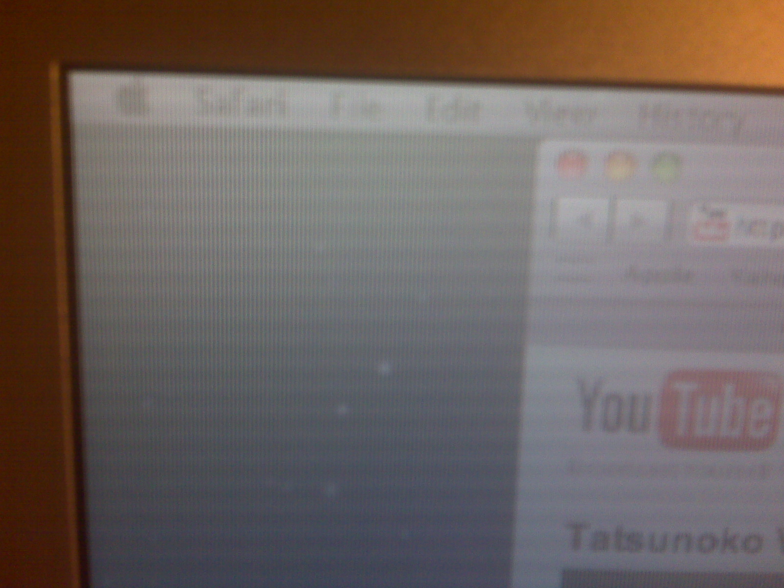

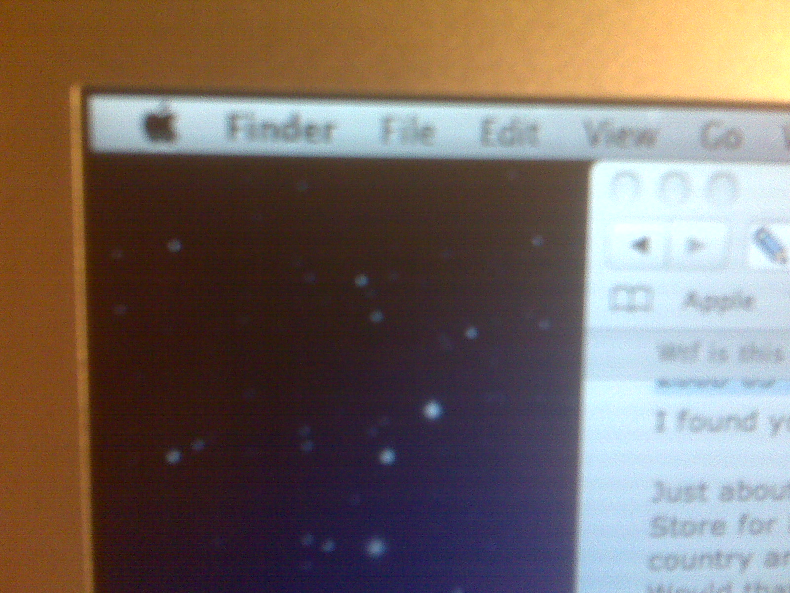

I'm experiencing the exact same problem as well. In mid-July, I took my Macbook Pro (2.2 GHz SR 2007 July) in to get the LCD replaced since it was exhibiting this strange 'ghosting' effect where the LCD panel wouldn't refresh at the correct intervals. Paid out of pocket over $300 dollars for the repair since the AppleCare warranty had already expired
Got the laptop back, all was well until early September when I noticed the same vertical scanlines that the OP had posted earlier. However, I wasn't strictly just grey vertical lines, but often changed to different colors (red, green, etc.) The LCD would randomly do this, and fix itself after a while. Took it to the Apple Store again and they said they'd replace the entire LCD panel for free (since repairs performed by Apple have a 60-day warranty with them). Waited another week for the repair, and got my laptop back on the 22nd this month.
Once I headed home, I decided to do a clean install of SL, and during the installation process, those damn grey vertical lines on the LCD showed up again. Yep, back to a genius bar appointment this Friday 🙁.
Based on what I've seen, it seems like the problem is not just the LCD panel, but something else internally. They replaced my LCD panel twice for each repair, but it still hasn't fixed this problem. I initially suspected it might have been one of those faulty Nvidia 8600M cards, but when connecting to an external display while the vertical lines appeared on the laptop's screen didn't have any effect on what was shown on the display. Also, at both instances at the Genius Bar, they have their own diagnostics to verify a faulty Nvidia card, which turned out negative for both cases.
Like the previous poster said, it might be more than a wiring problem and stuff. I attached comparison pictures (from my crappy BlackBerry camera) of my vertical line defect below, which is exactly like the one from OP. Anyways, hopefully this next repair will really fix it.
