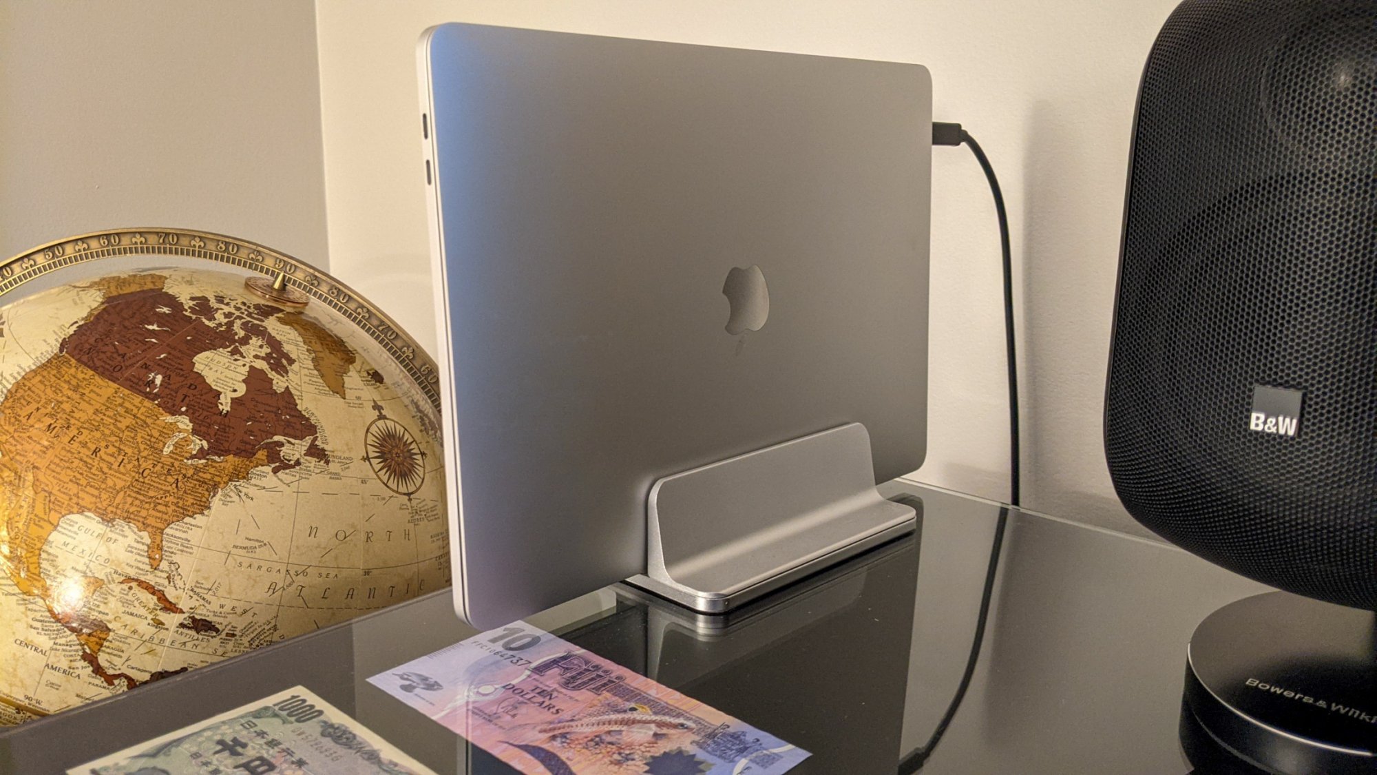

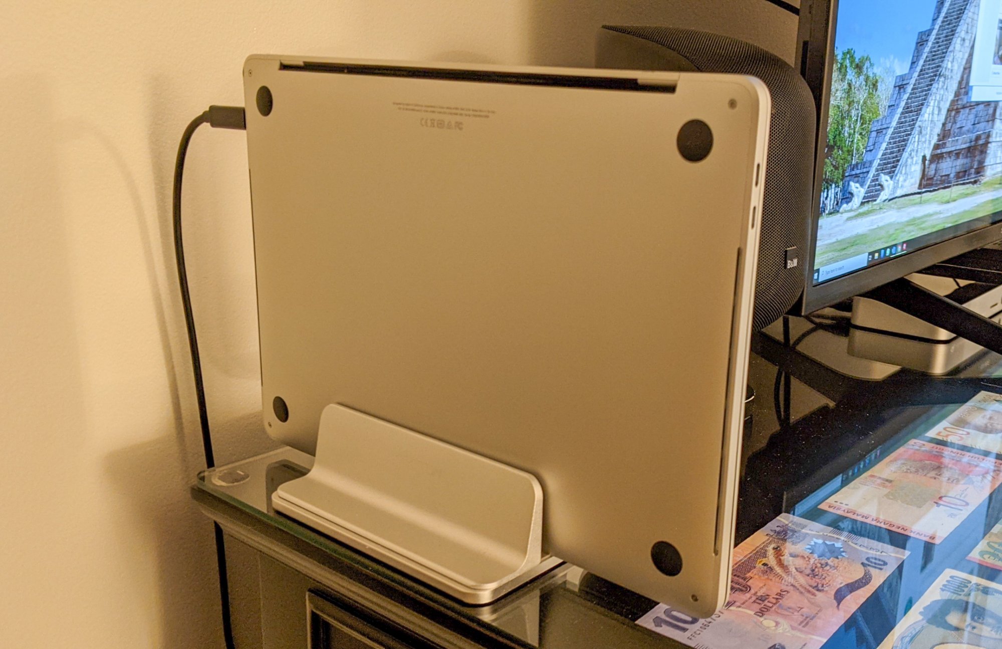

I've used my computers, both PCs and Macs, in clamshell mode for years without any known problems. Since heat rises and the exhaust vents are at the back of the device, vents should be at the top. These photos should be self-explanatory. Hope this helps.

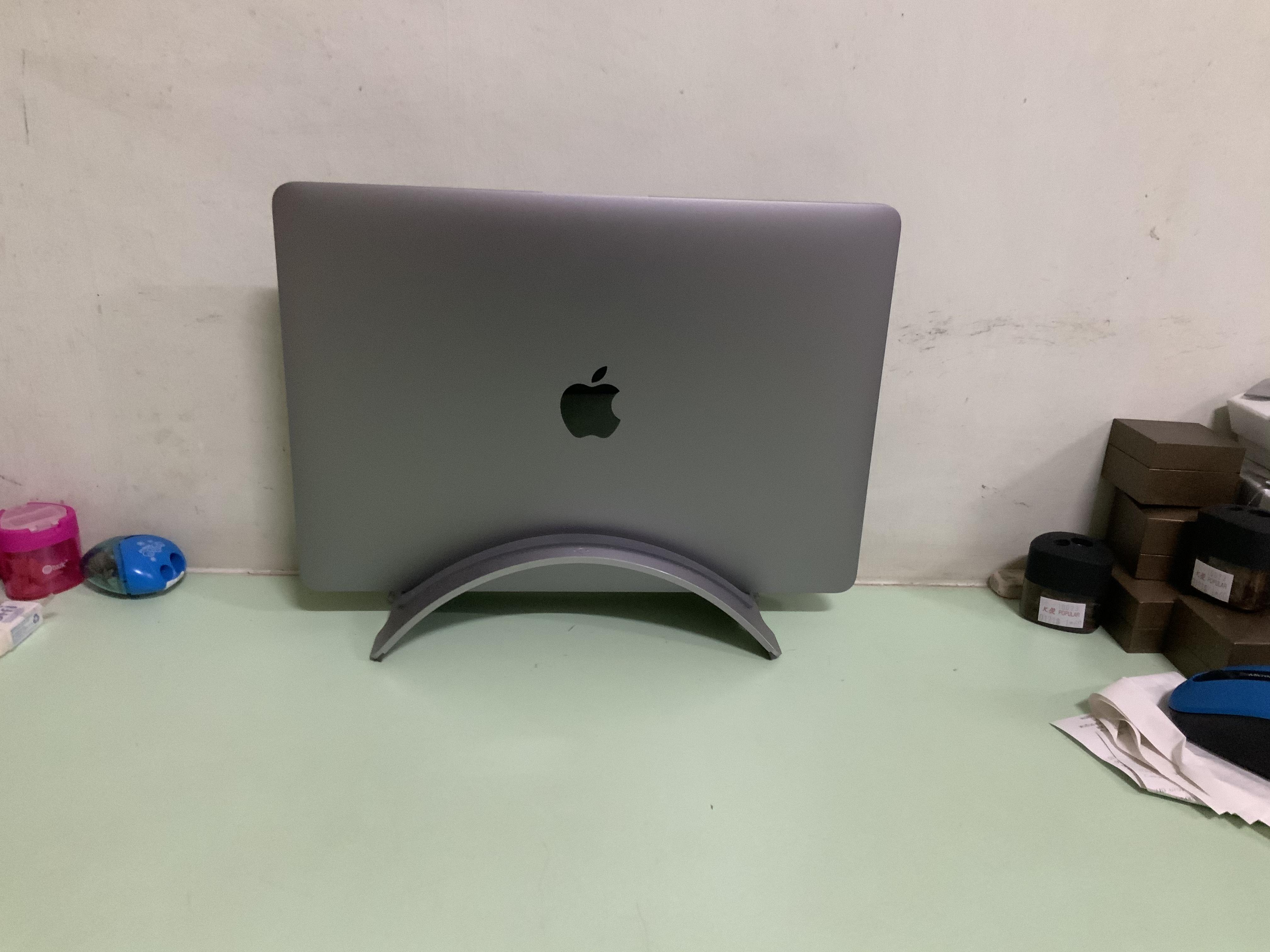

I've used the Twelve South BookArc stand for my 2016 13" MBP pretty much since I bought the laptop day-one, so almost 5 years now (maybe 60/40 in closed clamshell mode). During COVID work-from-home the past year, it's been more like 95/5 in closed clamshell). I've always used it hinge-down with no issues whatsoever.
I don't disagree with some of the posts above that with fans towards the hinge, logically seems optimal to have hinge up. But aesthetically (Apple logo right-side up), and cables a little tidier being closer to the table, just my 2 cents that I don't think it makes a big enough difference one way or another. Now maybe if you stress your laptop a lot more when you use it so more heat generated / fans on more frequently, it might matter more, but for my normal use (fans rarely on), I don't think it matters much. So for me no issues doing hinge down for the slight aesthetic benefits.
