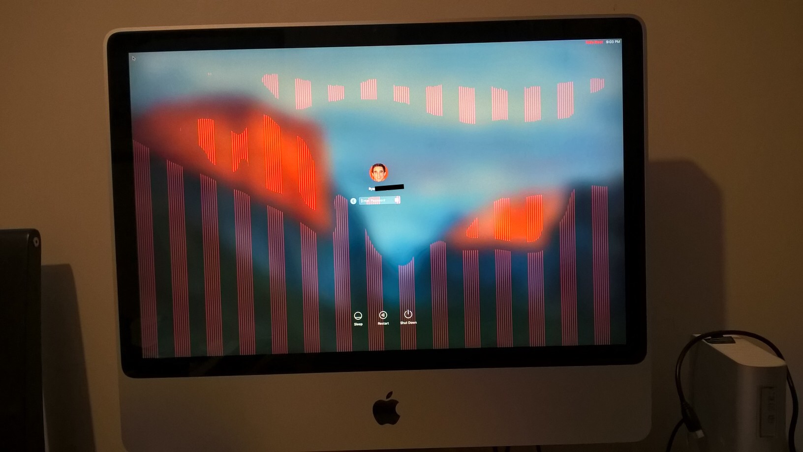

Hi,

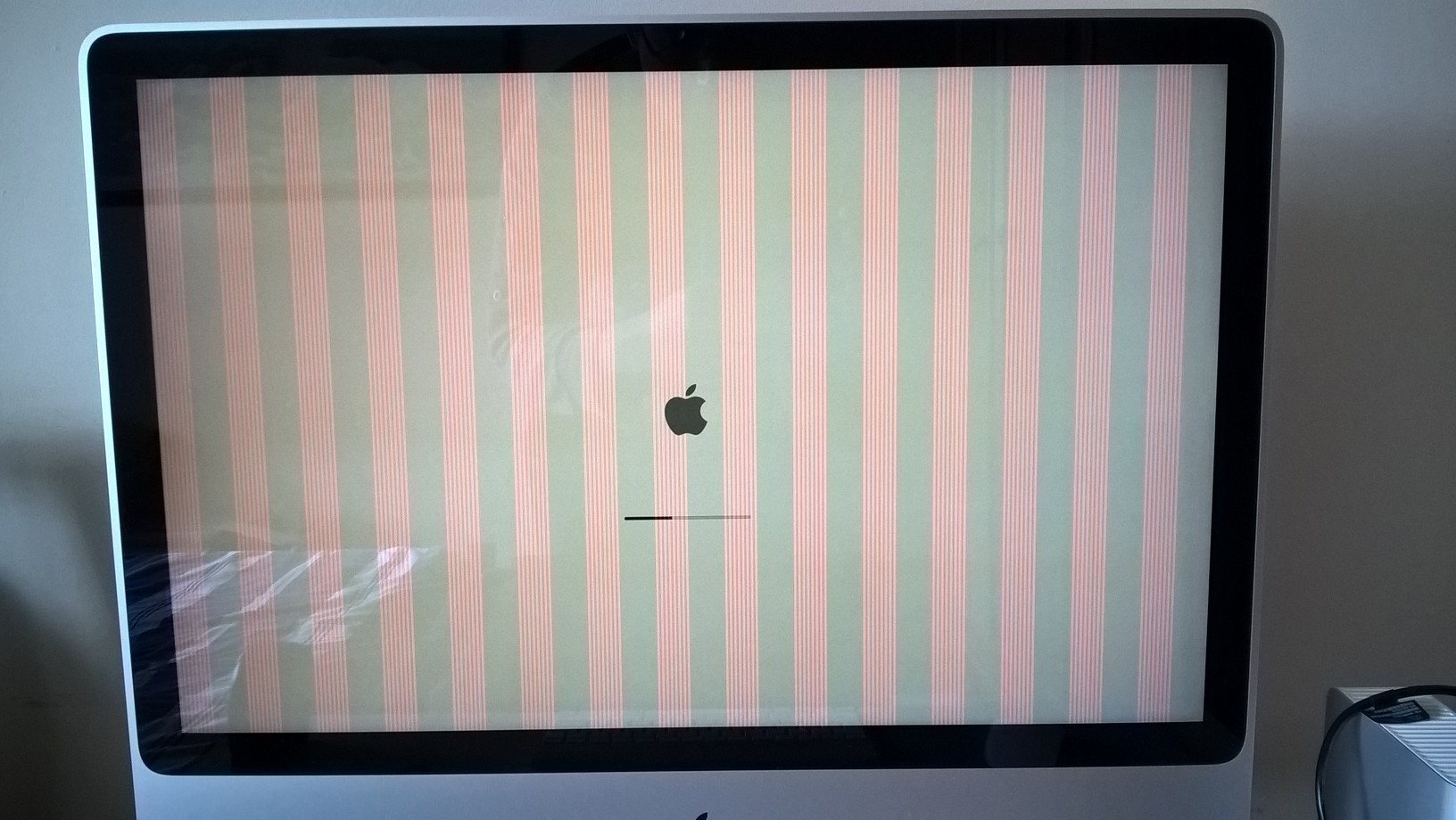

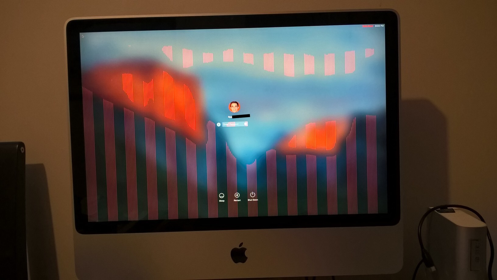

Last night I woke up and logged into my Mac (see signature) after 15 or so minutes sleep and resumed watching a video on YouTube. A split second later the screen froze and tiny faint squares filled dark areas of the screen. The mouse cursor was the only thing I had control of. I turned off the Mac, restarted it and saw this:
Once the progress bar reaches halfway the stripes disappear however the Apple logo and bar do not return either. This is as far as it goes.

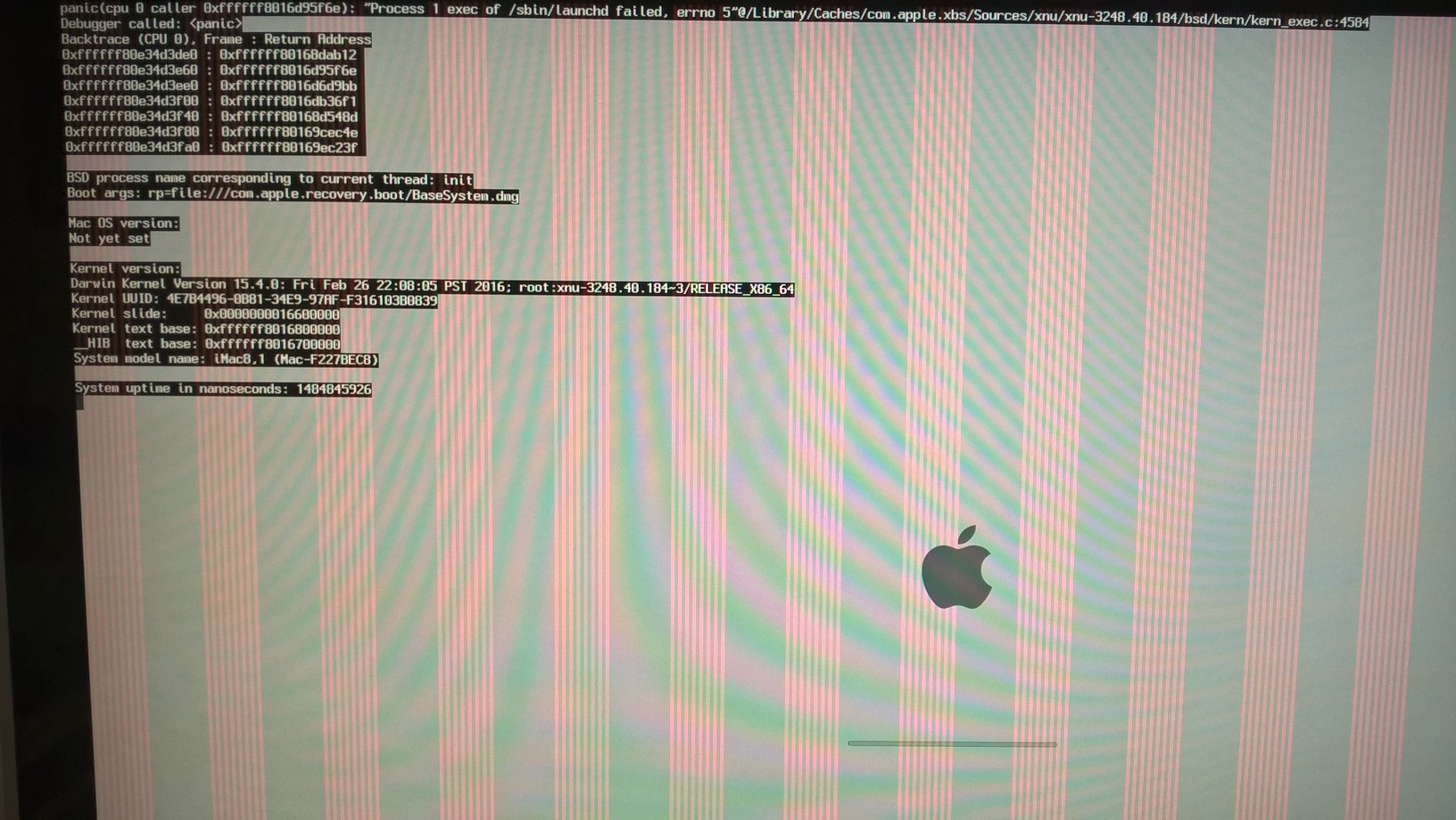

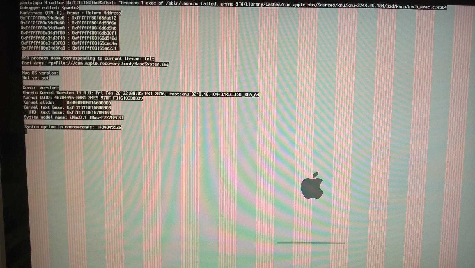

I tried to boot into the recovery disk but the computer crashes and restarts. Text pops up before the Mac crashes:

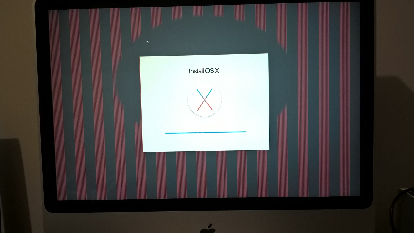

I then inserted a USB install drive of El Capitan in order to access Disk Utility, run First Aid and find out if there is an issue with the SSD. There wasn't. The vertical stripes persisted:
EDIT: I forgot to add that I tried to boot into my Boot Camp Windows 10 partition, however all I saw was a black screen. No load up. Nothing.
Next up was Apple Hardware Test on Disk 1 of the 10.5.2 install DVD. No problems were detected on the first short test, however the program stopped eight minutes into the long test. I waited 30 minutes but nothing happened. The stop test button was unresponsive too. The stripes are still there.
I performed the SMC and PRAM resets, tried to log in but got the same results as before.

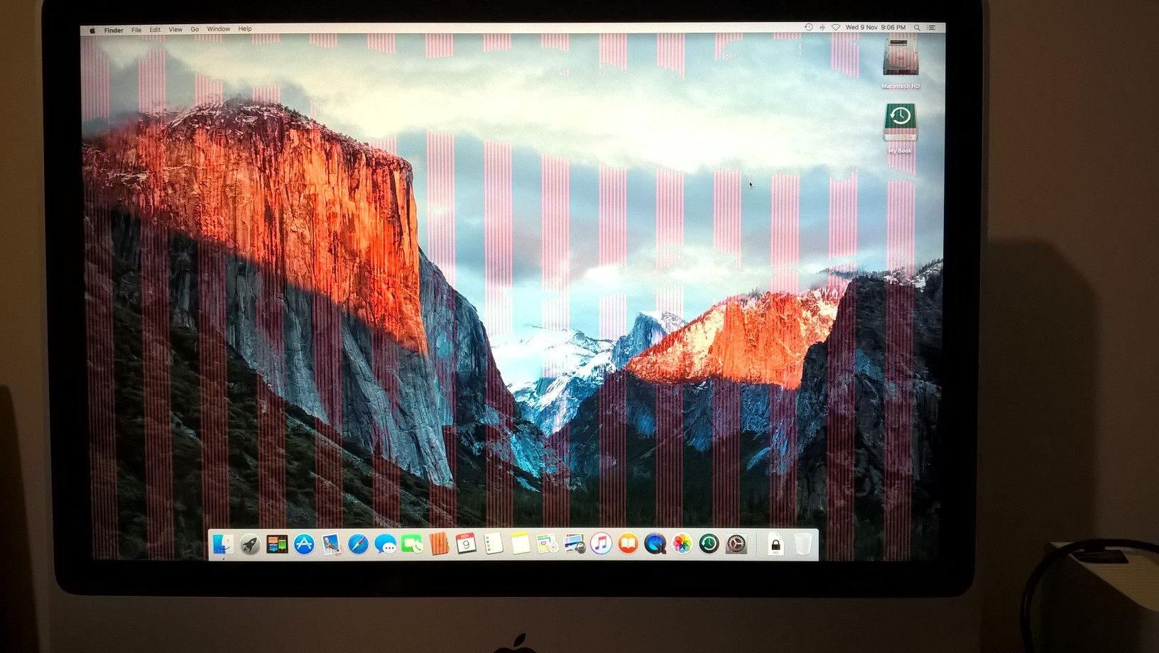

Last step: boot into Safe Mode. It worked but the vertical stripes remains:
As you can see, the stripes does not show up on white backgrounds and the bright portions of the screen. General performance is slower (more like dropped frames) and internet browsers slowly refresh each time there is movement. Viewing log files in the Console I see the name of the graphics card pop up - ATI Radeon X2000 (FYI it's an ATI Radeon HD 2600 Pro 256MB). Some log files are labelled spin, panic and (vaguely IIRC) hold or wait.
Basically, I have no idea what's wrong. It's not the SSD. The GPU could be on the way out or the logic board chucked a wobbly. It might be a kernel panic too.
What are your thoughts and what should be my next course of action? Your help and expertise would be most appreciated.
Cheers. 🙂
Reactions: macak6
A failing GPU is the cause of your problems most likely. The 2008 24" iMacs are prone to GPU failure, but luckily it can be replaced if you manage to find the special GPU it takes for a decent price.
Reactions: mcrazza
Yeah, that's what I thought first. Why or how would a GPU failure affect the boot up process? At this stage I'm in between a kernel panic and failing GPU.

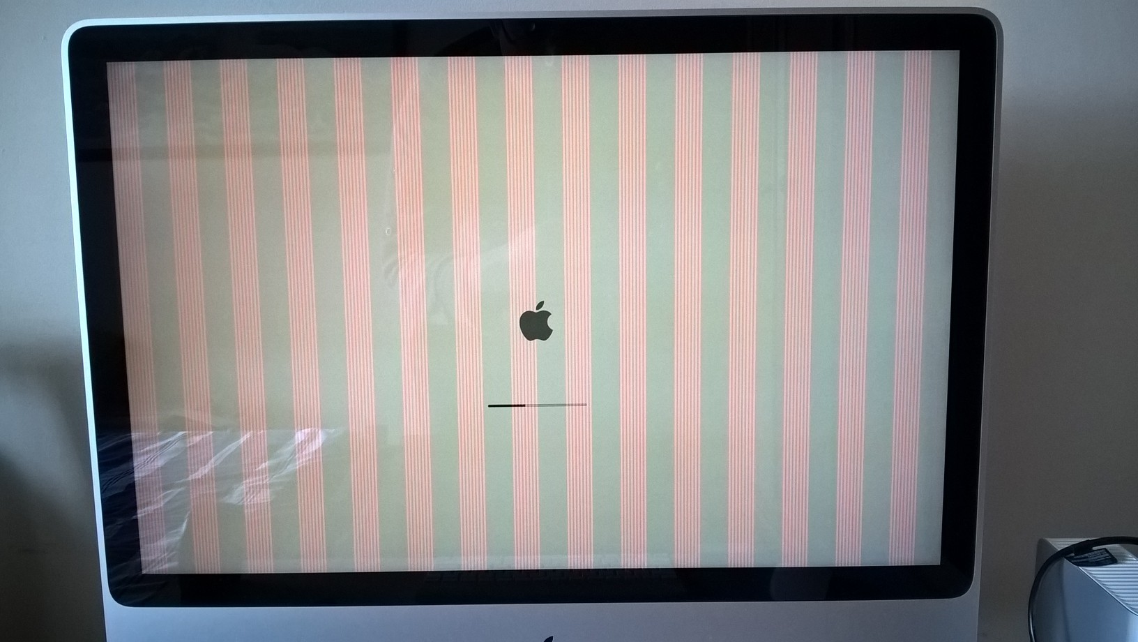

Thanks for taking pictures. I have precisely the same pink bars you have and and the booting problem hanging in the middle of the progress bar with my Mac Mini 2011.
Interestingly this problem occurred several months ago and corrected itself after leaving it on overnight with the bars on the screen. In the morning the screen was white again and it booted fine and worked for a few months. Then again a few days ago the pink vertical bars appeared again during power up and the progress bar again gets stuck about half way during the boot cycle.

If you haven't fixed it with a wipe of the system and clean install, then it is your gpu. As your iMac predates 2011, it is almost certainly time to think about a new iMac or the iMac Pro.
Thanks for posting your story, and the pictures. I'm running into this issue with a 2011 MacBook Pro laptop running whatever the latest Mac OS X is as of today.
If the machine is booting, there is a bit of software called gfxCardStatus that lets you disable the discrete GPU who's failure causes the problem, and might help to diagnose. However, the problem can be very intermittent at first (unfortunately, it gets worse).
My 2011 17" MBP had the GPU fail once, years ago, when the free repair program was still running, so it got a new logic board. Unfortunately, the root cause of the problem - a design flaw in the way the GPU was soldered in - was never properly rectified, and the replacement program is over.
Yesterday, the glitch re-appeared on my MBP - its back for the moment, but the machine probably shouldn't start reading any long books 🙂 Fortunately, its not my primary machine any more and seven-and-a-half years is a fairly good innings for a computer... but its frustrating, because otherwise its still a perfectly good machine.

Hi everyone,
Unfortunately this just started to happen to me as well. After seeing this thread, I googled “fix MacBook Pro GPU” and discovered that there is a potential fix, though it may not last forever. Basically you need to bake your motherboard. At 190C/375F for 7 minutes, according to the recipe I found.
This actually isn’t completely loony if you think about it. I guess the idea is to melt the offending solder just enough to reconnect the GPU chipset to the motherboard.
Of course, you’ll need to know how to extract the motherboard yourself, which means you need tools and skills required for this. Irrespective of whether you think you have the skills and tools, what you do to your motherboard. Anything that goes wrong along the way is entirely your responsibility. I am not recommending this solution — I haven’t tried it myself yet — I’m just passing it on as avenue of investigation, and I will not be held responsible for anything bad that happens to your Mac if you try this. Even if you make no goofs whatsoever.
If I try this, I’ll update you. If you try it, then the very best of luck to you (read the disclaimer above once more, though). I’m sure we’d also love to hear your results.

I saw this old thread while googling a solution for a similar issue - my mac mini would not boot at all, after the apple logo the screen will go dark and come back up as a frozen white screen with subtle vertical lines.
So if anyone comes here still looking for a solution, I managed to fix mine today after taking it apart. The thermal paste on the GPU chip / heatsink was very brittle - cleaning and replacing that alone most likely would've fixed my issue, however I went one step ahead and used a heatgun on the chip for a couple of minutes to reflow it. Baking the entire board seemed a bit overkill since it's clearly the GPU chip alone causing the problem.
