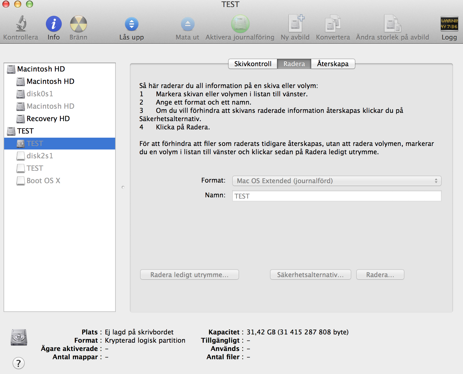

I think I'm failing to explain myself in English in this case. What I seem to have done is to set a password using Time Machine in order to 'code' my data. It is not that the hard drive has a password but the data in it does. Whenever I connect the hard drive to my Mac a window prompts me to enter said password so I can't even see the hard drive on my Mac. If I open Disk Utility all I see is the hard drive I'm having problems with but I'm unable to format it from there as it ask me for the password too. It's weird because as far as I knew, setting the password was for protecting my backup information to be loaded into another Mac? I'm new to the Mac environment so I may be saying some nonsenses...
PS. This is the information I got (sorry is in French):
Nom*:
Type*: Partition logique chiffrée
Point de montage*: Non monté
État du disque*: Verrouillé
Capacité*: 999,49 Go (999*491*063*808 octets)
It says the disk is 'locked' and also that it is encrypted. That's the word I was looking for. I set a password to encrypt my data.

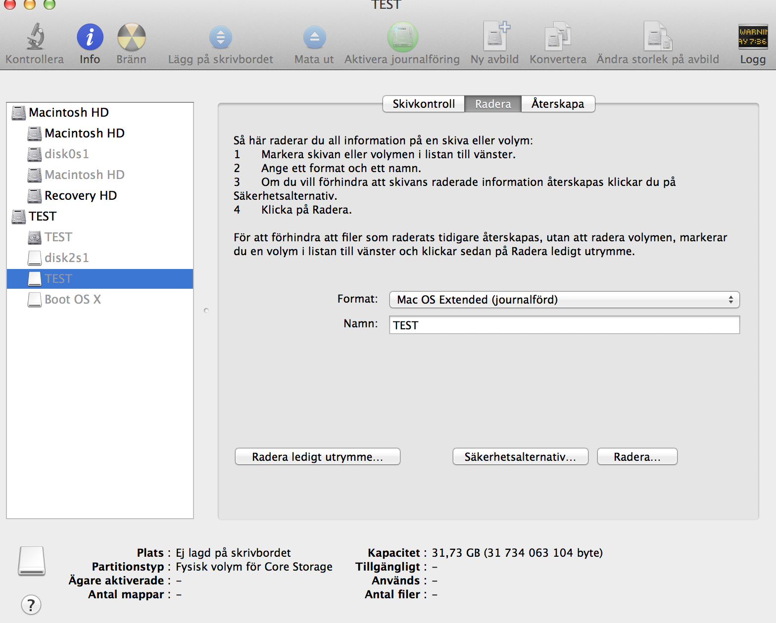

The built-in protection in Disk Utility stops you from erasing un-mounted drives...
to erase an encrypted drive you need to enable Disk Utility´s Debug mode:
kill disk utility if open, in terminal: defaults write com.apple.DiskUtility DUDebugMenuEnabled 1

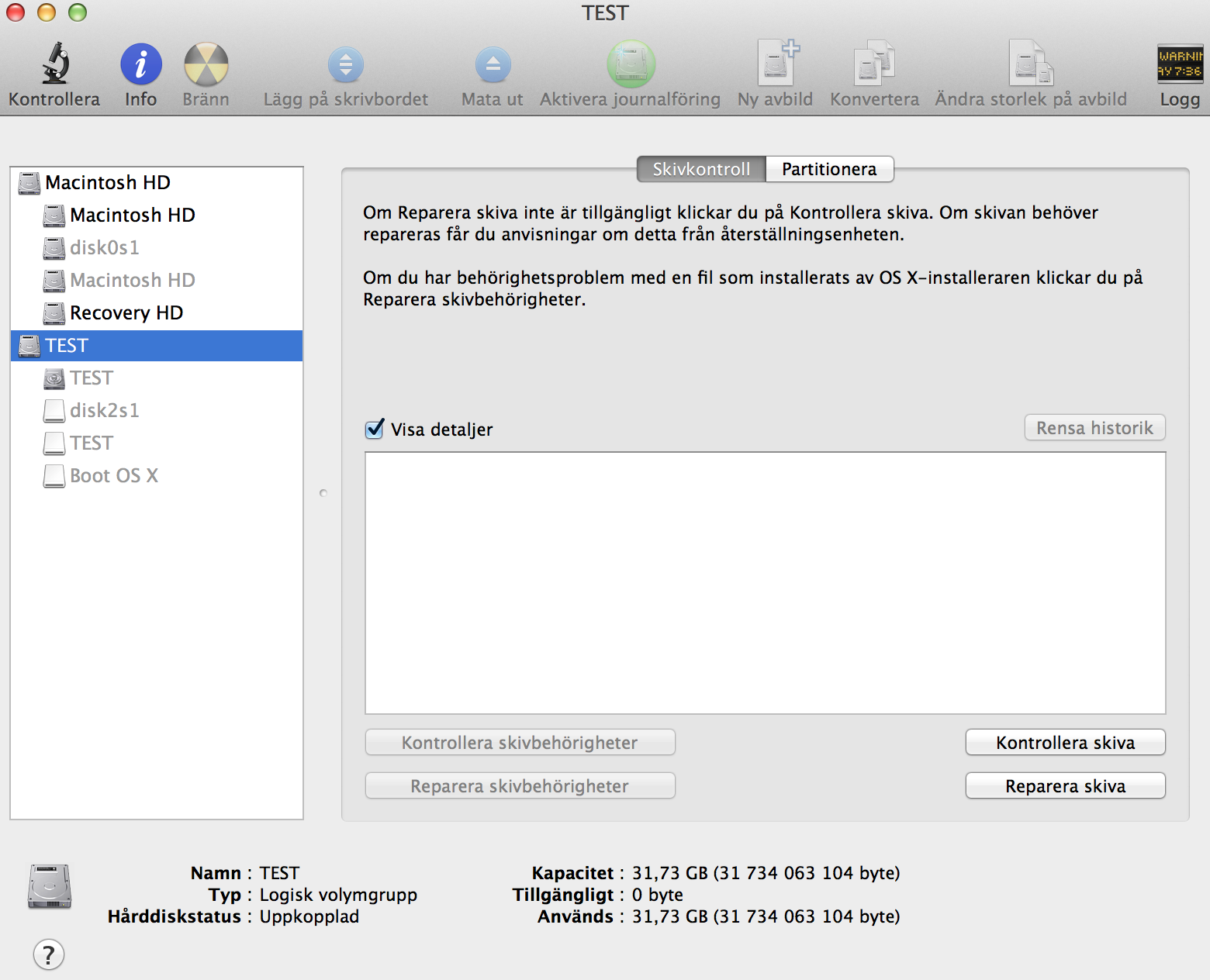

now all you have to do is destroy the Core Storage Volume (has the same name as main volume)
and voilá your disk is free...
EDIT: and by free I mean you can erase it 🙂

If a drive is encrypted using disk utility (as Time Machine does to external HDDs) as an extra protection the drive cant be erased in disk utility...
you can not mount the drive without the correct password, meaning you dont have access to the drive... unless you use debug menu
there is still no way to get the encrypted data of the drive, but you can erase it

I think there is a new menu for you ontop "Debug", and there you can choose "show all partitions"
now if you destroy the Core Storage volume, the disk is rendered useless and you can erase/format it.. be careful though, debugging tools are powerful 😉
