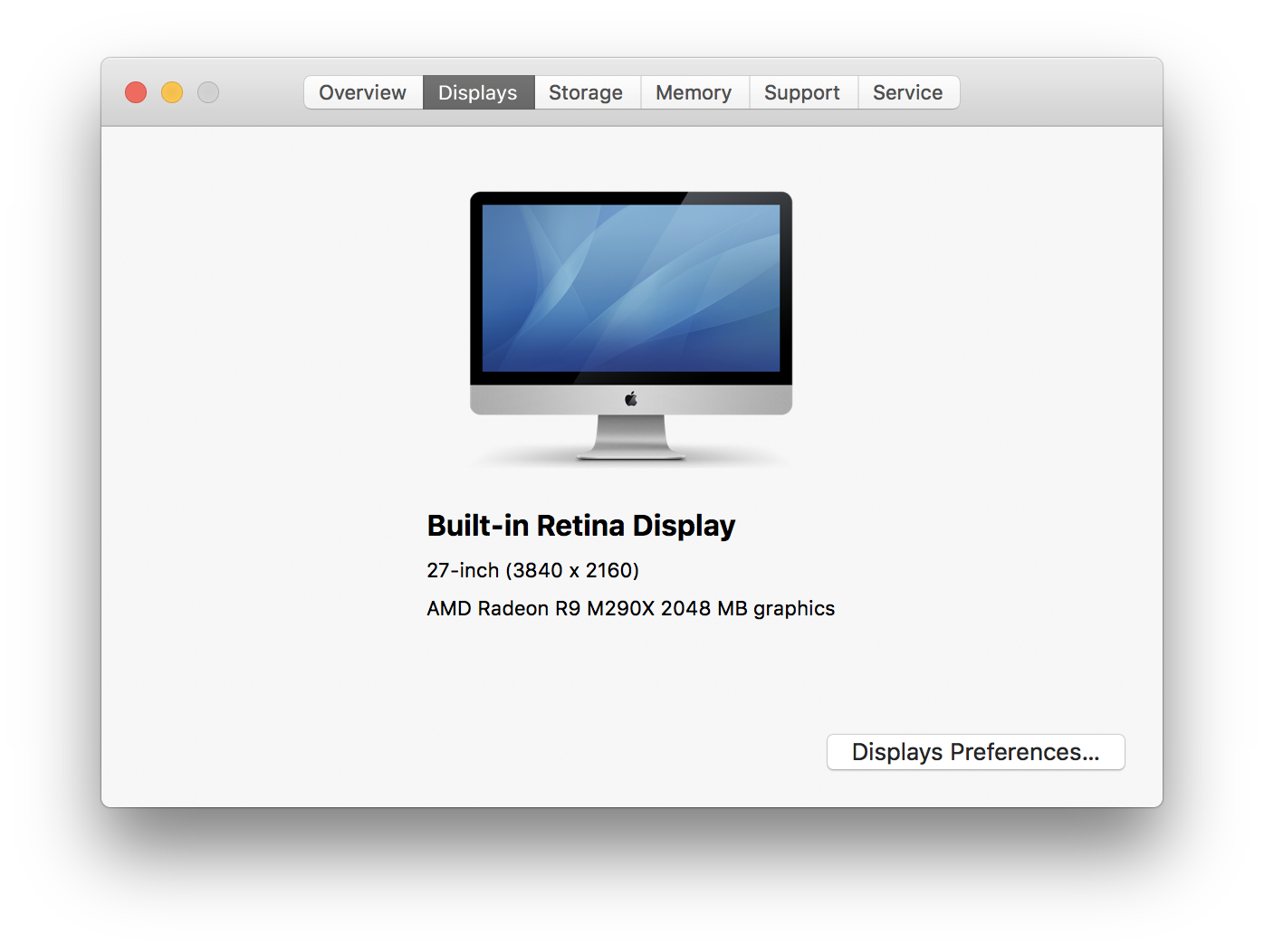

I've attached it and its working but 5k resolution isn't available and when i click on the Displays setting in 'About this mac' it says that its 3840x2160.

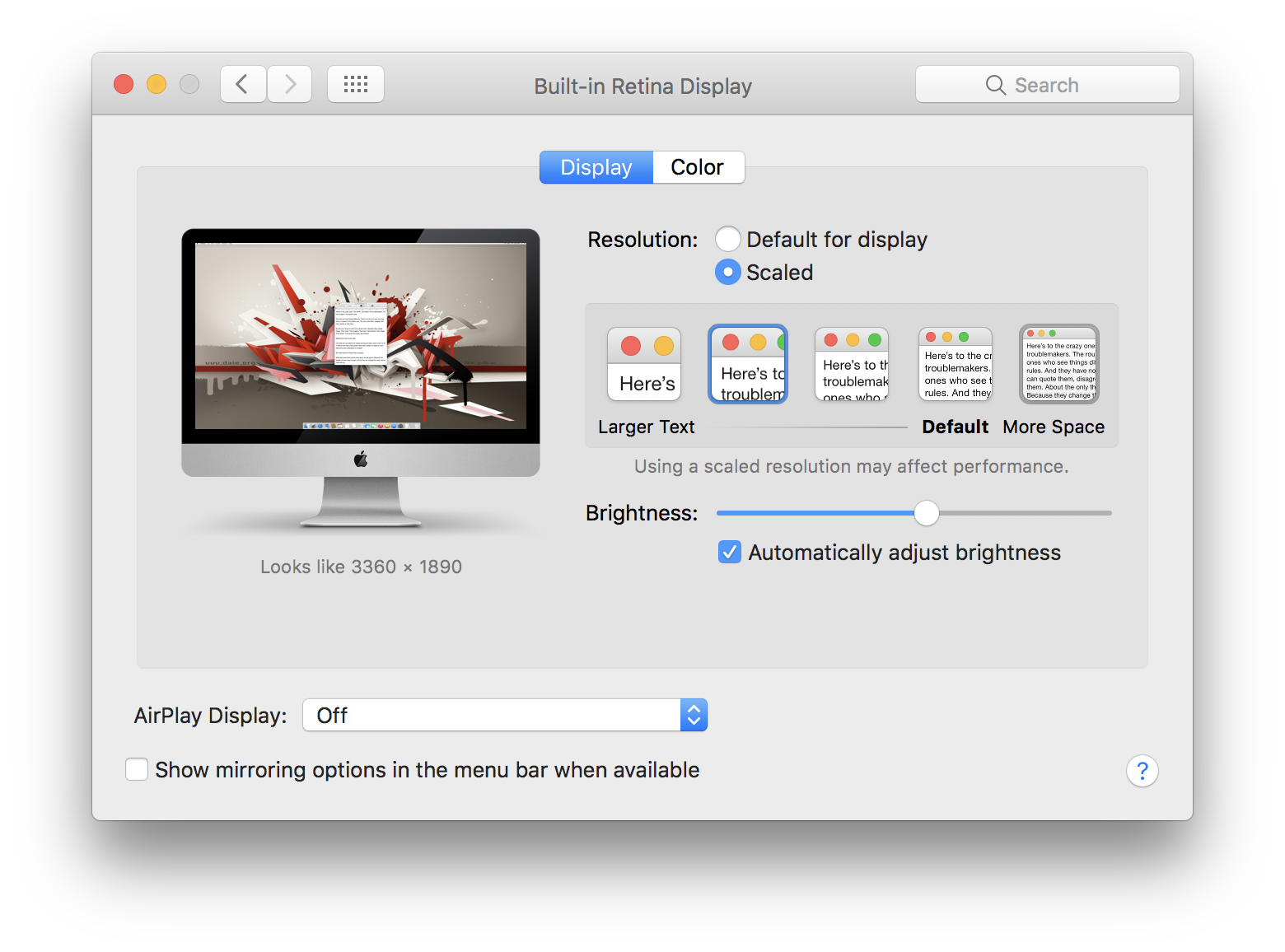

However when i go to resolution settings the max available one is 3360x1890 and that my default resolution looks like 1080p.

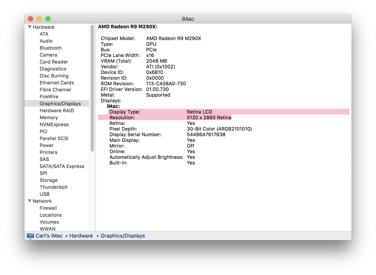

However when i go to the system information screen it says its a 5k display...

Yes that obviously gives me a crazy small resolution which it says 'looks like 3360x1890'... its not so much that i want to run these crazy resolutions... i just want to make sure i've purchased the correct replacement screen !

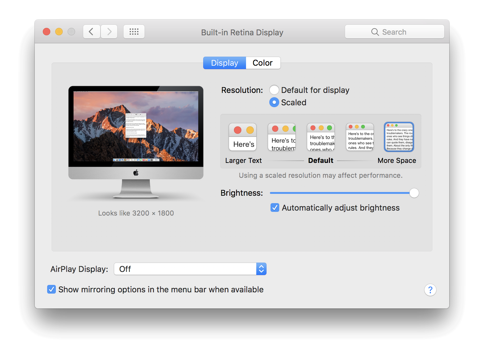

The max scaled resolution on the 5k iMac "looks like" 3200 x 1800.
See this is what is so confusing to me, mine is 3360x1890.
Also when i click the 'default for display' button it switches to a res which 'looks like 1920x1080' but when i click the default button in the scaling it uses a resolution which 'looks like 3080x1692'
utterly confusing, something is clearly muddled up.

The weirdest thing is that if i click the 'default' scaling tile in that screen it shows a resolution that 'looks like 3008x1692'
I have the option to use 2560x1440 though... but its the middle scaling option and not listed as default. It looks correct though.

It clearly says in the system information screen that the display is 5120x2880... so it must be the correct screen ?

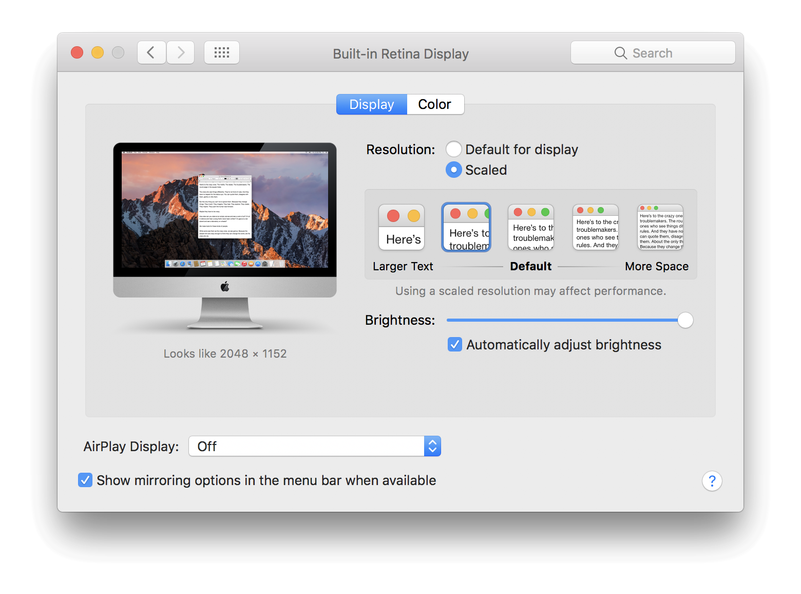

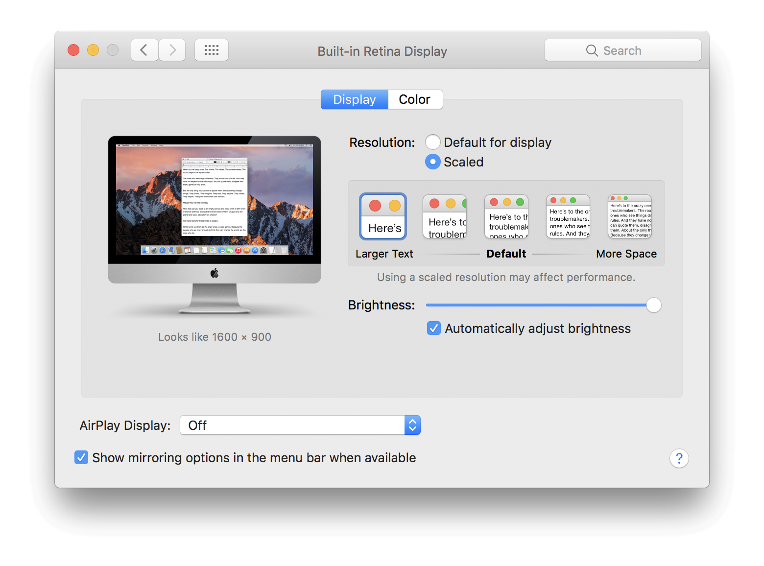

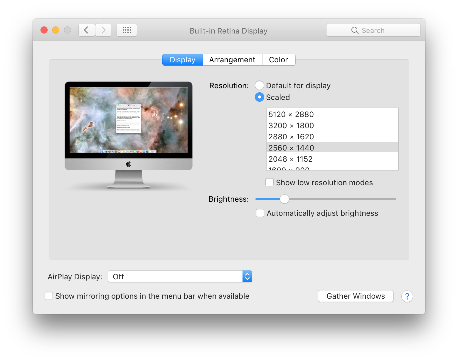

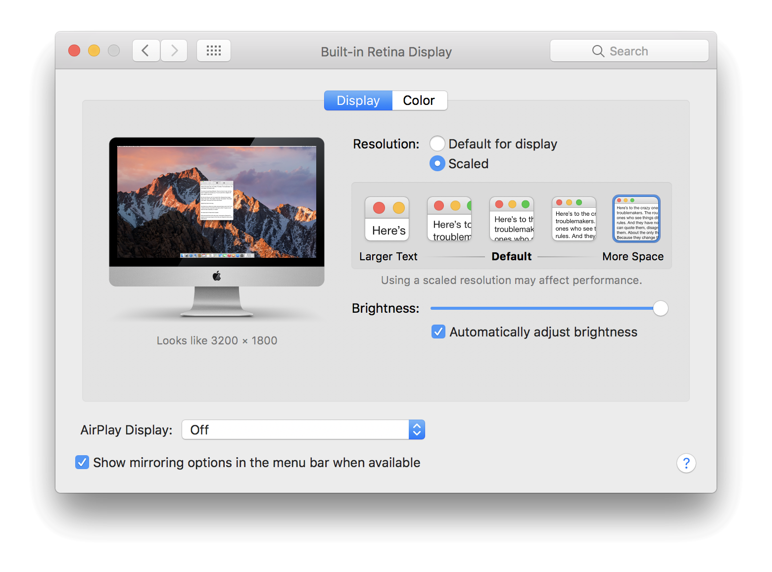

Here are the screenshots
Thank you.
I take it the default middle one is 2560x1440 ?
This is the same as what my previous screen was like. With this other one my resolution options are different.

Hi. I have one more request if thats ok ? could you go to 'about this mac', click on 'displays' and post a screenshot of that... or tell me what it says the resolution is.

Here's what my 5K states:
About This Mac > Displays > Built-in Retina Display 27-inch ( 5120 x 2880 )
Thanks. Hmm... I'm so confused right now.
Why would mine show 3840x2160 but 5120x2880 in the system information screen.

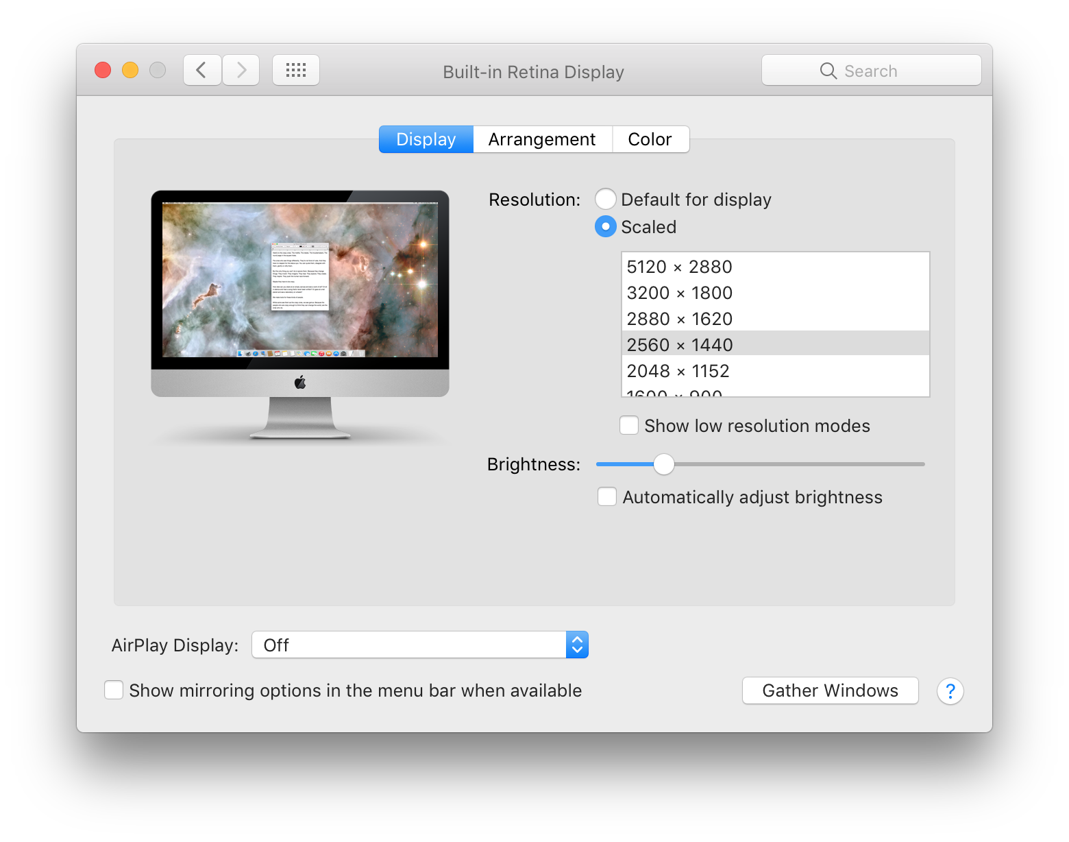

Hold down the option key while clicking on the "Scaled" radio button.
I usually leave it at 2560x1440 but the native resolution is occasionally very useful for browsing digital archives*-- as well as certain older games.
*for instance, the new yorker archives are legible as two page spreads-- if you boost the resolution, and have sufficient bandwidth.
Hi. Thank you for taking the time to repond.
I am aware of this shortcut however the issue is that my native resolution should be 2560x1440 but it is instead listed as 1920x1080. 2560x1440 is now a scaled resolution whereas on the previous screen it was the native resolution.
Looking at your screenshot you do not even have 1920x1080 as a selectable resolution.
It is as if the iMac thinks its a 3840x2160 monitor for some reason, but still lists it as 5120x2880 in the system information screen.
It makes no sense whatsoever. I cannot find a single thing about this anywhere on the internet 🙁
