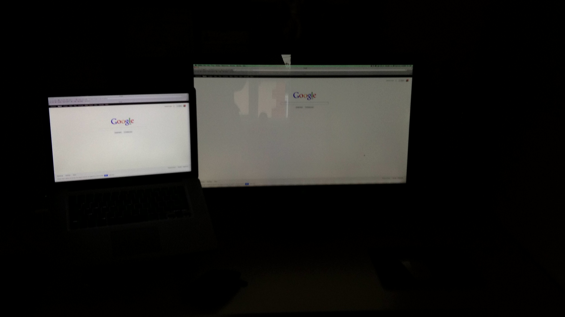

Hi,
I recently got my TBD back from Apple after they replaced the logic board. However, on Tuesday I noticed that it is very dim. It wasn't being like this last week.
I've attached a picture - both displays are on 100% brightness.
Bearing in mind that the Thunderbolt Display is actually meant to be much brighter than the MBP on paper.
Tried turning off/on - no luck. Looks like another trip to the Apple Store then!
Thought I'd quickly check with MR first though, they may have some pearls of wisdom I have missed out on 😛
Thanks.

I have 3 possible issues you may be experiencing here.
When they put your display back together, they might not have correctly aligned the ambient light sensor. Not sure where the sensor is located on your display - on my old iMac it's a small "eye" on the bottom. I'd guess it's near your camera on the current displays. Anyhow they tend to use a foam tape around the sensor - so light coming from inside your display - does not shine into the sensor. It's easy for this foam tape to roll over the sensor / block it when reassembled. So your display thinks the room is always dark - preventing 100% brightness. Never having used a thunderbolt display - not sure if there is an option to disable the ambient light sensor or not - but if you can, and it suddenly gets brighter - you've got your cause. Alternatively, you can shine a flashlight into the sensor area directly - see if this causes a jump in intensity. (it should)
The other option - most larger displays use multiple back lights - whether LED back lit or CCFL - it's possible they failed to reconnect one of them. New displays have such good diffusers / light blenders inside - it's very difficult to detect "banding" or intensity gradients across the display. However, if you see a difference in intensity on one side vs the other - it's possible you have a LED array that's out.
Finally - it could be a firmware / board rev change - maybe Apple switched LEDs / vendors where one requires more power than the other - however if this was an Apple store - I'd genuinely hope they wouldn't miss something like this.
I'd wager the ambient light sensor.

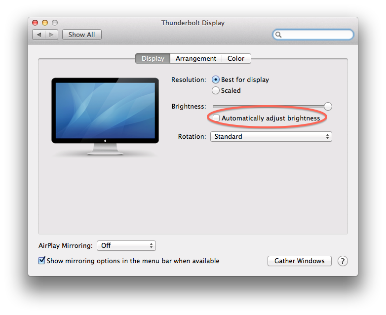

I have this box unchecked in System Preferences, and shining a torch on the camera area unfortunately yielded no change.
From what I can tell, there is no change in shade throughout the display.
Thanks though - not sure how to check for the 3rd option?!
