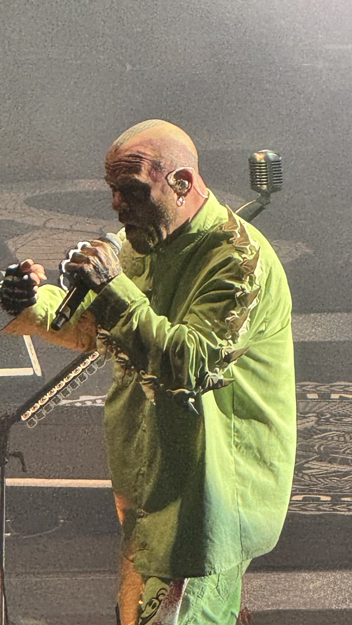

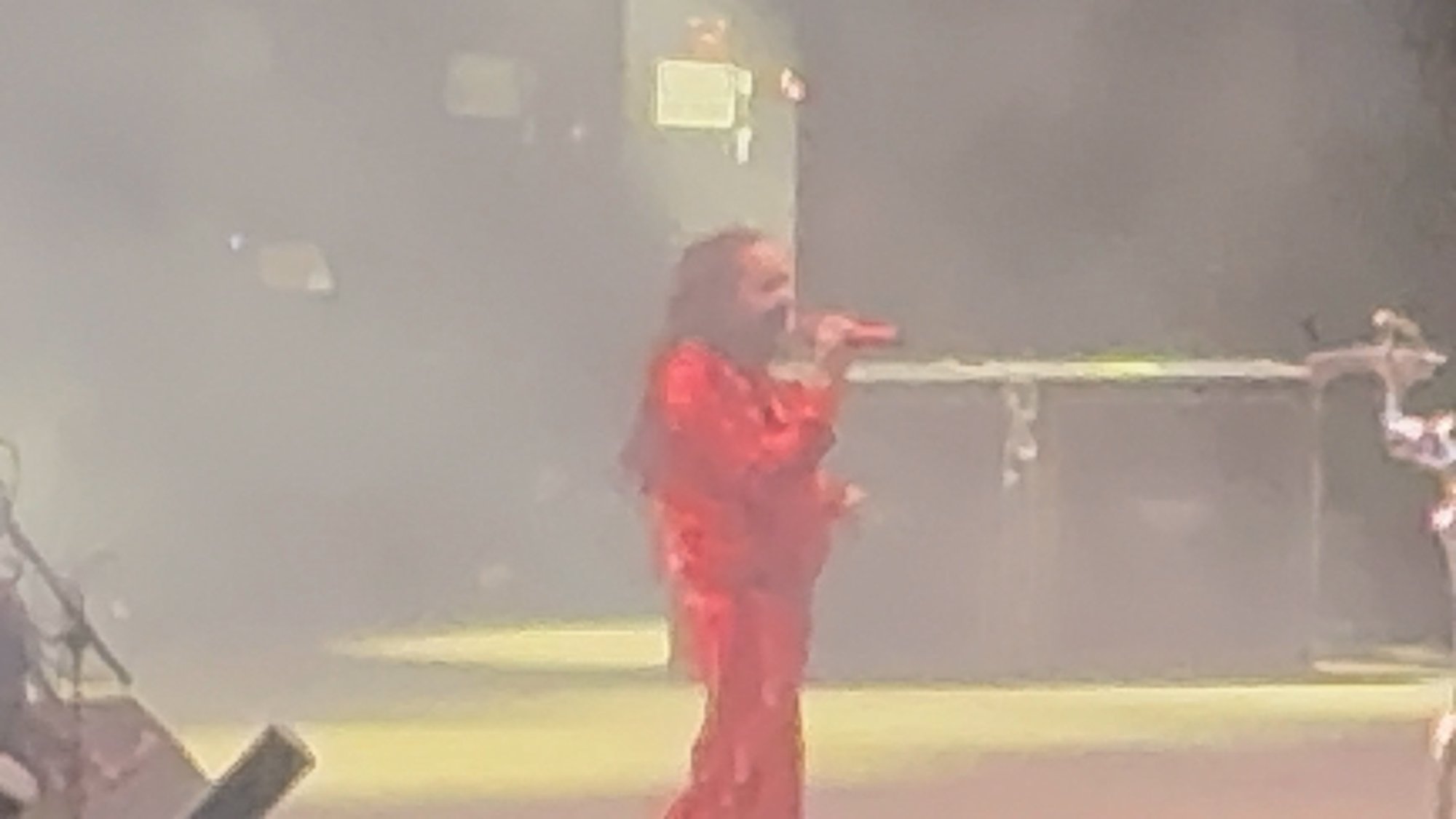

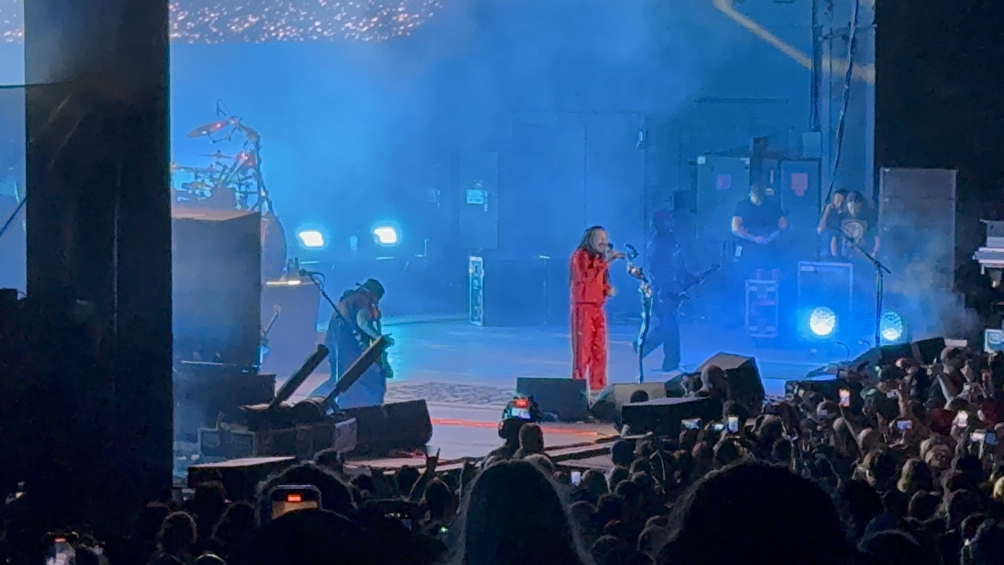

Nope 16 pro max
It was the 5x telephoto I didn’t digital zoom in
If the scene was too dark for the 5X camera, can you swipe up on the photo and check the information and see if it was taken with the 120 mm or if it was digitally zoomed in on the 1 X camera to make it look like the 5X due to low light. That has actually happened to me before I believe and if I use night mode with the 5X and there’s motion, it’ll look bad as well.

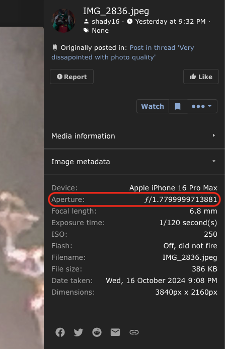

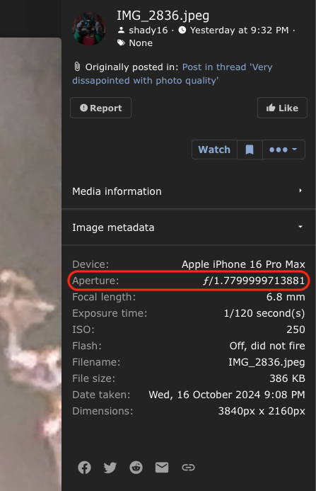

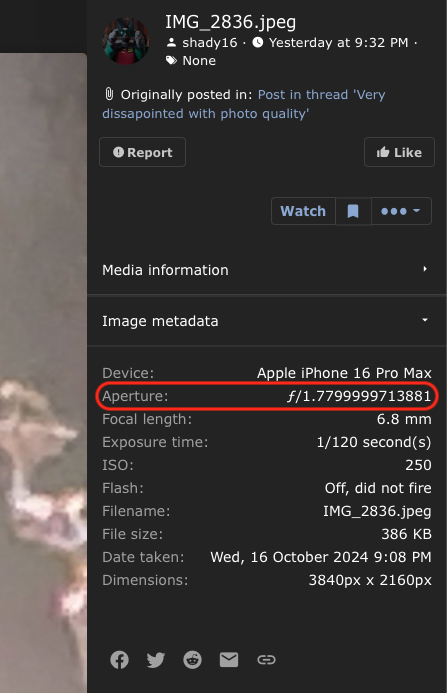

I posted in your other thread earlier and explained what probably happened. These photos were captured using the 1x main camera based on the ƒ/1.78 aperture shown in the metadata on this site.
If it was taken using the 5x telephoto camera, I would have expected to see ƒ/2.8 as the aperture (as seen with the photos you included from the 15PM in your other thread). Since it used the main camera and you zoomed in, it ended up being a digital zoom, likely due to the low light conditions. Just because you tap 5x in the camera app, it does not mean or guarantee it's going to capture the photo using the telephoto lens. You can double check by tapping the 'i' button on the photo in the Photos app. It'll show which camera/lens was used.
Yeah, that’s exactly what it looked like to me. In this case you have to use a third-party app so you can hard select the camera you want to use without the iPhone automatically switching on you due to lighting conditions, etc. I recommend Halide, ProCamera by Moment or ProCamera. I really like the moment at myself because of the superior manual, focus and focus peeking capabilities of that app. ProCam is a good one also. Thanks for the info, photos do look pretty crappy when the 1x camera takes place of the 5x. The 5x how’s a minimum focus distance of 53 inches, if you get closer than this, then the same thing will take place the 1X camera will take over because you’re too close. The 1x camera has a minimum focus distance of 8 inches. Any closer than that then the macro control takes over unless you have that turned off.

Also did you ever confirm which aperture those 16PM photos were using?

What focal length (in mm) does it say these were taken at when you swipe up on them in the Photos app?
He shared that with me earlier, it was taken with the 1x camera f/1.78 24mm. The iPhone switched cameras on him. He probably got the phone close to something and it tried to focus on a close object and switched.
