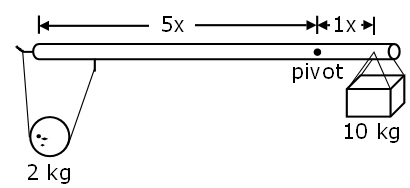

The 24" iMac weighs around 11.5 kg or 25.4 lbs., that is a lot of weight to distribute over 3 m, which would require another 35 kg to put on a 1 m arm on the other side of the pivot. If that other arm would even be shorter, like 50 cm, you would need 70 kg and so on.

Found this to illustrate my above point:
