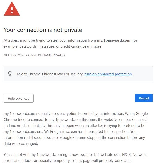

So all of a sudden, at work, I go to add a new item in 1Password at my.1password.com, and I get the following error message (in Chrome):
So after much testing and long story short, it turns out that I am unable to connect to my.1password.com on Chrome (desktop or iOS), Edge, Safari (desktop or iOS), or Firefox iOS when connected to the local network. Every one of those browsers gives a similar error message to the one above. ONLY Firefox desktop for macOS or Windows will connect to the website. If I turn off wi-fi on my iPhone or tether to my iPhone, EVERY browser is able to connect, so it's obviously something within our network that's the issue. And I have no issues connecting to the website on my home network.
I contacted our network admin, and he is just as confused as I am why this would be happening. He said he's made no changes to our network at all. So before I call our ISP and go through all that rigmarole, I was hoping some knowledgeable person here might know of something in our network that I could play with to see if it fixes the issue.
Other important notes:
  • This happens even if I turn off "safe browsing" in Chrome desktop.
  • my.1password.com is the ONLY website I am unable to access on our network so far - I have had no issues with dozens of other websites that I regularly go to
  • I’ve tried clearing all browsing data and even re-installing Chrome.

Likely not an ISP or network issue, since you can reach the site using Firefox. You should focus on the error message you are receiving:
NET::ERR_CERT_COMMON_NAME_INVALID
This seems to be a fairly common problem with Chrome, and causes can be anything from interference from certain extensions to out-of-date SSL caches. There are a number of helpful troubleshooting guides...see for example, here:

Except I CAN reach the site using Chrome once I disconnect from the office LAN or WAN and use my cellular data or connect to my home network, so the network is definitely at least part of the problem.
Also, unlike pictured in the article you linked to, I am given no option to "proceed" to the website.

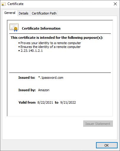

Did you inspect the certificate? The ERR_CERT_COMMON_NAME_INVALID result means, superficially, that the name of the website embedded in the certificate (in this case, should be *.1password.com) doesn't match what Chrome thinks you typed into the address bar. Chrome apparently no longer uses the Common Name (CN) field for this, so make sure the Subject Alternative Name (SAN) field is correct (should say DNS Name=*.1password.com, DNS Name=1password.com). Check the Certification Path also for anything that looks weird.

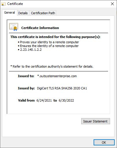

Well guess what? I have just been using Firefox and hadn't tried Chrome again for 1Password for a few weeks. I just tried in Chrome and it is now working again! I had actually contacted 1Password about this issue back in August, and apparently both I and the 1Password employees reading the thread missed that the certificate showed the wrong domain (EDIT: I just re-read the thread, and an employee DID mention it, but I missed it)!
This is what the Certificate said back in August:
This is what it says now:
I wonder how on earth that mixup happened?! And why on earth was Chrome only warning me when I was on LAN or Wi-Fi at work but not on cellular data or on another network? So strange...
Glad to hear it is resolved. outsystemsenterprise.com is apparently some sort of enterprise SaaS provider, so I suspect a misconfigured proxy server on your corporate network was to blame, and perhaps the bad certificate was cached somewhere, which is why it took a while to clear out. Why did this not affect Firefox? Who knows? Perhaps Firefox handles certificates differently...but I'm getting out of my depth here. If this should come up again, here is some info on how to clear the SSL certificate cache on various browsers.
