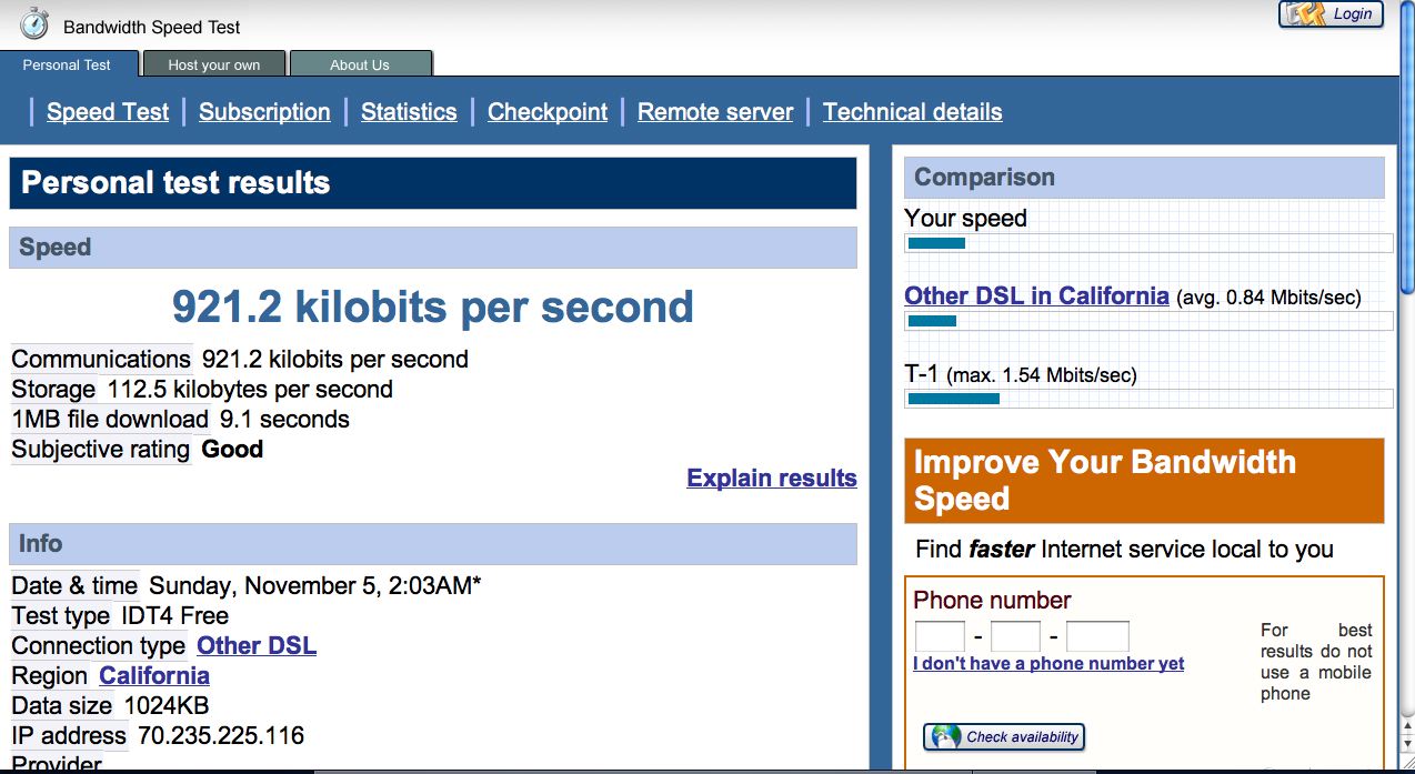

You can try this to see what it's giving you for your download speed.
haha, I just found that site a few minutes before you posted it. The first time it gave my dl speed around 750, which is what it should be. The next two times it was 350-400. But even that would be better than what I'm experiencing most of the time.
That's a huge fluxuation. My connection speed with SBC DSL is around 900KBPS.

FWIW, it's been better since I posted this thread. I saw dl speeds up to 100 kbps today, so that's a whole lot better than 11 kbps. 🙄
