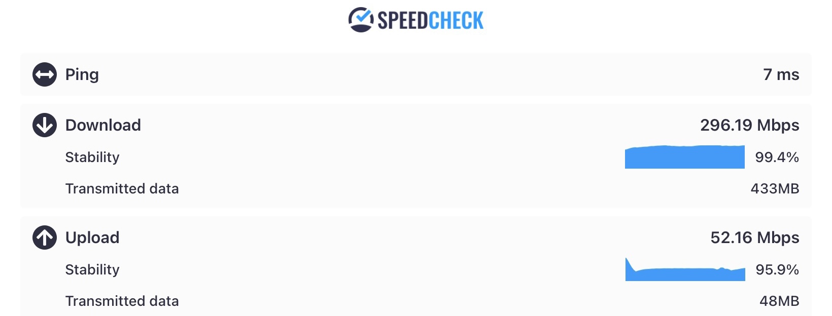

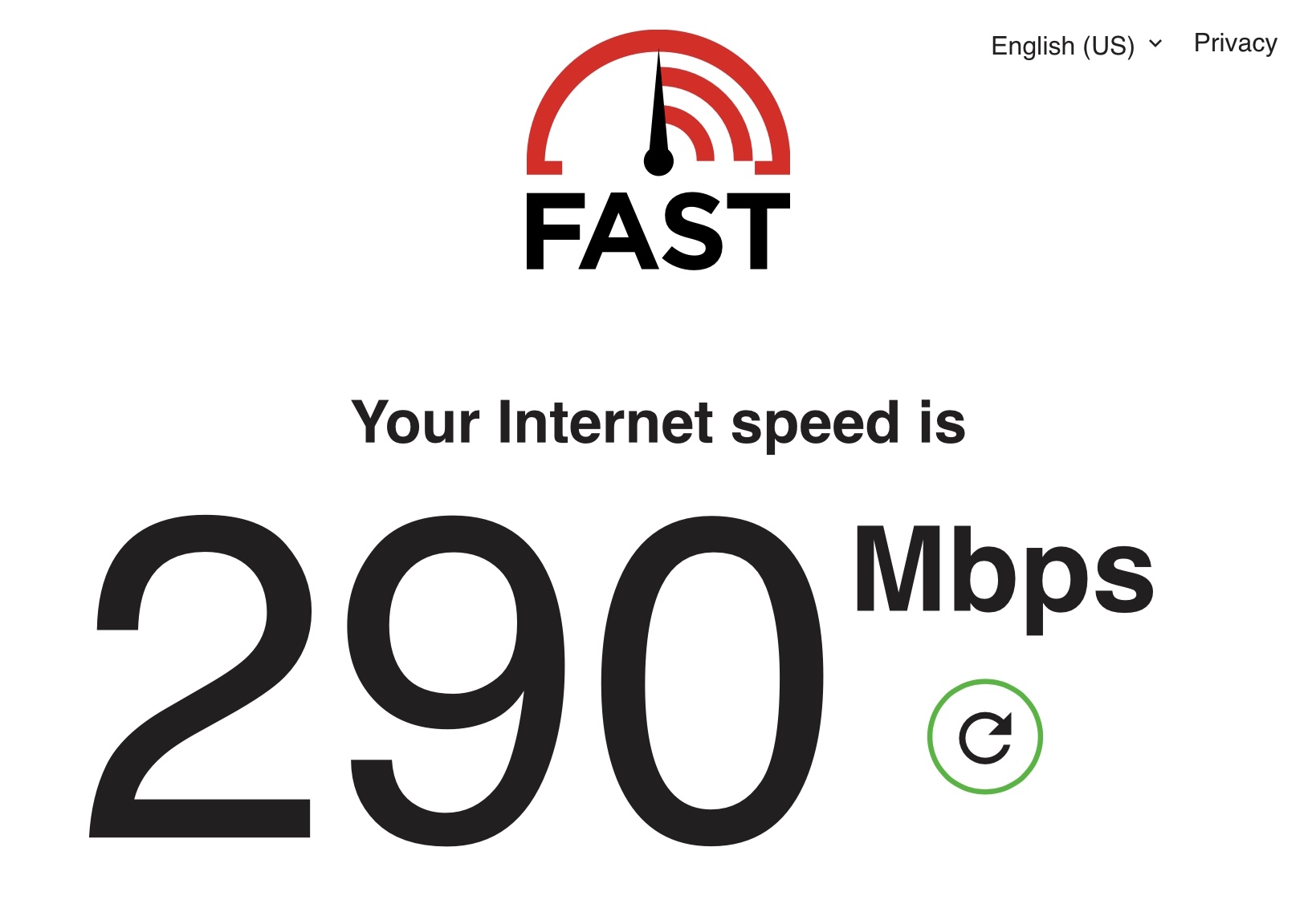

Can you post a pic of the speedtest?

Ok, so, is that off the iPad, or another device/pc? Is your connection symmetrical? 300 up and down?
iPad, 300/50 unfortunately but I’m curious why you think my internet connection being symmetrical would matter?
The reason I brought it up is just that the local lan file copy is 1/5 the speed of grabbing from online. I can retrieve cloud data faster than grabbing it from a computer or appliance in the house, by a significant margin.
