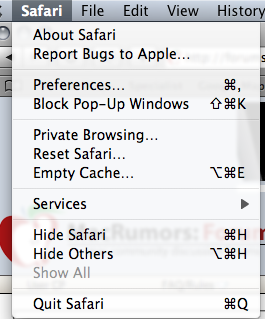

Give this a try:
Reset Safari...
Empty Cache
And erase all the cookies and clear the History.

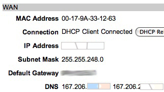

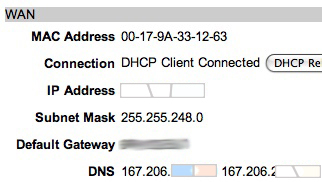

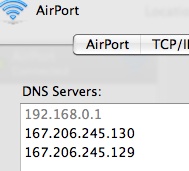

this worked for me...
in the DNS selection under the DNS tab in Network prefs, input any DNS numbers your router's stat page generates.

Hi guys - i've done what you've recommend and i have to say that the DNS address input seems to have worked. I'll keep you updated on the progress on how i get along during the day.
Thanks for your help
thank you!!
the dns address input worked for me as well 🙂🙂🙂🙂 my internet is back to its wonderful full speed self <3 <3 🙂))
