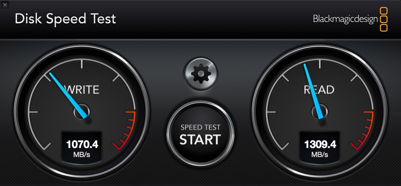

Out of curiosity, I just tried Blackmagic on my 2017 with a NVMe SSD with 10.12 (so HFS+)...
Quit it and opened it a second time....went to about 300.

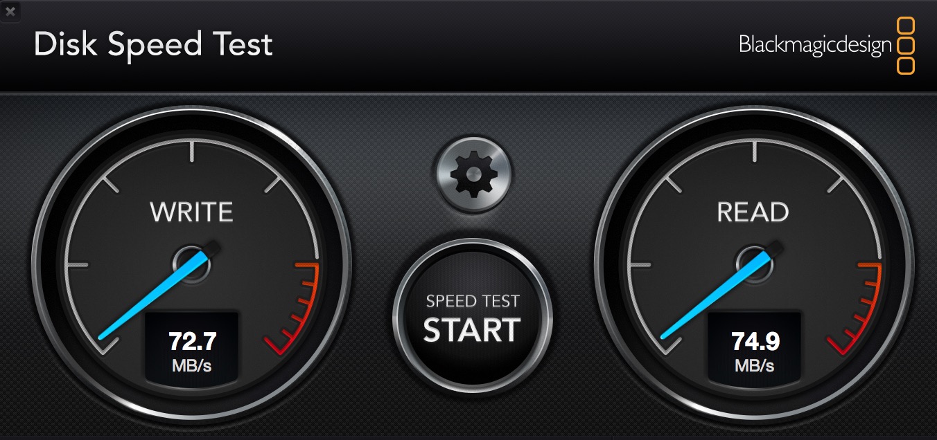

Did it again and got this...
Must be the App...
