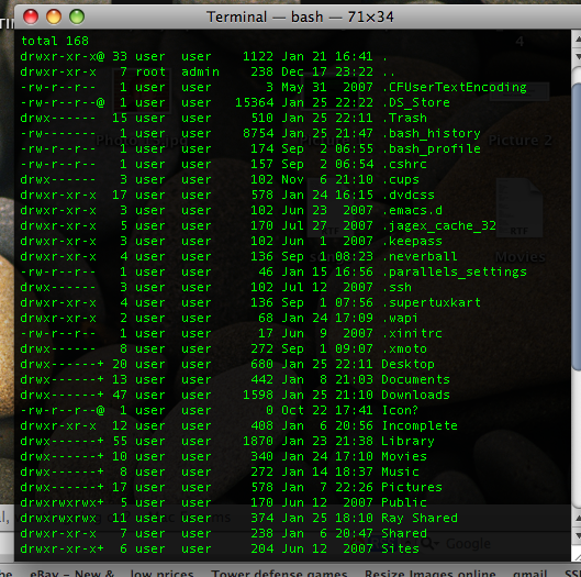

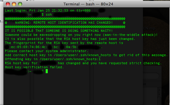

i was trying to connect to a friends computer through shh just to mess around. (he was sitting beside me) i typed in shh and his stuff and this crazy message came up.
i also notice that netinfo manager is gone?? anybody know what this means?

I've had it before, is it the message you get when connected to certain networks? That's when mine started to appear. Since then, I have reinstalled Tiger So I wouldn't be able to look into it.

The . at the beginnng of the directory name means its hidden from normal view. The directory is there from the picture you posted. If you type in:
cd /Users/yourusername/.ssh
It will move you to that directory. Then type this to get a list of files currently in the directory:
ls ./
If you see that known_hosts is in there...then type this...
rm ./known_hosts
or
sudo rm ./known_hosts
IT IS IMPORTANT THE COMMAND ABOVE IS TYPED IN EXACTLY AS IS.
ls ./
rm ./known_hosts
or
i did it successfully, dont know what it was but its gone.
thank you
