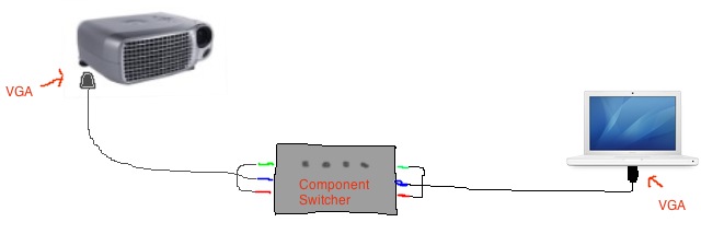

I have a DVD player and Wii running into a component video switcher. The output is a 50' component to VGA cable into a projector. I recently ordered another shorter component/VGA cable with the idea that I could attach it to my MacBook, run the cable into my switcher, and then up to the projector without having to run a whole 'nuther 50' VGA to VGA cable. I just tried it and it didn't work. Does anyone know why this is? I thought it might work since I'm starting and ending with VGA.

I think this is because a VGA-Component cable doesn't carry all the VGA signals that a computer needs. By the time it gets to the projector, it's missing some computer signals and thinks a component source is hooked up to it.

You're missing the Sync signals that the computer outputs. A computer outputs essentially 5 signals RGBHV ( Red Green Blue Horizontal Vertical ). With component the sync is usually on the green line but when dealing with a VGA signal sync is separate.
This should work since the box will take the Horizontal and Vertical sync from the computer and convert it to one port on the Component side. But you will need a cable that has 4-wires to connect it to the Component switcher but if the Component switcher does not have sync capability or the ability to redirect the sync down green (essentially a dumb switch) then it won't work. You'll need this switch if you enlarge the picture you will see that it has and H port, that is the sync.

I ended up buying another VGA-VGA cable for $20 on ebay, but now I know why it wouldn't work. Thanks for the answer.
