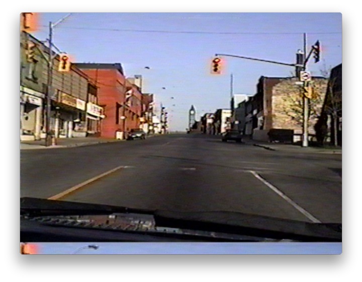

After a certain period of time, my videos look like this:
The problem increases over time. From the above image you can see clearly head switching noise (which I'm fine with) but a portion of what would be the very top of the image is now brought down to the bottom part of the video. Why is that?
If I stop the VHS playback and press play again, the problem is fixed;

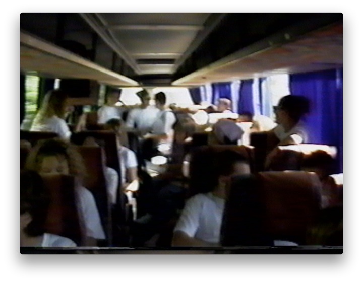

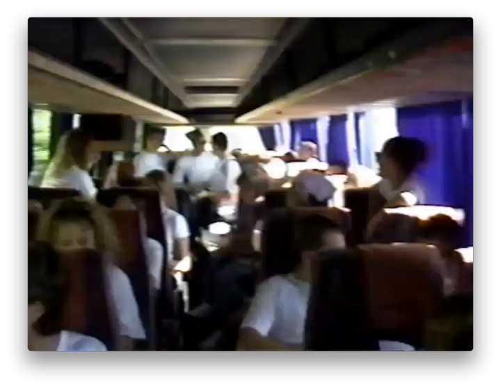

I tried using Elgato AGAIN, using the same tape and running the video for about 30 minutes and the problem does NOT seem to be as bad in elgato as it does via firewire:
Elgato:
Firewire:
But again, stopping the video and playing it again readjusts the picture and everything looks fine.

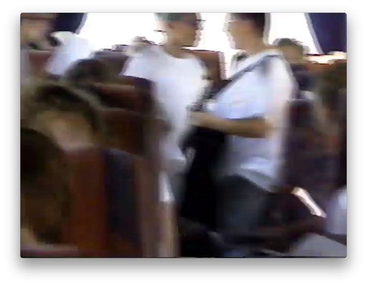

This is how bad it gets using the Dazzle DV Bridge with a Samsung DVD-V3500 VCR player and Vidi 0.4.7 from Analog/Composite to Digital/Firewire.

If you look at the position of the knee in the school bus scene, it looks like the dazzle is just capturing more of the video. The elgato is cropping the bottom of the picture more, which is hiding some of the head switching noise.
VHS has a ton of inherent picture quality issues but are hidden since most analog devices will crop the sides and top/bottom of the input to remove things like head switching noise, closed captioning data (which would show at the top of the picture), flagging at the sides, etc.
If the Dazzle has better quality, my recommendation would be to capture the video in a raw format (like DV or AIC), then use a program like Handbrake to encode that into H.264 using the picture controls to deinterlace/decomb and crop the noise from the picture.
